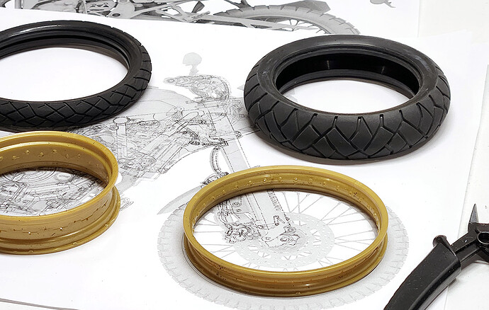

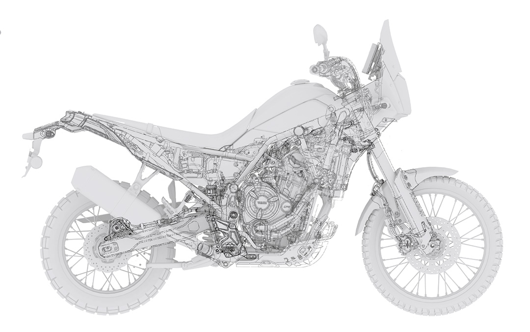

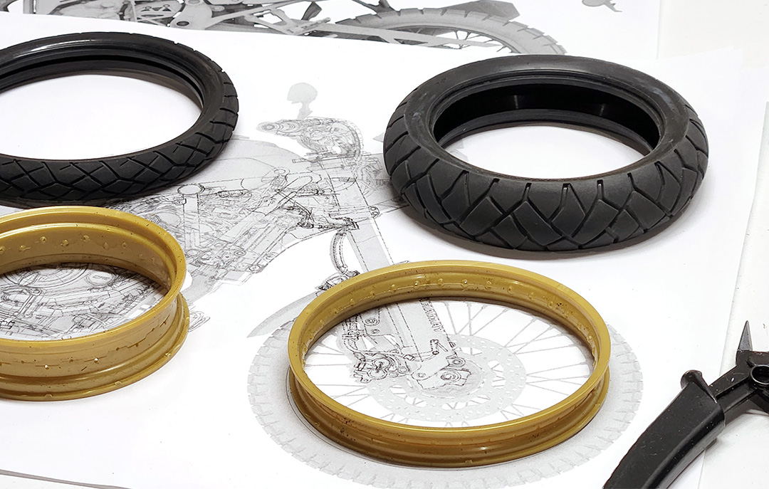

To be sure, I pieced together a bunch of drawings from the maintenance manual and overlaid them on a rendering of the model to see if major components still line up. Most importantly, the frame and suspension.
With the model checking out, I used the wheel rims from the Africa Twin model as size references, scaled the “blue prints” I had rendered, and printed them actual size. Here they are along with the rims assembled and the mold lines on the tires removed. The rim seams still need putty/sanding.

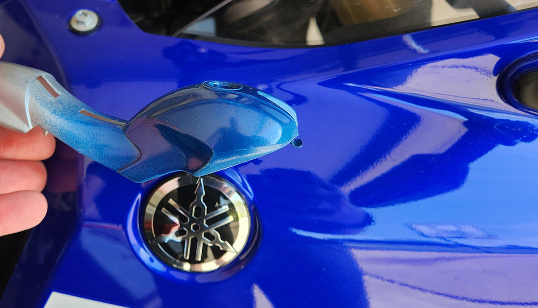

Looking for a metallic blue that matches the bike’s finish. I tried some Testors 1209T Arctic Metallic Blue, but it’s not a good match.
I think I’m going to order some Tamiya LP-45 Racing Blue, which the interwebs seems to think is a good match. Does anyone have other suggestions?

Tried Testors 1639T Custom Blue Metallic Flake too. Beautiful color, but nope, not it. LP-45 is on its way, I’ll try that next.

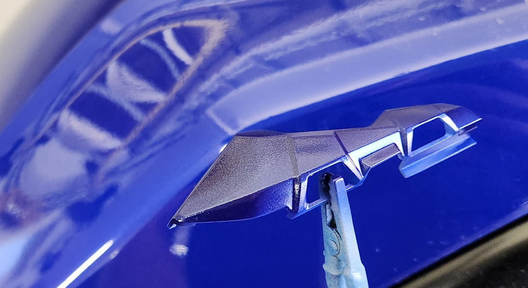

Well, the LP-45 might do in a pinch, but I think it’s too dark:
Even with a more patient and even application, I don’t think it’ll work. I’ve ordered some model-specific touch-up paint, which should work if the metallic flakes don’t throw off the scale.

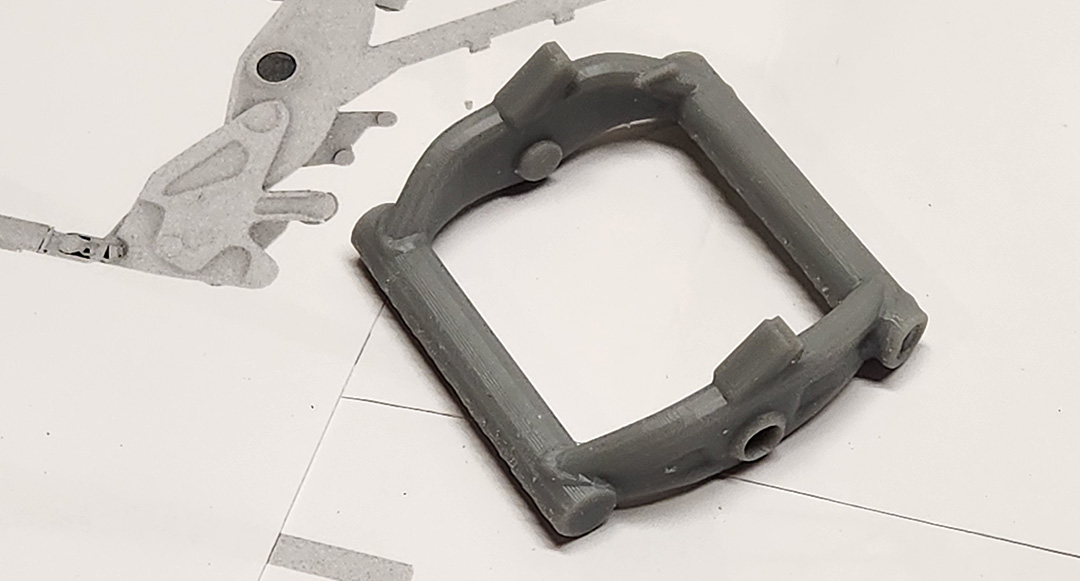

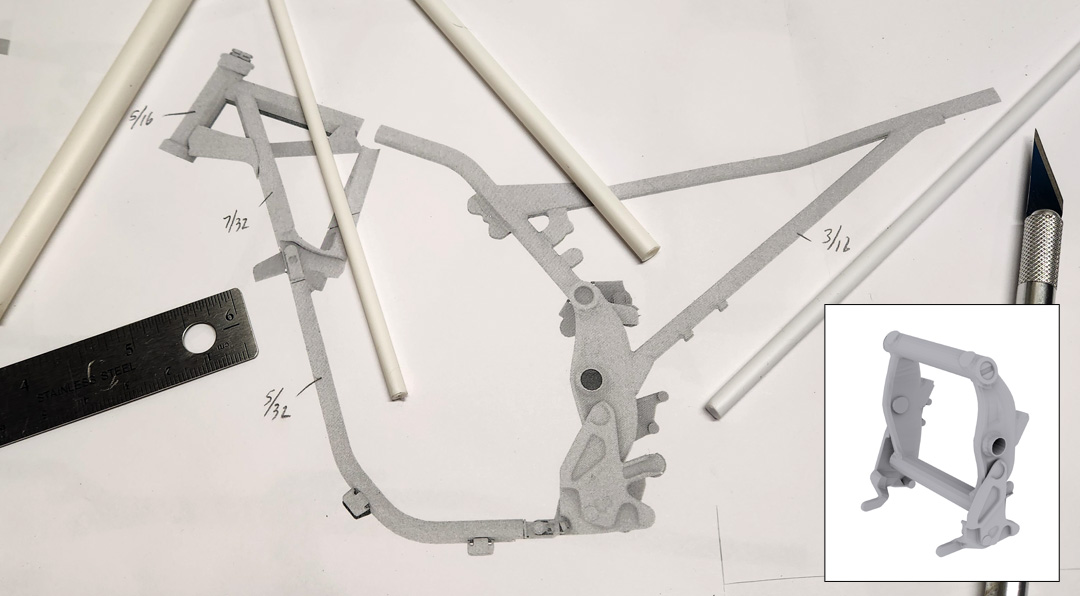

I have the frame somewhat planned out. Not trusting the durability of a bunch of resin-printed tubes, I’m going to use styrene for most of it and just 3D print some of the more complex parts.

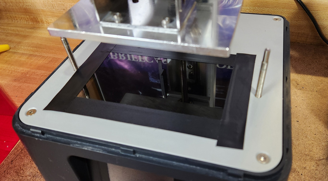

Probably pinning parts together and cementing tubes within tubes where possible to create a very sturdy frame. The entire process has been on hold for weeks while troubleshooting my printer. The new LCD that I need should be showing up tomorrow, so I’ll hopefully be printing parts soon!
New LCD installed:
Oh, Blessed Mother of Ultraviolet Light, don’t let me down!
Success!
3D printer seems to be working perfectly - game on.

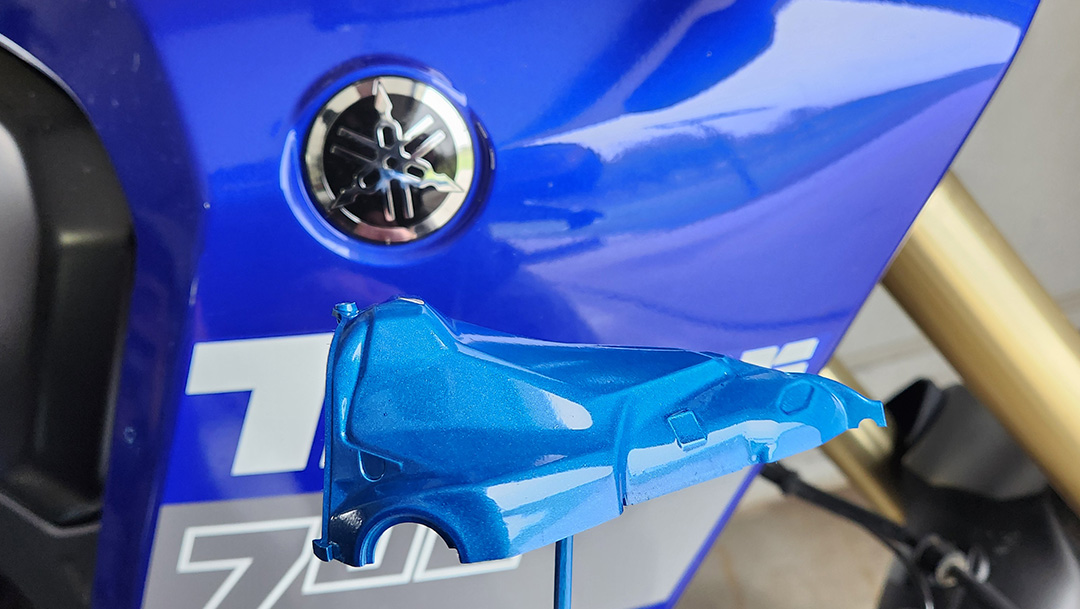

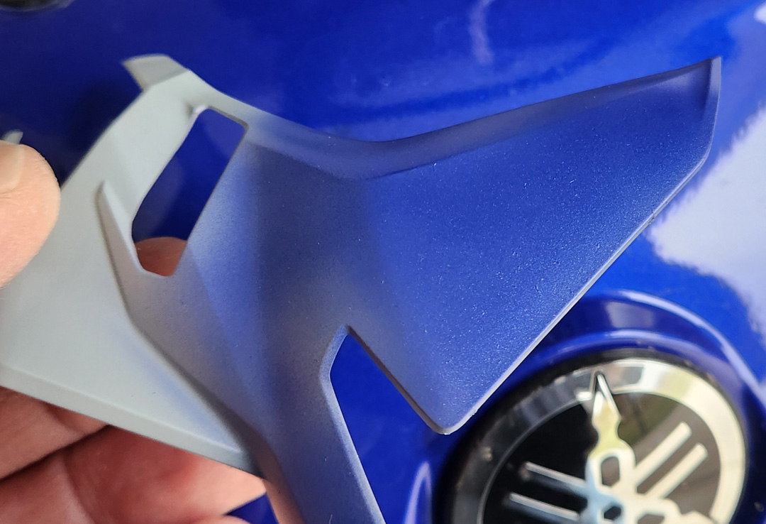

Finally back to the bench. I think we have a winner here: Found some “Yamaha Deep Purplish Blue/Team Yamaha Blue Metallic” touch-up paint. Comes in two bottles - a base grey and a metallic blue top coat. This test piece just has two thin coats of each on it. I think building it up with some additional layers and adding a gloss coat on top will do the trick!

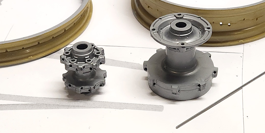

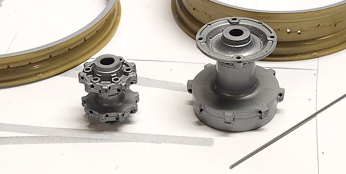

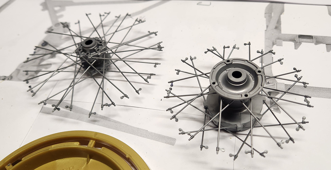

I decided to replace the plastic wheel spokes with metal rods. I’m sure once assembled the wheel would be plenty sturdy with the plastic spokes, but I think it will look more realistic with metal versions.
Once all the wheel hub parts were assembled, I cut off the spokes and drilled holes for the new metal ones. Also had to drill out the holes in the rims to open them up a bit.
Next step is to try 3D printing some spoke nipples.
