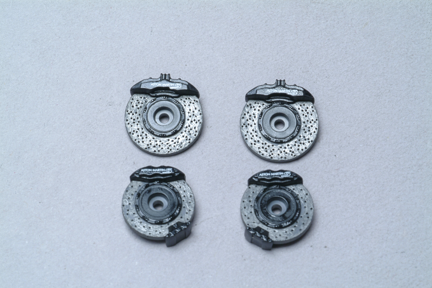

I spent a little extra time drilling out and detail painting the rotors to look more like carbon fiber.

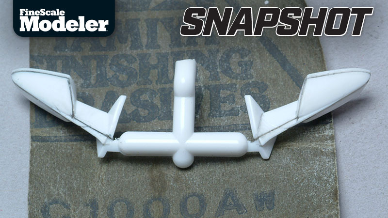

The last details to go on were the mirrors (I used the same trick on the NSX to paint them) and a custom license plate.
Here’s a link to an easy way to paint the mirrors:
