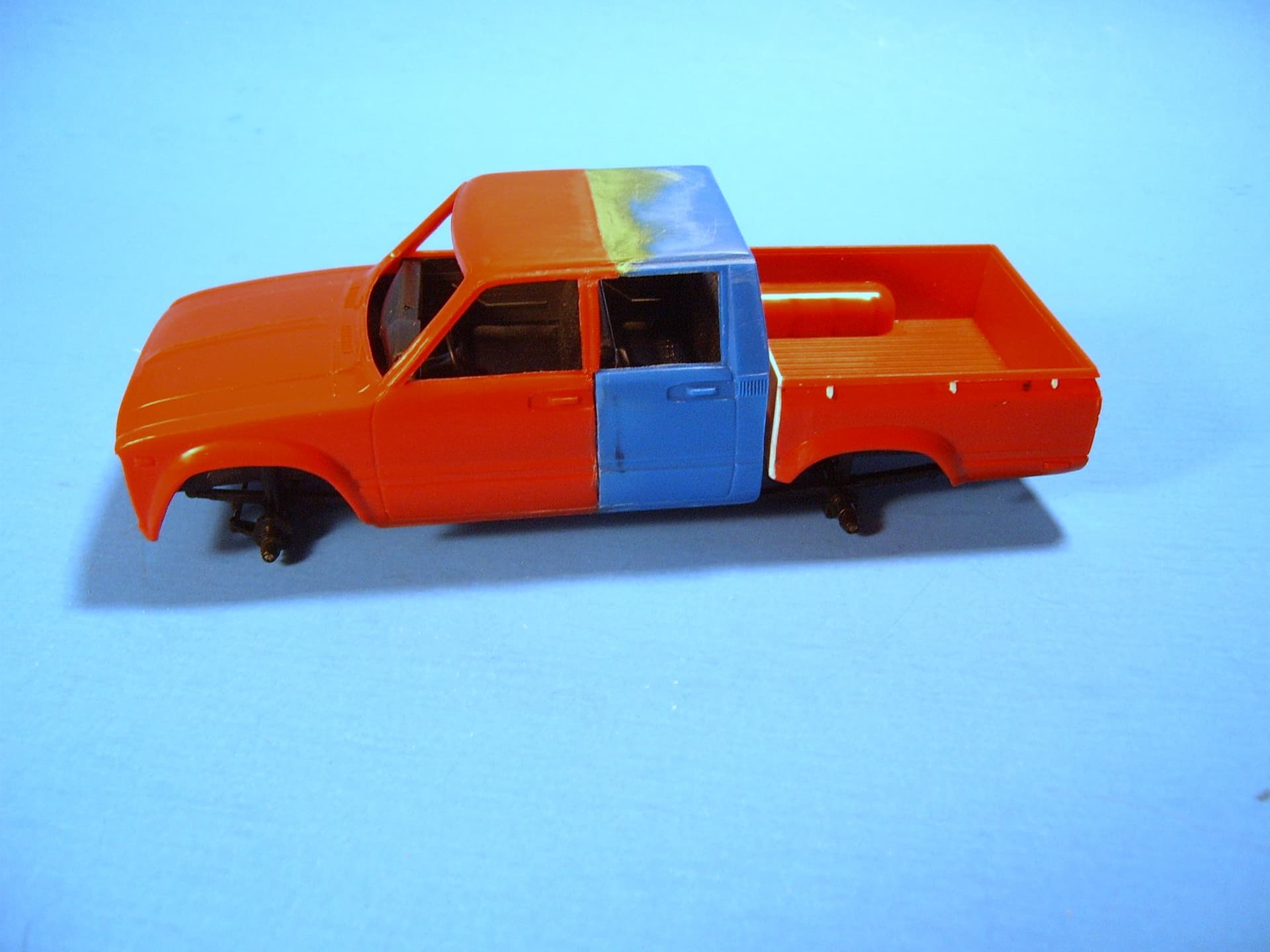

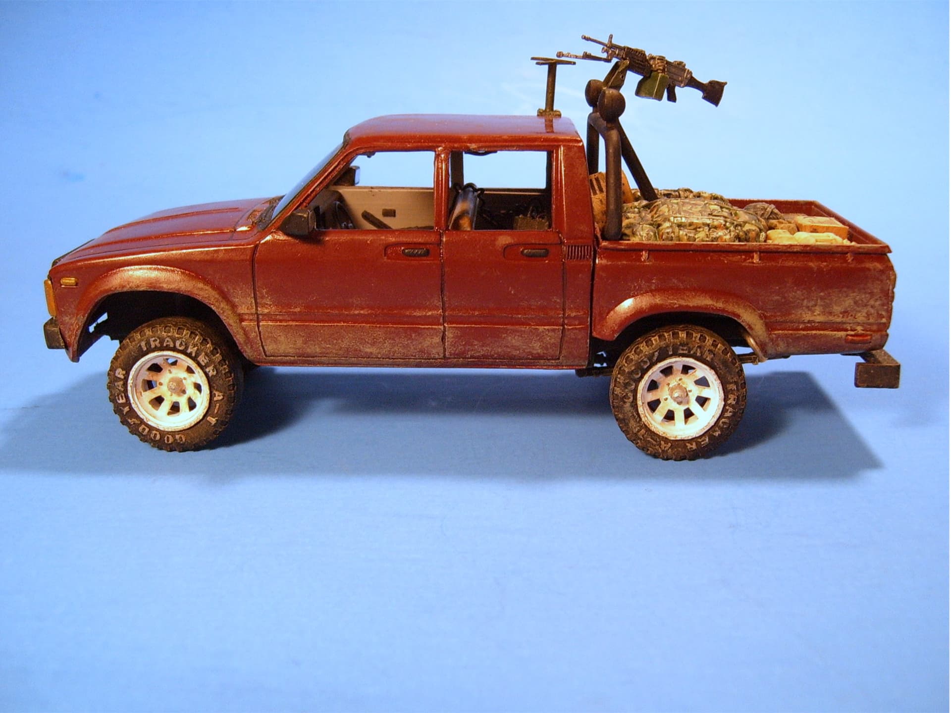

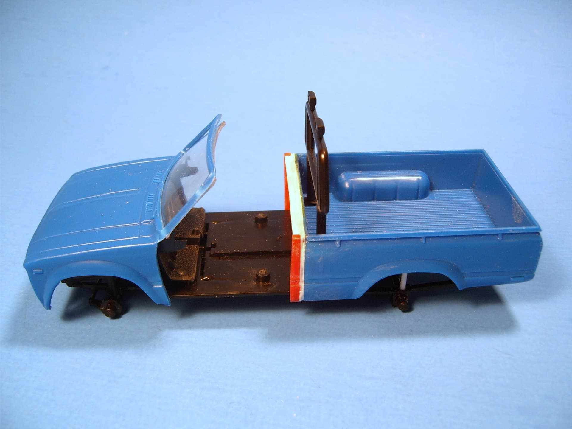

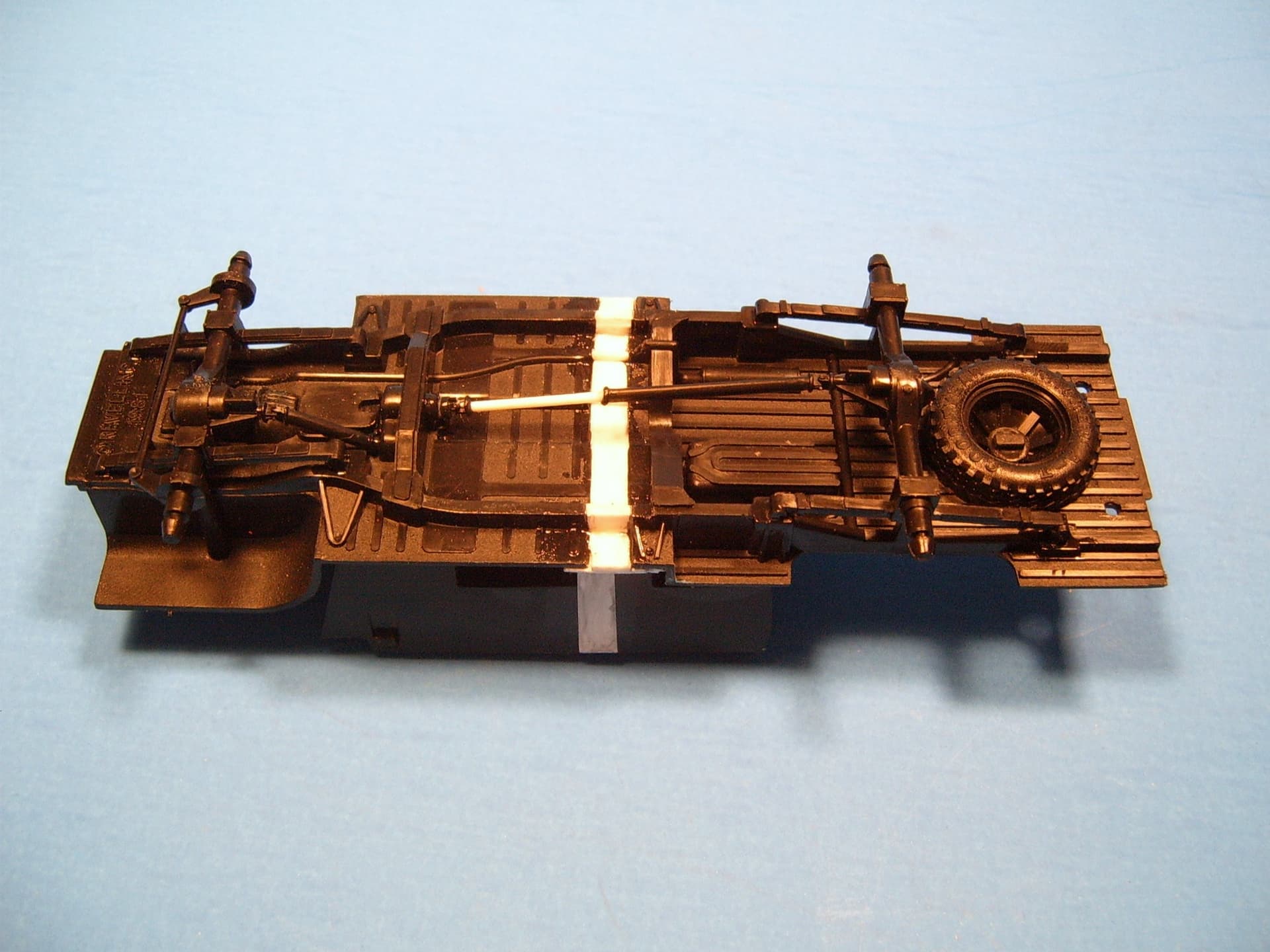

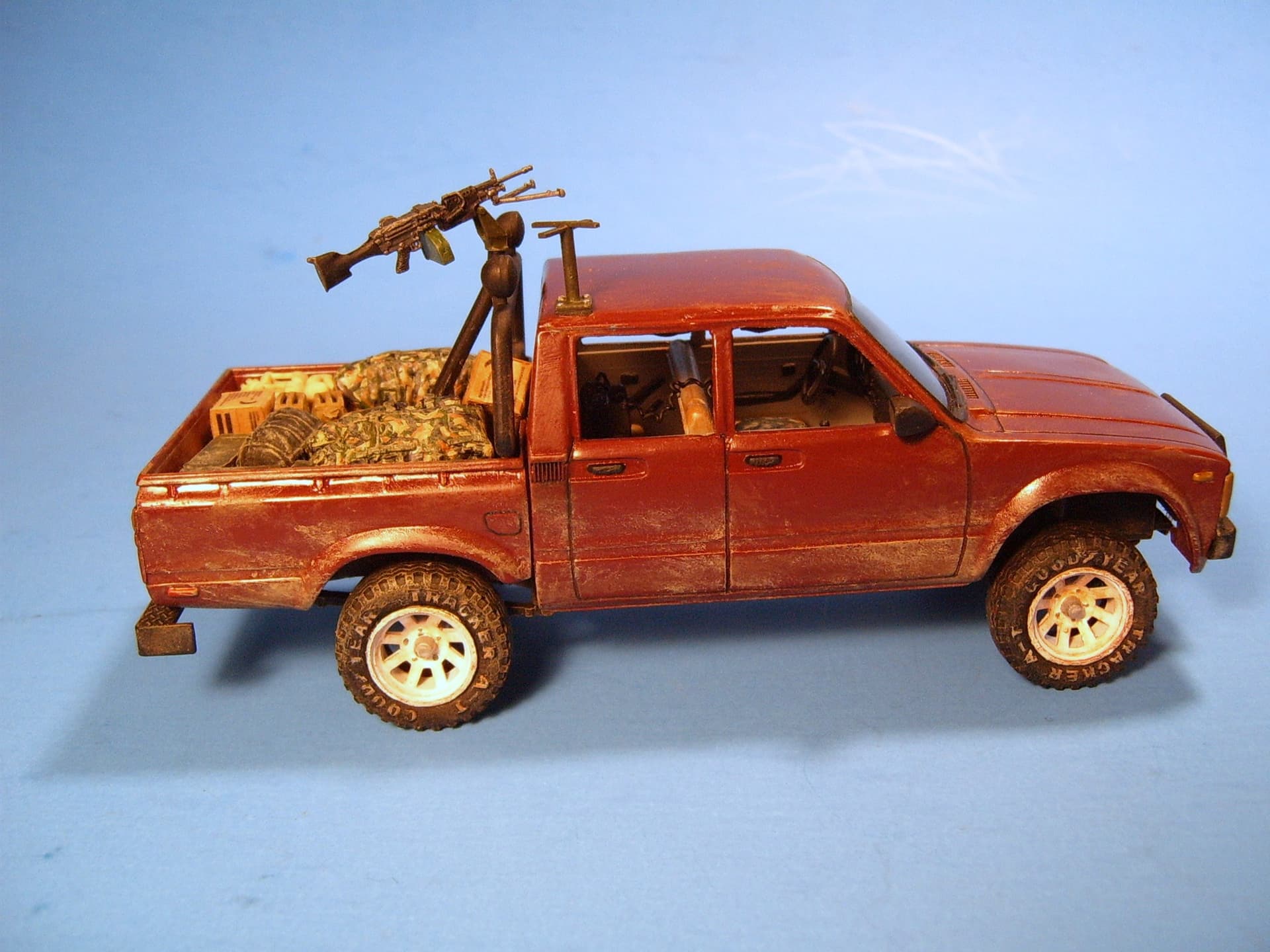

It can be done. You may need two kits though as 4-doors tend to be longer. I did it with two '80s Toyota single cab trucks to make a double cab truck. I cut the front one across the rear of the front door and the second just in front of where I wanted the rear door to be. Then I combined them together, shortened the bed, and lengthened the frame to fit.
It came out nicely in the end.
I then had a second technical from the leftover parts.

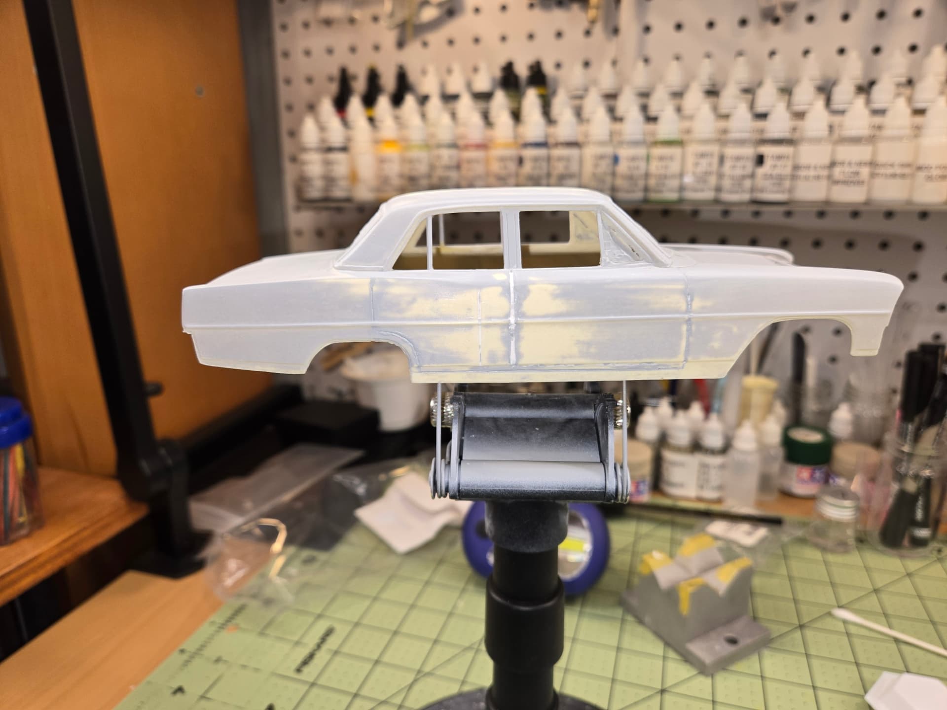

New member here.. My first car was a 1966 Chevy II 4-door, 194ci 6cyl, 3-on-the tree. I am building a model of it for a group build for my local IPMS chapter.
The only kits are AMT 2-door coupes, and the roofline is wrong, among other things. I found a cast resin 2-door post sedan body that I am using as the roofline is correct for the 4-door. So to build this, I am using 3 kits and some parts stolen from other kits:
  1. AMT 1966 Nova 2-in-1 kit for chassis and running gear
  2. 1963 Chevy II station wagon 3-in-1 kit for engine, trans, windshield/side windows and misc. parts.
  3. Mill City Replicas 1/25 1966 Nova Sedan Resin Cast Body Item ID 336147654623
  4. AMT 1968 Corvair for 13-inch steel wheels
  5. AMT 1972 Nova for late GT steering wheel (bought steering wheel on Ebay)
    Filling and re-scribing the resin body has been a real challenge, but I almost have it presentable. For the B-pillars and rear window channels, I cut them out of the station wagon body and CA glued then in place.
    My long-term plan is to build models of the cars I’ve owned. Problem is, there’s been 37 of them and a lot of them are not typically made in 1/25 scale styrene.
    Fascinated to see what you folks are doing with your 2 to 4-door conversions.
