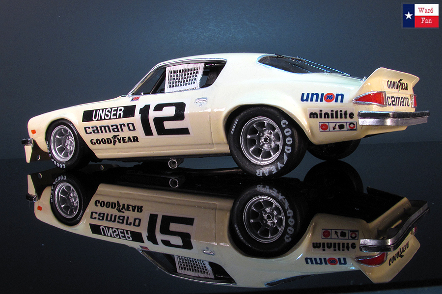

1974 IROC Camaro
Used a 1970 1/2 AMT Camaro kit to make this 1974 Camaro.

This model depicts the iroc 2 champion Bobby Unsers car. 1974 was the first year Camaro was used as the iroc car. It was basically a stock Camaro with a roll cage and a Traco 336 c.i. engine making 440 horsepower. they built 15 of them and raced 12 with 3 as reserve cars. If you google iroc 1974 you will find a lot of stuff on them. Thanks everybody for the great feedback.

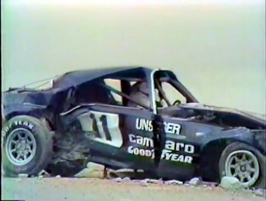

The 74 Camaro body was used until 1980. In 1977 they started using a Banjo chassis because the stock unibody chassis was not very safe if the car suffered a major crash like Bobby suffered in the first race of the 74/75 season at Riverside. Since it happened at the start of the race they decided to restart the race with him in one of the spare cars. He was unhurt in the accident as you can see was horrendous.
I forgot to mention the reason the air cleaner does not have a top on it is because the hood served as the top of the air cleaner. A shallow tunnel was made into the underside of the hood and it matched up to the air cleaner. this allowed air to enter the air cleaner from the base of the windshield which is a high pressure area. I had to scratch build the air cleaner because none come in a kit that quite look like that. Made the element too.
