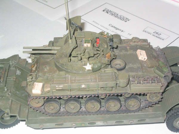

'60s OD was darker than WWII OD. Here are a few methods that I have used to replicate it.
  1. Paint overall MM OD Green FS#34087, then I give it an overall wash of black, then drybrush with the OD again. Here is how it comes out.

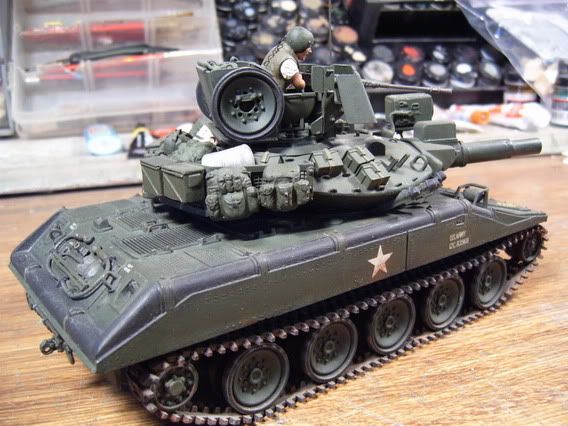

Tim, I just mixed up some of my own. I used MM OD and added flat black to it. I found the color I wanted when I got to about a 30 to 70 mix of black to OD. Made my old Tamiya M60A1 look quite like the one I trained on in 1973. Experiment a little and you’ll get the look you want.
