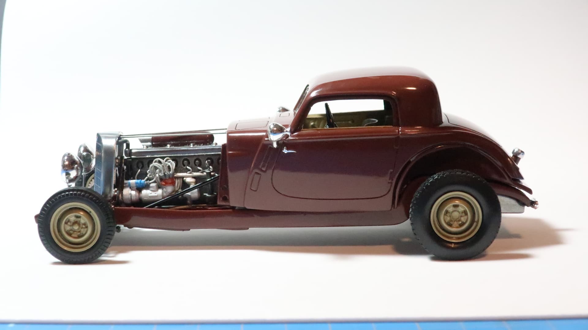

I grabbed the wheels and tires out of Revells new 29 Roadster kit. Painted the wheels BBS Gold from Splash paints. and mounted them up. Here is the rolling chassis.
And finally here is the finished hot rod.

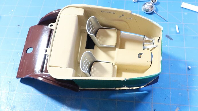

Oops. I forgot to show the interior.
I used a creme color. Blocked off the back seat. And I used some 3D printed hot rod seats.
@ctruss53 awesome job! I love your vision for the car, and the final look is amazing! The only thing missing is the backstory. Was it used by runners during prohibition? or did a rich kid wreck it and this is how the mechanic brought it back to life?
That looks awesome! As for a story, my humble submission, post war Germany early to mid 50s. Germans are still having to rebuild the country so materials are rare or hard to come by. A young man finds this pre-war benz, but doesn’t have the means or supplies to “properly” fix it. After much ingenuity this is what he makes it into.
Wicked looking roadster. Well done.
A young man working as a valet parker at the local country club stole it and hot rodded it.
