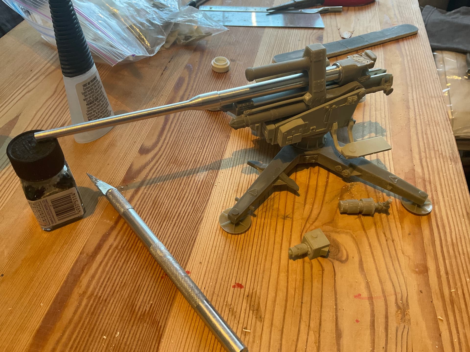

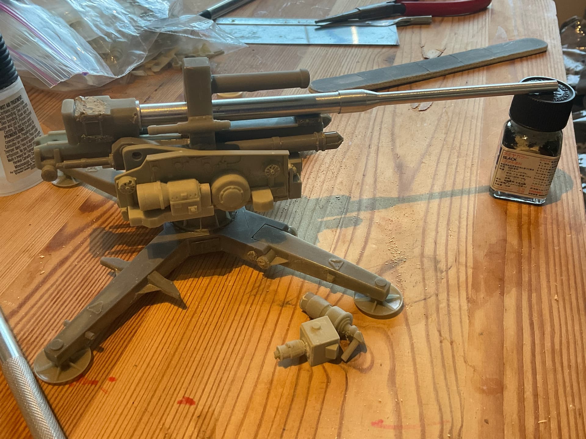

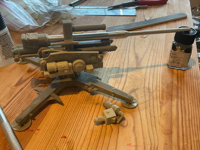

Okay, okay, I know…..don’t start new kits, finish what’s already started. The problem is that this one was started way before I had the skills or references to finish it.

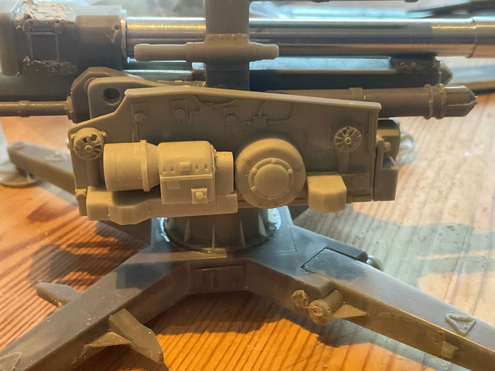

No locating pins, missing details, crude details for what’s there, basic assembly drawings, mis-molded parts and a material that is very unforgiving. What’s not to love? Oh, did I mention that it’s the only game in town for this scale?? Yup, a 105mm German anti-aircraft gun in 1/35 scale.

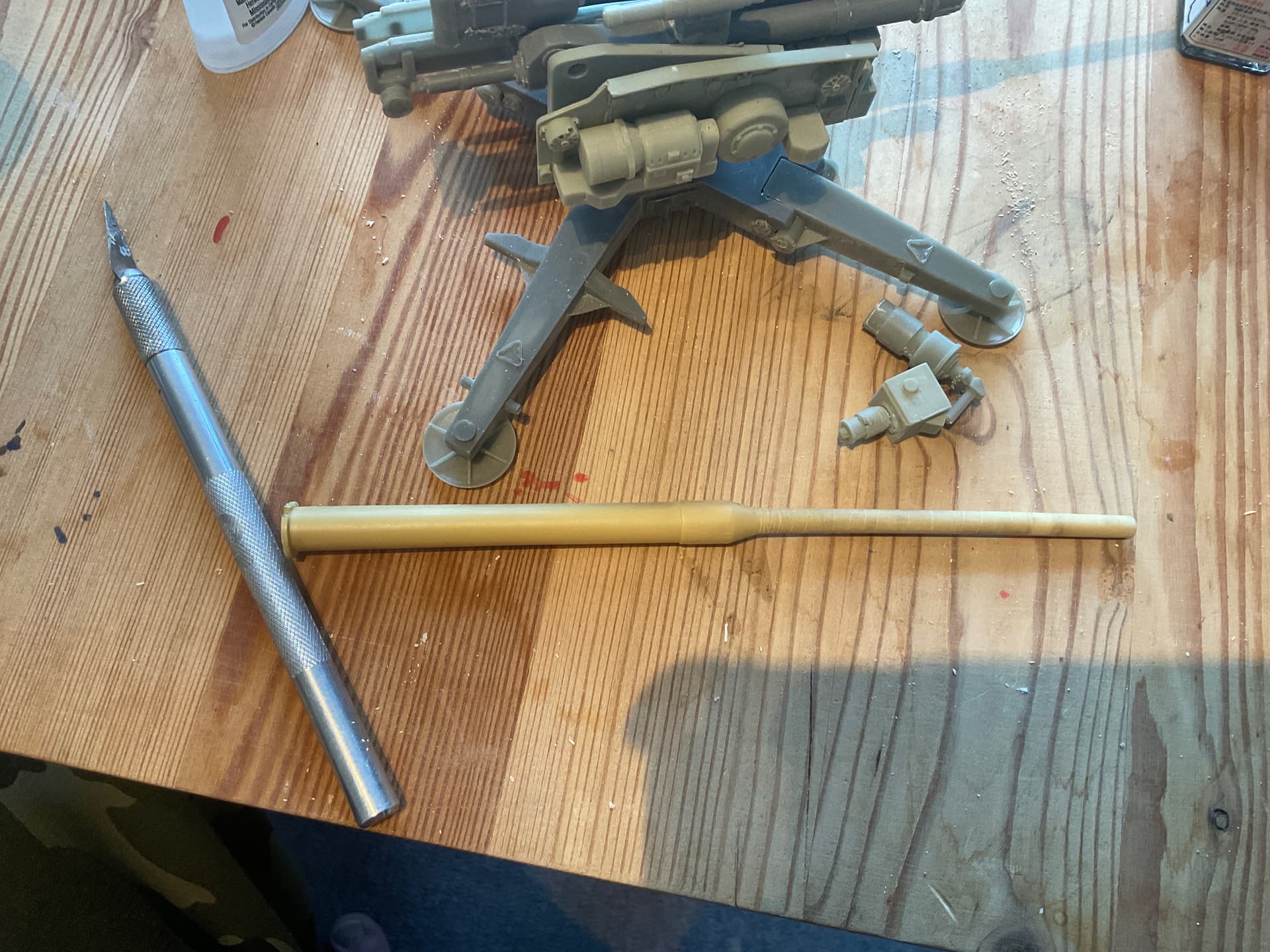

After many years languishing in a box almost better off forgotten, I’ve dragged this out to have a second go at it. One of the biggest hurdles was the barrel. Cast in one piece, with a warp that would almost allow shooting around corners, no amount of heating/cooling, flexing, etc would leave it straight. At one point I considered drilling trough it and inserting a steel rod, but I could figure no way to drill 7+ inches through the length of the barrel.
Fast forward a bit and a modelling buddy offered to turn on from aluminum - the results are, well, glorious.
Lots more work to do and a lots of details to scratch build and add. This one will be a while, but hopefully I’ll be able to plug away at it regularly.

Thanks for the info, I had no idea that kit was out there. Interestingly, there is very little info about it and can’t find one available (only pre-order or sold out), so not sure if it actually made it into production.
I did find a couple comments saying it’s a preproduction model, with some differences. There is also a 3D print one in development that looks ok from what I’ve seen.
