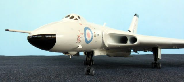

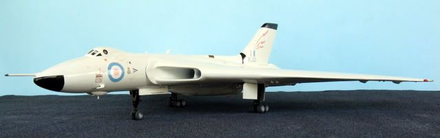

Here is my Vulcan XH558 & the real XH558 from this years Leuchars air show (awesome big bird, granted its subsonic, but mind popingly powerfull & agile);
** XH558 is finished in a non standard under & over glossy camo pattern - I assume for the benefit of the crowds, the genuine items at the time of Blackbuck only had topside camo & it wasnt as glossy.

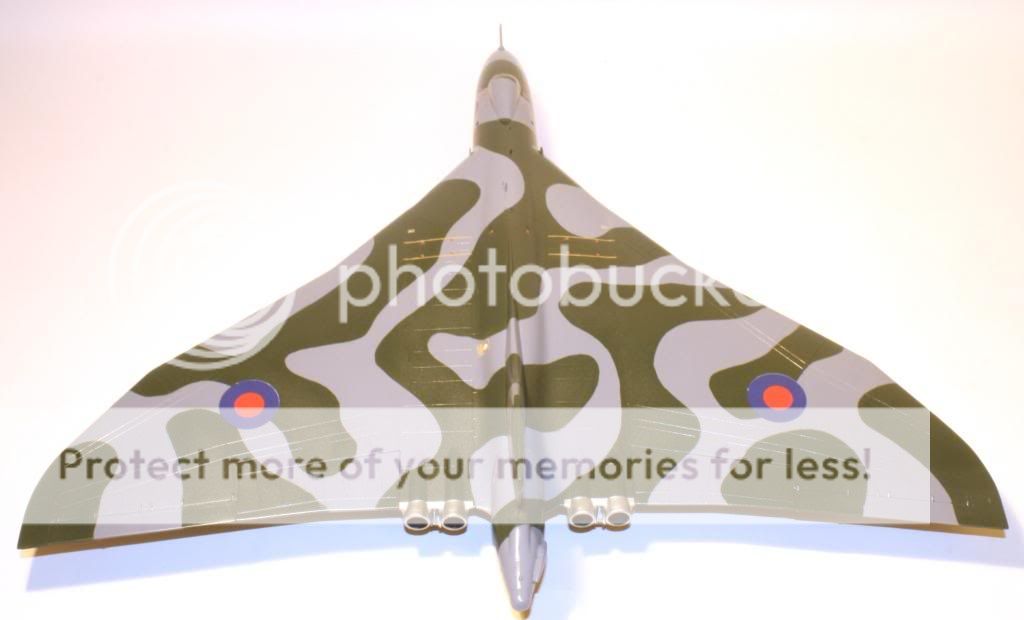

milairjunkie, what method did you use to mask the camo pattern? I’m building that kit now and investigating how I want to mask the camo pattern. Did you just use masking tape??

I tried Freehand painting (airbrush), masking with Maskol, masking with Blu-Tac (Silly Putty), with thin Tamiy tape & with 3M thin PVC pinstripe tape, none of which worked & none of which were even close to a sharp, smoothly curved pattern.
After some advice I got from this forum, I went out & bought some broad (80>90mm) regular diy masking tape. I then covered the top fuse/wing & tail surfaces in overlapping (enough to hold the tape together for removal) strips of the tape (this was easy as the Vulcan has relativley flat upper & lower surfaces), I did it in L/H & R/H sections, touching but not overlapping the tape along the upper fuse centerline. Then referring to some pics I sketched the camo outline pattern onto the tape & removed the tape in the two large sections split on the centreline. I then did the same for the bottom.
These masks were then put on a flat cutting surface & the darker (green) camo area cut out. I painted the model in the lighter grey & then applied my mask over this. The joins between the upper / lower & left / right sections were tidied up with thin Tamiya tape & the nose section, which this method would not have worked on was masked using thin 3M pinstriping tape (It’s pretty flexible). I then shot the darker colour, crossed my fingers & removed the tape - Voila, it worked very well compared to any other method.
The process was a bit on the tedious side, but took a damn sight less time than my numerous previous attempts.
