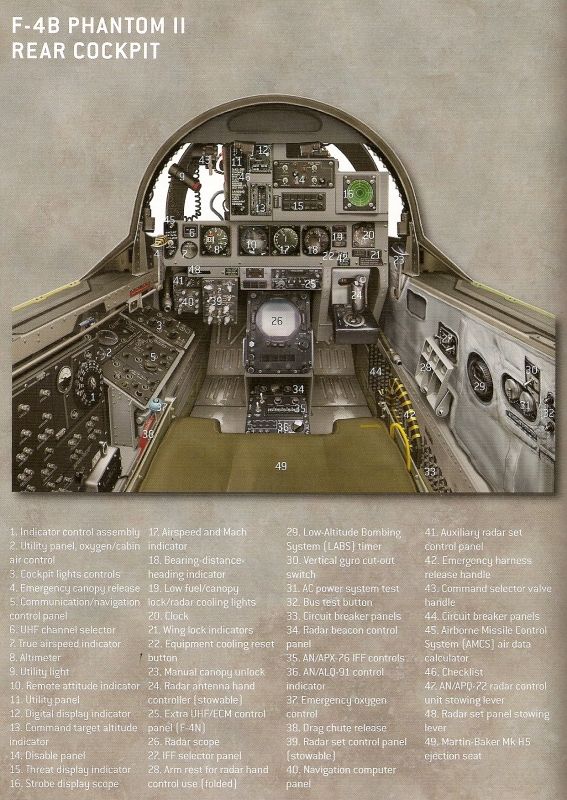

Not sure which one in Fermis’ pics is the “C” and which one is the “J” but they look pretty good to me—although it would be an easy fix to yank the rear stick outta the Navy (J) bird…
…begs the question as to whether or not the Navy back-seaters were qualified pilots???

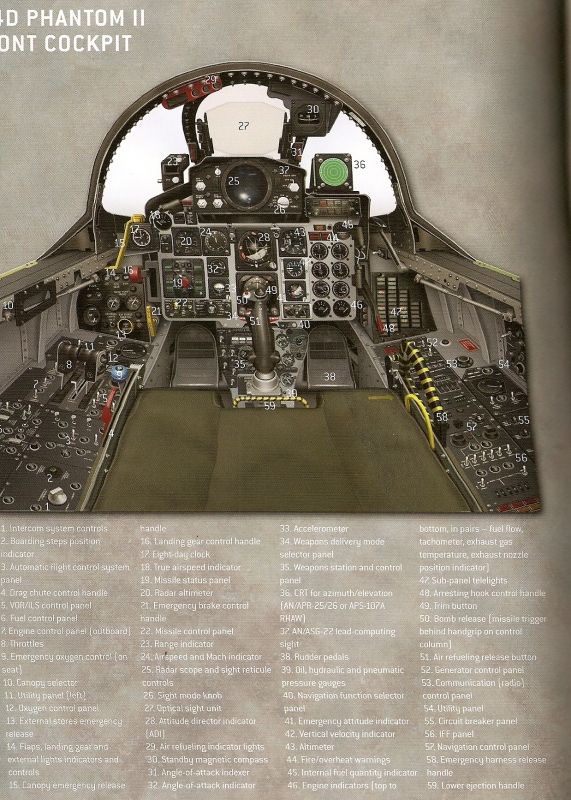

Found some cool plates in some Osprey books that show various IP’s from different F-4 models. Top one shows the rear seat view in a “B” model:

No, the Navy back seat guys were not pilots. They were RIOs, Radar Intercept Officers. The AF back seaters were WSOs or Weapon System Operators. For a while during Vietnam, Pilots were in the back seat to gain experience. They were called GIBs or Guy in Back. Although not qualified pilots, many WSOs learned the basics of flying to help out the pilot when he needed to take a break, or if he was incapacitated.

I was a little leary of the sticks being in back…then my brain got sidetracked and I put em in. I did find the rear sidewall parts too (not mentioned in the instructions)…explains why there were no PE parts for the right side(brush painted). I know the rear IP is different for the C and J, and the rear side panel goes on the J…how 'bout the C??? I also know that I need to trim off a bit of the hump under the nose and ixnay an antenna or two, to make a C.

The stick should definitely be in the back on the “C”, and the rear consoles that you detailed on it are spot on. You’ll only need the sidewalls for the J’s rear cockpit. You’re right about converting the hump and the antennas to make a “C”, and if I remember correctly, I think all the markings in the kit are for the “C”. Seeing your work makes me want to break mine out and build one of those Michigan birds, but my cockpits won’t look as nice as yours. You’ve done a great job with them!

So let me get this straight…the Air Force birds DID have the back-seat control column while the Navy birds DID NOT…correct?
correct, Manny,for the time period you are talking about
there were variations of when USAF had pilots back there and when they didn’t,and there were USN aircraft with sticks back there,but, not on the aircraft you are talking about building
