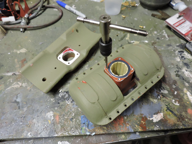

For the loader’s periscope I made the component function as I’ve done on RC sherman builds in the past, however for this build I developed a new easy way to add this animation.
The component is designed to be a all in one servo mounted drop in installation unit. With this system it removes any need to fabricate servo mounts / harnesses and complex motion arms to make the part animate. The device has been added to the ECA catalog aswell, http://eastcoastarmory.com/m4.htm

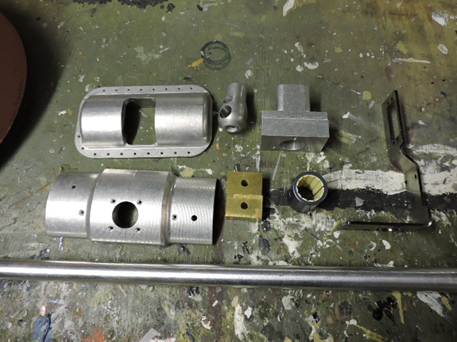

Once the external details were done I focused on the gun system internals

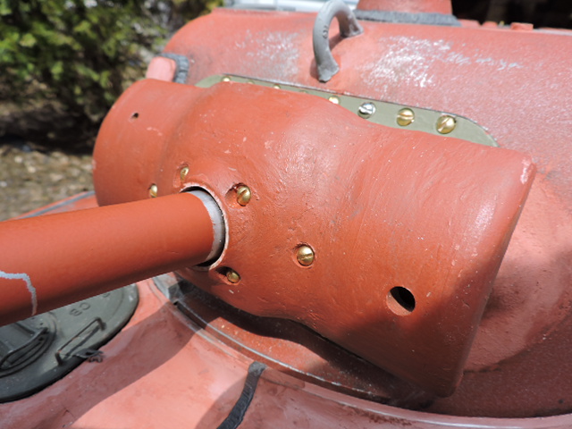

The stock mantlet and rotor had the basic overall shape and appearance for the firefly parts, and were a good base to work with for the mods. The rotor drum was modded in having it’s internal details added, along with extending the left hand side as the firefly rotor was larger then the 75mm version. Counter sunk holes were also added for the fasteners which is a common sight for sherman rotor drums.
[img]http://eastcoastarmory.com/forumpic/fireflyv/turret/DSCN1950.JPG
The mantlet also went through a bit of transforming getting it to the completed look that’s seen in the pics
For mounting the parts The real shermans used large slot screws. For the model I replaced the kit fasteners with brass slot screws, however the only fasteners that I can find in my area with the correct dimensions for the real screws are in imperial, so the mounting holes in the mantlet and turret were retapped.
Also because of the new rotor surface details the mantlet needs to stand off from the rotor more compared to the kit original, To do this a simple plastic spacer disk was fabricated and added in place.
The rest of the gun elevation system was assembled mostly OOB, with a mod made to the limit switch system, Rather then using the kit design I fabricated a self contained system that mounted to the trunion.
with this design the whole gun system is one complete unit and is easier to install or remove if need be, Also this system makes it easier for me to calibrate the limit switches compared to the kit design.
