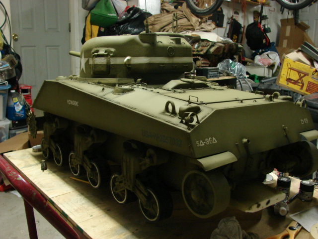

Thanks guys, For an armortek the weight is much lighter than the german tanks. The finished model weighs in at around 150 or so lbs. The King tiger I have from them is closer to 450lbs.
It’s been awhile since I posted any updates, but I made a lot of progress on the model completing most of the front portion of the vehicle.
Once all the work was completed in the last update it was time to start buttoning up the tank. For this I started with the front half of the tank due to the work needed for the bow hatches.
For the bow hatches the kit supplies you with two CNCed aluminum billets that have roughly the right shape and size of the wide welled early hatch blister. The kit also supplied you with a basic set of hatches
The blisters are a similar design from their first sherman release, only the units on the first model were made out of a hollow cast white metal alloy. Since these are solid billet they are much easier to rework and alter.
For the bow hatches I will be using one of my own early sherman hatch sets. to make my hatches fit better on the stock wells I enlarged the hatch well recess via the mill, also milled into the billet was the recess for the backup periscope. The Stock machined hinges were deleted as they will not be needed as I will be using the resin ones instead.
The squared off shape of the wells were rounded off with a few passes of the belt sander.
once the wells were revised it was time to mount them to the upper deck. The pieces themselves mounted perfectly with the stock fasteners and no fitting required.After the wells were added I also added on the bullet splash rim. these parts were also OOB. The only mod that I made was adding the water drain hole to the rear bullet splash rim corner (Pics to follow)
On this version of the sherman Armortek revised the upper deck design from their first release. On the first release M4A3 the deck was one plate of Sheet steel, this deck had two small triangular sections which needed to be affixed the the deck (either with straps and fasteners or welding). On this version of the kit the deck is aluminum and comes in two complete sections which makes it a lot easier to install. For extra support I fabricated two brass straps that will connect the two halves via countersunk fasteners.
these straps were added before the splash guards were added. The strap fasteners were blended in with the bodywork and are no longer visible. they will be connected with corresponding mounting holes on the rear plate. This will be done after the rear deck is mounted.
After the straps were fabricated I turned my attention to the turret rotation system. The kit supplied system was built OOB and assembles very easily.
After the rotation motor was mounted I turned my attention to the brass turret bushing. The bushing is a common feature found on the armortek kits and is very effective at ensuring smooth operation of the turret.
On all my builds I like to mount the ring to the upper deck via counter sunk fasteners. By doing this that ensures the bearing to stay in it’s place allowing the turret to glide over it during operation.
One these armortek shermans I encountered that the ring will make contact with the turret turning gear, which will not allow the ring to seat fully.
A simple fix was to remove a small section of the ring allowing clearance with the gear. All burrs and corners were removed and buffed smooth.
Once removed the ring slipped on like clockwork
Once the top deck was installed I then completed the front hatch area with the bodywork.
On these early sloped shermans the front plate was constructed out of 5 parts, two rolled steel sides and three cast units. The bodywork completes the illusion of the hatch wells blending everything together making it resemble the real unit. Once everything was blended smooth cast texture was added to all the appropriate cast plate units.
The resin hatch hinge was thoroughly blended into the cast surface.
In addition to the hatch wells I also built up and completed the Bow M1919 section. Like the hatch wells on these early style shermans the entire plate containing the M1919 ball equipment was casted on a long rectangular plate.
Because this kit was a firefly the kit was not designed to have the M1919. On the firefly they removed the assistant driver location for use of more ammo for the 17 pounder gun. In it’s place a large steel rectangular plug was placed on the hole. As I mentioned earlier in the build the well was all fabricated out of resin, PVC and epoxy bodywork.
For the M1919 ball unit I used the resin set from panzerwerks, I’ve used these sets in the past and they are highly recommended. The MG ball was hooked up the a servo and pivots on demand.
As a side note, because I ordered the kit as an M4A4 Armortek did throw in an Armorpax white metal M1919 ball set (special thanks to Armortek). The armorpax version is also very nice and would have been used, but by the time I noticed that they supplied the parts I already had the Panzerwerk version fitted. The armorpax set will be put in storage and will be used on my next sherman build…which shouldn’t be too far off lol.
After the front hull rework I then added most of the front hull details. These details are off the shelf ECA and include the head lights, lift hooks.
One new addition to the ECA catalog is the addition of the early sherman hull front antenna base mount.
http://eastcoastarmory.com/m4.htm
As for the headlights themselves they have been rigged to light via an LED. To better make the LED fit in the resin headlight housing I turned down the front portion of the led on the lathe.
Before I fitted the LEDs to the resin housing I first painted the entire searchlight silver, then Black on the exterior. The purpose of this is to insulate the resin casting and to remove the chance of the resin part “glowing” after the bright light is activated. Once all paint is dry the LED was fitted and mounted to the vehicle.
The lights on this model I configured to operate remotely. a remote activation switch was fabricated, along with a cut off so I can use the same channel for more than one operation… more on that to follow :wink:
More pics were posted on the ECA facebook page http://www.facebook.com/EastCoastArmory
and a video update was posted on youtube
http://youtu.be/RPQE-TN40N8
Now with this out of the way I have started finishing up the rear deck once fitted I will then be able to focus on the turret… more to come :wink:

More progress has been made and the tank is another step closer to completion.
Since the last post the rear deck was mounted,
Before I was able to mount the deck to the tank I first had to add the etch lines for the rear plates. On the armortek shermans the rear deck is one pressed metal pan. Because of this the panel lines that are found the real tank are not present. To add them I etch them into the plate with a Dremel. Before I add the lines I mark where the lines go, and use tape as a guide
with a steady hand the lines are etched, Once the lines were etched the interior of the plate was primed and painted in flat white, then was added to the tank
Once the rear deck was fitted I was now ready to add on the rear deck components. This would include the fuel cap guards, rear lift hook, and rear vents. For the guards the kit supplies you with two CNCed aluminum ones that work very well.
All the bullet splash guards received cast textureing, welds, and their drainage holes. All that will be added to complete the look will be the cast numbers, which will be added as the build continues
The rear hull blower was also mounted, for the part I swapped out the kit original for one of my own.
Just like with the rear blower I swapped out the basic kit supplied vent, lift hook, and front blowers with my own sets.
On the tank’s bow hull I completed the tin work. This would include the front fenders and the brush guards.
The kit supplied fenders were swapped out for one of my own sets. The fenders are all soldered together and are mounted to the tank’s fender mounts via fasteners like the real unit.
The kit supplied brush guards were not compatible with my head lights so I fabricated a new set that works better for them. Like on all my tanks the guards are all soldered together and have the plunger canister mounted to them. Chains and plunger detail to be added later.
The tank’s siren was also mounted. For this tank I went with a different style siren then I normally use. Rather than using my funnel horn I went with the Panzerwerk resin unit instead.
Because of the early period style tank I want to represent the larger panzerwerk siren was a more accurate choice. Also Unlike all my other shermans the siren is not mounted to the hull, or has a brushguard. Instead it is mounted to the front fender
Mounting the siren here is another early war / production trait, Because of the high vulnerability of the siren getting damaged in this location it was moved from this spot to the front hull where it would be protected by the caged brush guard. Like the real one the part itself is attached to the fender via a fastener.
The M1919 Tarpaulin rail was also affixed to the tank, welds will be sculpted soon.
Work was also stared on the turret. this is the biggest difference from my model than the other armortek firefly kits. When I purchased the kit I requested that the kit firefly turret and gun be swapped out from the turret and gun from thier 05 release early M4A3.
The turret itself is all one piece aluminum casting, has real cast texture to it and has a very realistic feel to it. The turret has a cooking pot resemblance.
The turret’s floor is made out of laser cut steel and is comprised of the floor, turret neck and the turret rotation gear ring. the parts are very nice and assemble easily. Before prime and paint I simply hit the surface with an Emory cloth to buff away any surface rust that was present.
Once complete the parts were painted and installed. The only addition was adding lock washers to the fasteners
After a few small tweaks to the bullet splash rim the turret plops into place and rotates on control.

More progress was made on the model
The 75mm conversion / gun work has been made and completed, It is at this point where my model is different from the other 24 other firefly kits produced, which are all 17 pounder equipped tanks.
When I received the kit it had a mixture of gun parts from the older 75mm kit and the current 17lber firefly
There were not enough parts to build the complete elevation unit for either design, but with the parts supplied I was able to cobble together a Frankenstein design that utilizes parts from both kits
Like I mentioned earlier when purchasing the kit I specially requested to have the turret and equipment swapped with the 75mm version. This also included the kit’s M34D mantlet and rotor drum. The kit original parts are very nice assemble easy and were one of my favorite parts from the first kit.
Unfortunately because of the time period that I’m building the tank for, the M34D mantlet was not developed yet, so I will not be using it on the model <:^( . In it’s place I fabricated the early war period M34 mantlet and rotor drum.
The earlier design of the M34 has the gun protected by a smaller thinner mantlet.
The gunner’s scope is missing as that was developed later, and the coax M1919 barrel emerges from the rotor drum and is very exposed.
There were several different variations of this style of mantlet, of which these versions are currently in development. This set however has been added to the catalog. http://eastcoastarmory.com/m4.htm
The set is designed to be compatible with the Armortek components / kits, but the parts can also be adapted for use on any other 1/6th scale sherman model… like for backdating a viper, vantex M4, or for backdating… the new DML firefly to a composite hulled M4 :wink:
While on the 75mm barrel I smoothed out the barrel’s small cnc marks with some Emory cloth. to speed up the process I placed the barrel into the lathe
another part of the barrel that I tweaked was the barrel’s front. Like with the German tanks the kit’s barrel has muzzle break threads located on the barrel’s front tip. but unlike the later 76mm gun the 75 never received a muzzle break so the threads are not needed.
To improve the look I developed a resin plug tip that slips in the barrel and gives a more scaled thickness, and the detail of the emergency cross hair groves,
Once added and blended in the barrel was primed and mounted to the trunion along with the other elevation parts
For the elevation motor system the kit was supplied with the newer style.
Because of the longer trunion on the older kit the motor needed to be mounted lower on the motor mount. To to this I simply drilled a new hole lower on the mount and fitted the motor upside down.
On this build I also wanted to do something different than my usual RC tank. For this build I wanted to have the model be able to have a functional main gun. For this feature I wanted to install into the tank an airsoft gun. For the firing unit I went and acquired the bb firing unit from the Heng Long 1/16th scale tanks,
The unit was left stock with no added mods. A standard airsoft barrel was acquired from ebay and fitted. Once fitted I modded the unit to mount to the armortek bracket, and to have a hopper devise for the bbs. For the hopper I used an empty tin of mints
some advantages of the tin is that it has a nice low squat shape that saves space in the cramp confines of the turret, and it has a convenient open able lid that keeps the bbs from getting loose and running amok on the interior.
to help with the alignment and mounting I machined a few spacers for the barrel so the firing unit is centered in the tank’s gun barrel and fires straight out the front. The elevation limit switches were also fitted at this time
To fire the gun an simple remote firing system was fabricated using a servo and an impact switch. a manual kill switch was also added for safety. the unit is also powered by a separate battery source. that is carried on board
Just prior to mounting to the tank, I added the coax M1919 MG. For the barrel itself I used the Panzerwerk resin one as I mentioned before are highly recommended
To add more to the realism I was able to make the M1919 elevate with the main gun simultaneously. This was done by attaching the gun to the one pivot screw. The screw pivots with the mantlet, and since it’s the pivot point the M1919 when attached will move true and seamlessly. It’s a very simplistic feature that is low profile and passive. No extra servos or equipment is needed.
http://eastcoastarmory.com/forumpic/m4a4/gun/DSC01469.JPG[/img]
For installation of the unit, I replaced the kit recommended hex bolts for domed slot screws. Because it’s not easy to find metric slot screws this size I swapped out the metric for standard. The screws themselves I find in Radio Shack.
After the installation of the gun I decided it was time for a another road test. With the turret and hull weights now basically established I can set the track tension and chew up some lawn… which these VVSS have a knack on doing :wink:
Then after a nice Sunday drive I hosed off the lower portion and got the tank back in the shop and on the lift to continue construction.

More progress on the model was made and the tank is another step closer to the finish line.
All the functions have been completed, this includes the turret and the hull functions.
With the functions now out of the way, the project’s back has been broken and it is all down hill external detailing from here.
Like on my last RC sherman build I added the function of the pivoting loader’s periscope. The kit has a nice milled recess for the periscope. To make the unit pivot I modded one of my resin periscopes to rotate on a sleeve plug.
The sleeve was then epoxied to the interior of the turret.
The scope is hooked up with the turret rotation function and pivots when the turret is activated. This function gives a little more animation to the model.
The last function that I added to the turret was the functional gunner’s scope.
The gunner’s scope on the sherman like with most tanks is connected to the tank’s main gun… and elevates and depresses with the gun in unison. I wanted to add this feature to my build as it helps with the accuracy of the tank, and is something that I haven’t seen done before.
The top plate was retained as it was the correct size and shape, only mods made were the addition of more fasteners and the split line detailing. The turret already has a nice divot in the casting and a securing plate for the scope.
The scope notch was drilled out, and pivot mounts were also added. For the scope itself I modded a spare panzerwerk periscope and fitted it to a rotor drum, finally for the top hatch door I used one of my resin periscope covers. To pivot with the scope the molded in hinge was removed and in it’s place micro hinges were used.
As for the hookup I simply used a connecting rod to hook the system to the gun. this way like the real tank it moves in sequence and because it’s passive no extra electronics are needed and saves interior space.
The last function that was added to the hull was the addition of the taillights. For the taillights I used one of my own sets, along with a set of my tail light brush guards
Like on my other builds I modded the LED to fit snugly into the tight recess of the taillight.
The lights were patched into the headlight circuit and works along with the other lights
After the last of the functions were added I started to comb through and add the remaining exterior detailing. So far the front portion of the vehicle.
Starting with the sprocket, since the test drives showed that the sprocket needed no adjustments I fabricated a cover cap for the center fastener.
the cover cap was fabricated out of a thin sheet of brass. By being so thin it covers up the fastener and keeps the recess that is found on the center of the Sherman sprocket.
On the front plate the cast numbers, foot rest, welds, foul weather driving hood clips and the bow hatches were all added.
I used my early sherman hatches for the model, like with my other builds I used the panzerwerk periscopes. The interior portion of the hatches were painted and weathered
One mod that I made to the hatches though was the removal of the counter weight assist spring and mounts. Because this tank is being built as such an early vehicle these springs were not developed at this time. It is also because of this reason why I didn’t add the brush guards to the periscopes on this tank… as they would be anachronistic.
On the tank’s rear deck I added the fuel cover caps. The caps on this tank were supplied with the kit and they are from armorpax. They are very nice, easy to build and are fully functional. They were assembled out of the box.
I also fabricated the tank’s grill work. The M4A4 had a unique rear deck setup compared to the other variants of the sherman. The A4 had a small intake grill just aft of the turret which was placed right in front of the engine’s radiator.
The grill itself was the typical US design, where it used welded slats. The kit comes with a laser cut sheet metal grill. The kit grill is a decent piece, but rather than using the kit supplied one I went and scratch built a new one.
The new grill is all fabricated out of soldered brass strip, and sits in a box frame like the real one. Also like the real grill the mounting straps, and lift handles were also fitted.
The only plastic part is the bullet splash guard, which was made out of styrene. As I mentioned before the rear bullet splash rim was making contact with the turret and was deleted… What’s interesting is that this same issue happened in real life with the real M4A4, and the designers redesigned the grill to have the bullet guard connected to it.
After the grill was completed the grill was primmed/ painted in it’s base coat, and a weld was sculpted on for the bullet shield. The grill will be fastened to the tank after the radiator cover is fabricated/ mounted… more on that to follow!!
The fire extinguisher box was also fitted at this time, As of note you can also see that the guard has a notch cut out for clearance. The extinguisher itself is one of my resin units.
The top deck engine hatch was also fitted. The kit supplied hatch was a nice made component, but after I made some mods to the upper deck it was no longer going to be compatible. I obtained an aluminium plate of the same thickness and fabricated the new hatch for the dimensions of my rear deck.

Since the last post the tank has progressed some more and is now about 95% complete
After the base was completed I added the markings, Like on all my builds the markings are painted on via home made disposable stencils. This includes all the stars, stripe, and TO&E markings
For the tank’s markings I went with a style that has not been done in 1/6, and that is of a stateside training vehicle. Vehicles like this would be in this configuration with the white stripe in Fort Knox, and in the Desert Training center in California.
Many M4A1s, M3 Lees, and Stuarts went into North Africa with similar paint schemes, but the A4 was relegated to training in the US before being sent off as lend leases… or upgraded and sent to Burma and China.
There were also other options for the stripe, Yellow and Blue were also done in this format… possibly an idea for future builds :wink: . When I had the idea for the A4 project I wanted to build it for this scheme / era as once done these tanks look very sharp and distinctive in this format.
Another early war feature that is found on the markings is the Blue ID “W” prefix lettering.
The lettering at the early part of the war was in blue, and had the “W” in the code which stood for “War Department”. This was changed and dropped by around 1943 where the numbers where in white, and had only a USA prefix
After the markings were added the tank got it’s weathering.
[img]http://eastcoastarmory.com/forumpic/m4a4/markings/2/DSC01358.JPG/img]
After the weathering was complete the tank’s tracks were painted and fitted
The tracks themselves were painted and were left unweathered. Because the tank is RC and the tracks are made out of metal, they would weather themselves after drived a (very) short distance. Which was subsequently done after the tracks were mounted… for testing and weathering purposes of coarse :wink: .
After the tracks were taken care of, I then moved to the remainder if the fittings, this includes the red painted zerk fittings, red fire extinguisher handles, MP48 Insulator, Copula interior
The two M1919 gun barrels were painted/ weathered and installed at this time
The tank’s head / tail light lenses were also fitted.
The last bit that was added was the tank’s fuel filler caps. Like with all my sherman builds the main filer caps are fabricated out of Aluminum. The radiator filler was also mounted, this is resin and comes with the radiator cover set. The caps were all weathered and like on all my US AFV builds the cap pins are chain retained.
