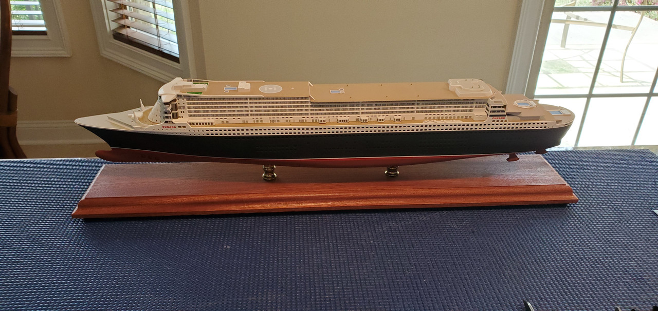

I decided to do a quick build of a 1/600 Queen Mary 2. I’m going to try to build all the 1/600 ocean liners available before I move back to the larger scales.

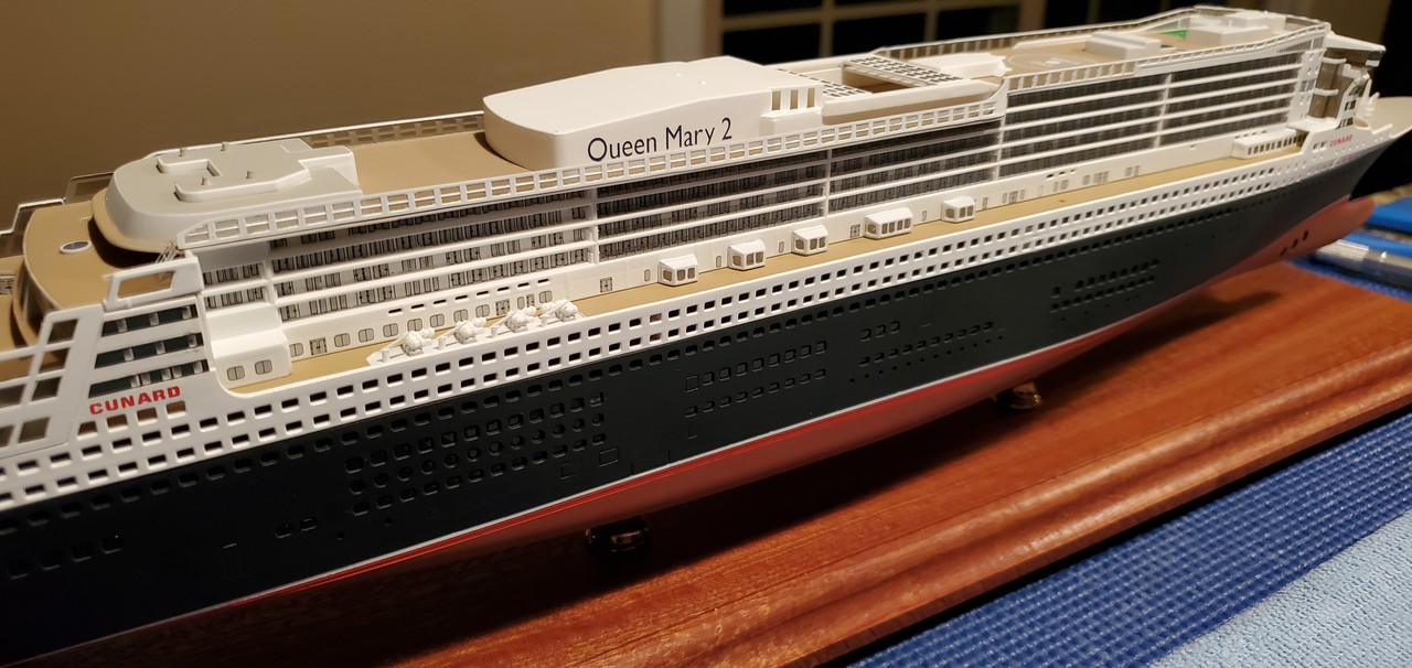

I’m curious what your process is for coloing in the windows on these kits, they’re always so clean. These all look molded in, but I know on past builds of yours they havent been.
Thanks Alterean. It really depends on the kit. I prefer masking and painting but that often isn’t possible. I have used masking, PE Frames, decals, a paint pen, and a fine line ink pen on diferent kits. I have also used combinations of the previously mentioned on some kits. The windows are always the hardest thing to color for me on these liners.

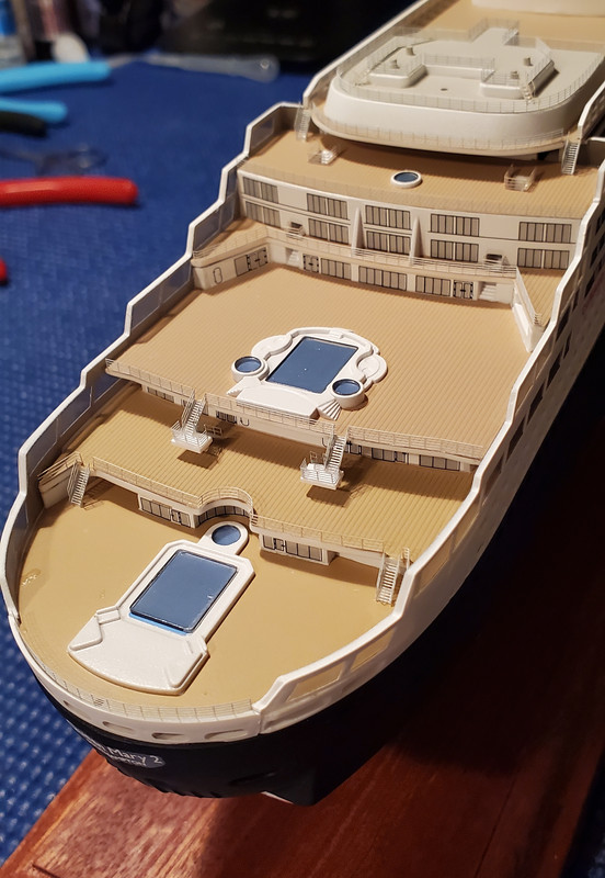

This Queen Mary 2 has a bit of everything. There are the molded in windows, lots of decal windows, and a bunch of clear parts that needed to be masked and sprayed.
These are clear parts that were masked and sprayed on Queen Mary 2.

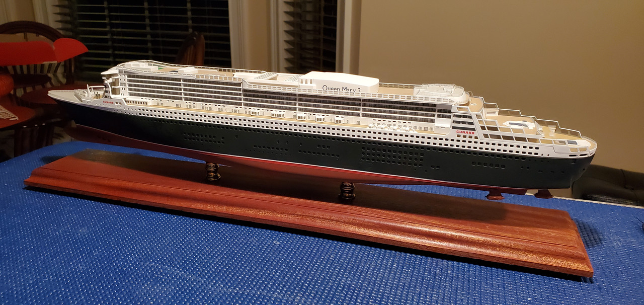

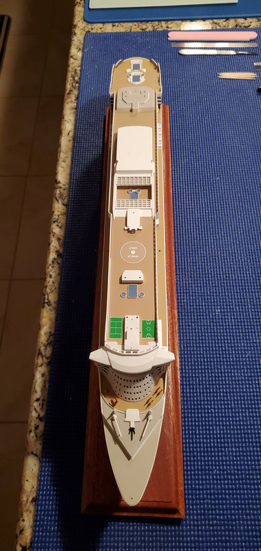

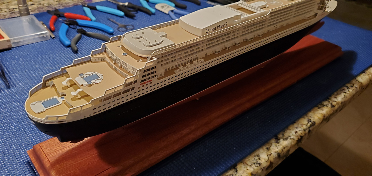

More progress on 1/600 Queen Mary 2. I’ve decided I’m going to build this straight out of the box with hardly any PE for a change. I think the cost of PE railings to do this kit will be more money than the kit. Just the balconies alone would be expensive. I would rather put that cost into the 1/400 version. Out of the box really makes it a quick build.

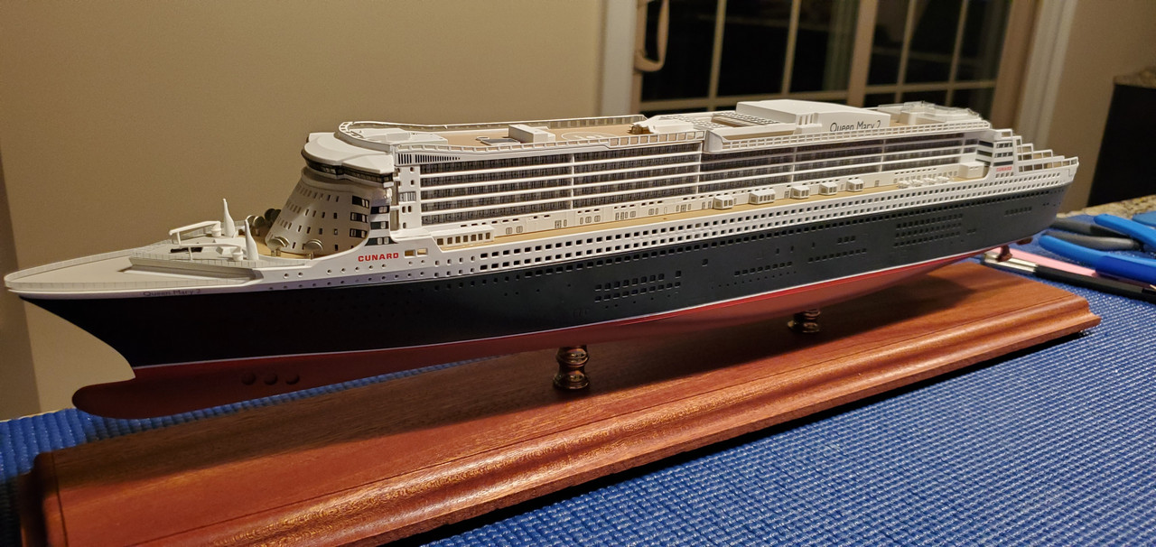

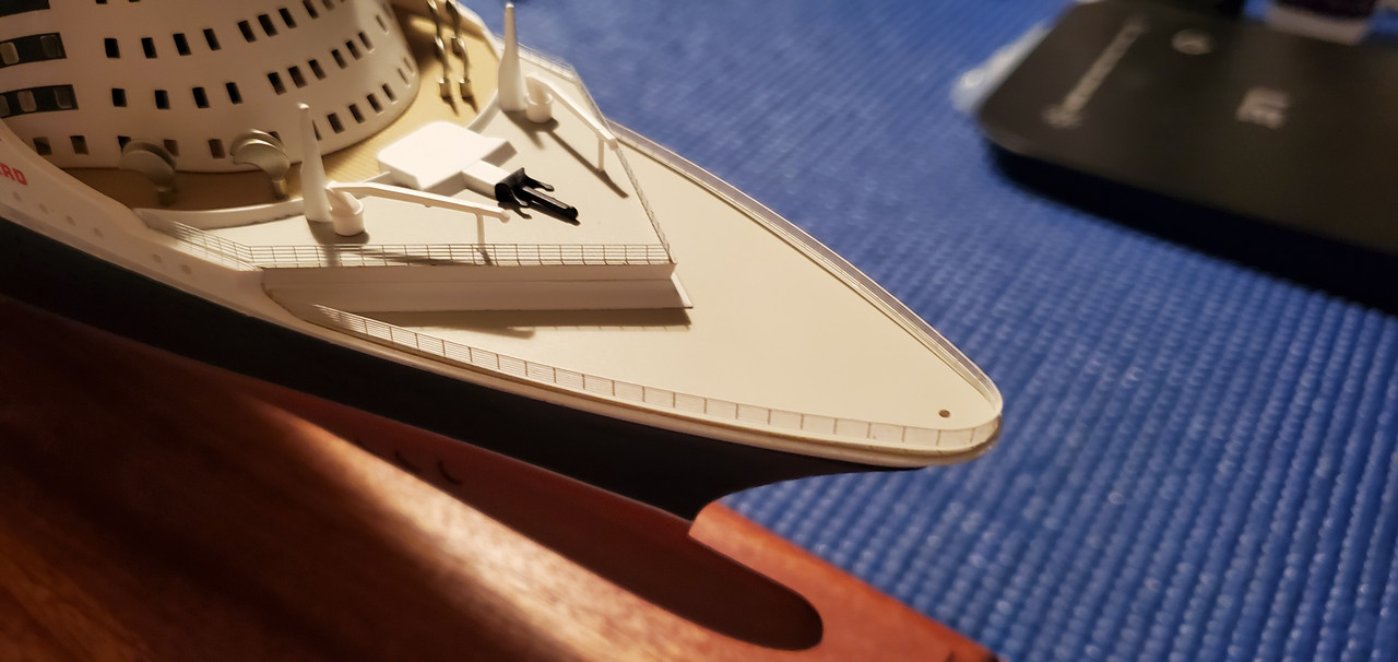

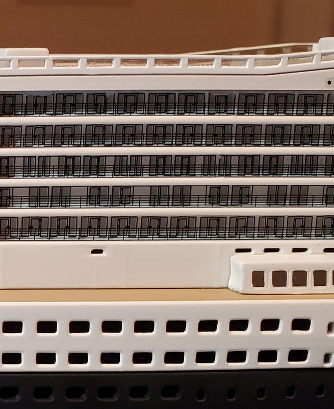

I said I was gonna build this out of the box but I flip flopped and started doing black PE railings on the balconies of 1/600 QM2. Did the first four blocks on one side. I have some Gold Medal stainless PE which I can never seem to bend correctly so I’ll use it up here since these are straight runs. I’ll use brass for the rest of the railings. I also changed the color of the screw blades from copper to something more towards a steel color.
