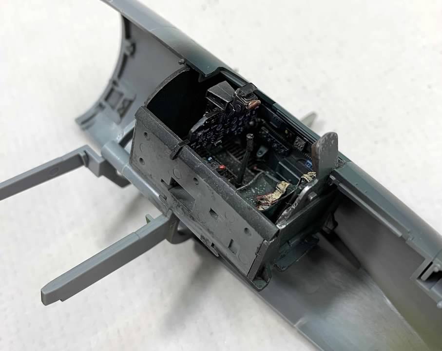

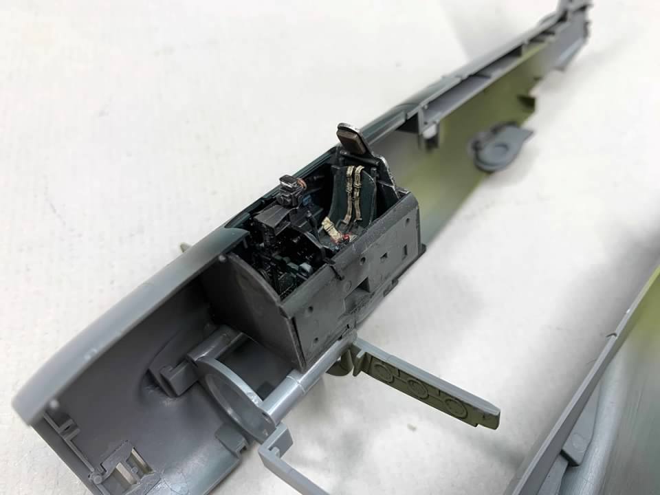

I was lucky enough to source Gallup’s markings, Rat-A-Dat 3, through a Superscale sheet. I’ve always had good luck with Superscale. I stated with the pit. On this one I experimented with the frisket chipping technique, that being silver paint first, liquid frisket dabbed on with a sponge, then paint. Once dry, rub it off and it reveals silver chipping. I’m not crazy about how it turned out here. I’ll have to save this technique for cowls, wing roots, Japanese stuff, and maybe pits in 1/32 scale.
On another note, I used up the last drop of my long time go-to cockpit wash, The Detailer, and it seems they not longer make it. Apparently now I need to find a substitute. I liked The Detailer because it was water based and easy to use. On this one I used AK Dark Brown enamel wash and was not impressed. Perhaps I’m using it wrong. I’m open for suggestions. If anyone has Black Detailer wash they want to part with I’ll offer a King’s ransom for it…
On a positive note, I like AK Real Color’s Dark Dull Green, which seems perfect to my eye. I also like the Eduard Zoom instrument panel I fired in there. Anytime I don’t have to paint or decal an IP it’s a win for me. I recommend these.

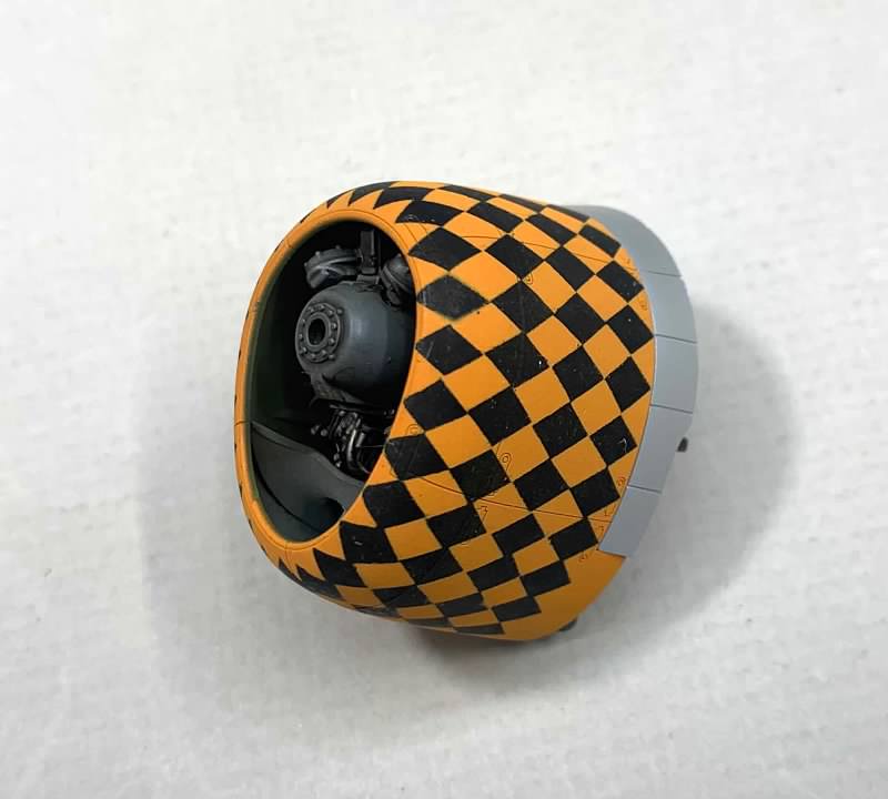

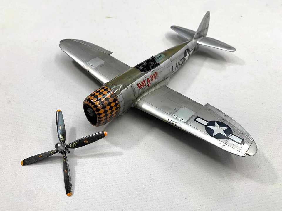

Next I switched to the Pratt and Whitney. I’m not a huge fan of Tamiya’s example. I think it’s average at best with the weak cooling fin detail up front. Someday I’ll drop a Quickboost replacement in one of these. Anyways, I rigged that turkey with lead wire. If your interested in trying this on your next radial, here’s how I do it:

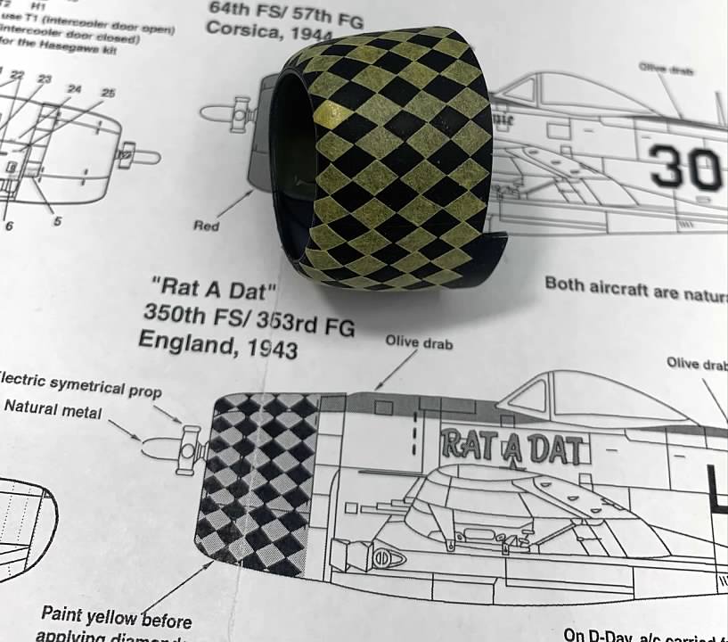

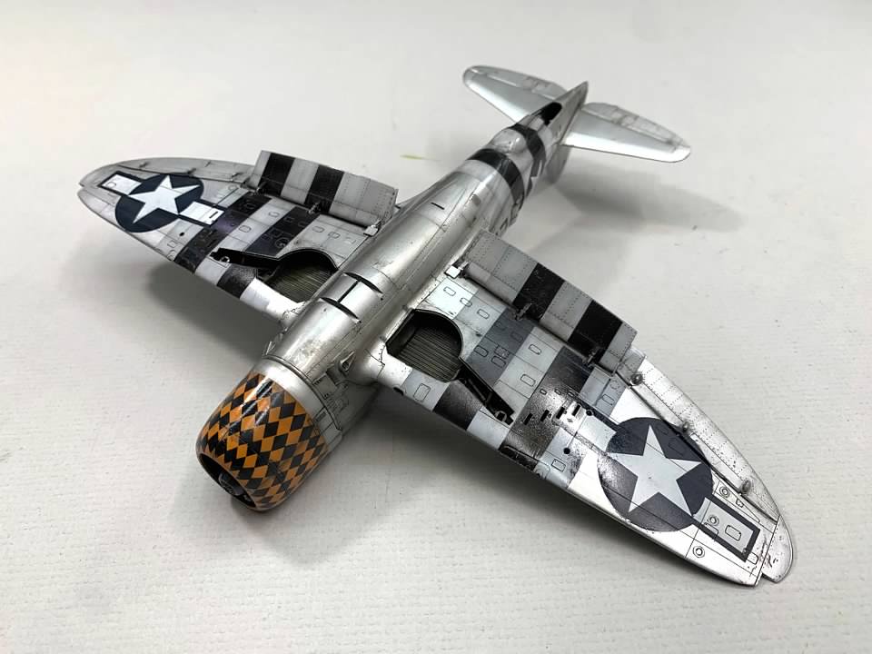

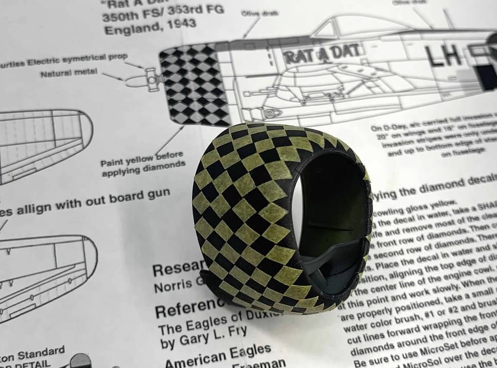

Next I wanted to get the black and yellow 353rd checked cowl overwith and out of the way. Superscale includes decals for these, but the sheet is old and likely for the Monogram or Hasegawa kit. Besides, I figured it would be fun to torture myself a bit and paint them on. To add insult to my figurative injury, they go from big to small and are diamond shaped…ugh. Squares would have been too easy. After spraying the black, I got busy by cutting out a few of the diamond decals out and I used them to cut the diamonds out of Tamiya tape with an Exacto. I worked my way around and after two nights of work, a some minor cussing, I was done.
Far from perfect, but I can live with it…
I sprayed the yellow (touch of red added) then peeled off the tape. I was fairly pleased. Again, not perfect, but I suspect they weren’t perfect on the real thing as these markings were field applied.

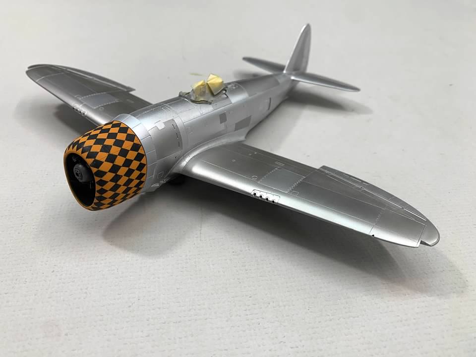

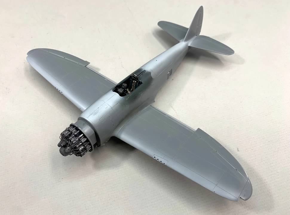

The airframe went together without a hitch…ready for natural metal. The Tamiya Jug is a joy to build.

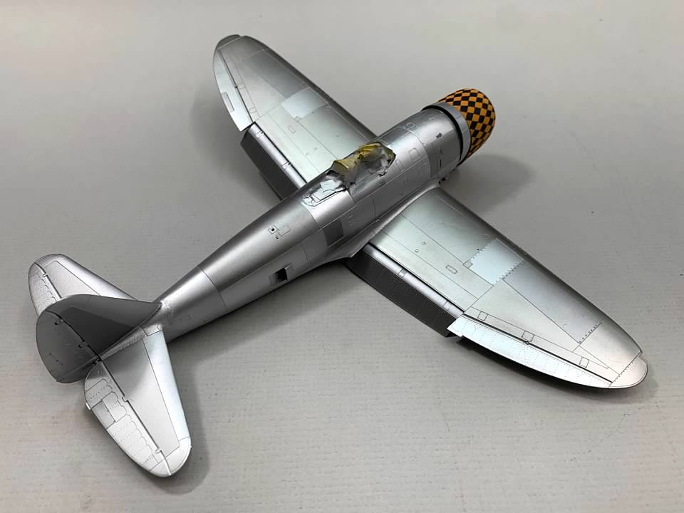

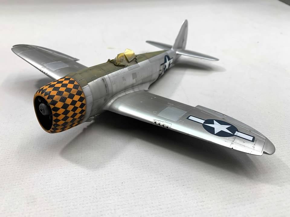

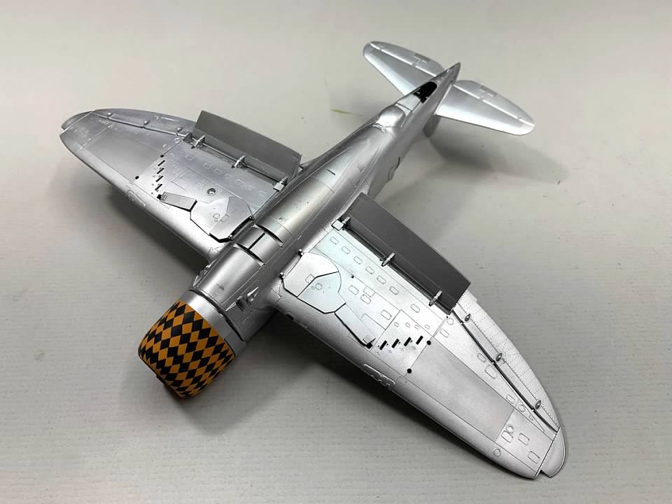

So I ran out of Alcad Duraluminum halfway through the top wings. I decided to give the AK Interactive Xtreme metals a shot again. Here is the result of several shades, namely Duraluminum, Aluminum, Dark Aluminum, and Matte Aluminum. The wings are Duraluminum and the fuselage is Matte Aluminum. Various panels were picked out with the other shades. Verdict?..it’s mixed. They spray nice and smooth and don’t pebble like Alclad will sometimes. The downside is they are enamel based and take a while to cure. I had some lifting when I taped off some of the various panels, however, this may be my fault as I neglected to use their primer for these. I’ll still use it ocassionally here and there, but I think I’ll restock my Alclad.

Far from perfect my !!! That is friggin’ amazing work Joe!!! Over the top brother!!
Absolutely
Extra-ordinary work on that cowling, my friend! She’s shaping up beautifully. [Y][B]
Wow. Well done.
Love the cowl work, Joe. And the metal finish of course is sharp.
I’ve had good results with Flory washes if you haven’t tried them before.

Thanks Hoss. I’ll give Flory a try in there.

Great looking cowl of course. Worth the time and effort. And the cursing. Happy to hear your verdict on the AK extreme metals. I’ve been tempted to try some new things, but honestly I’m so stuck with what I’ve learned with how to use Alclads that I’m a little afraid to venture off.

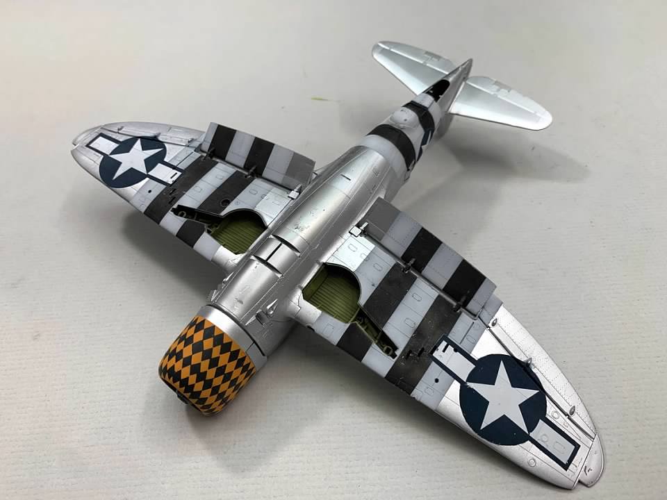

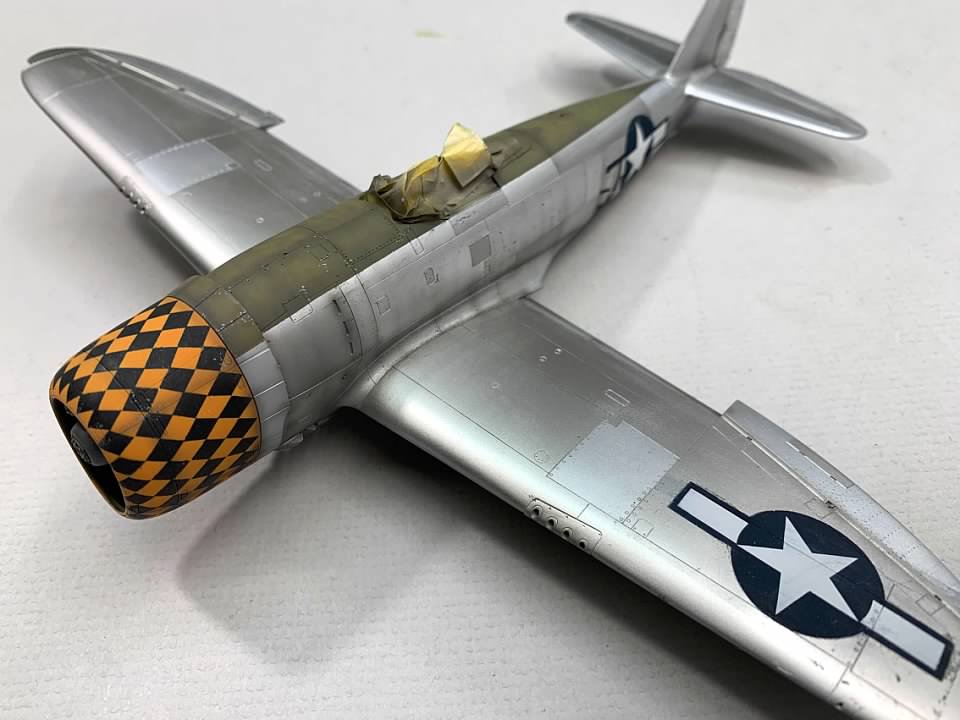

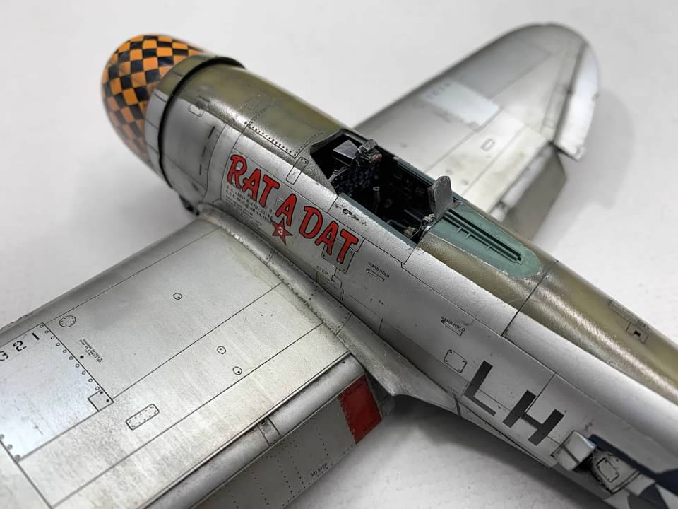

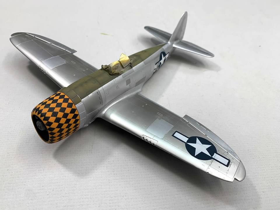

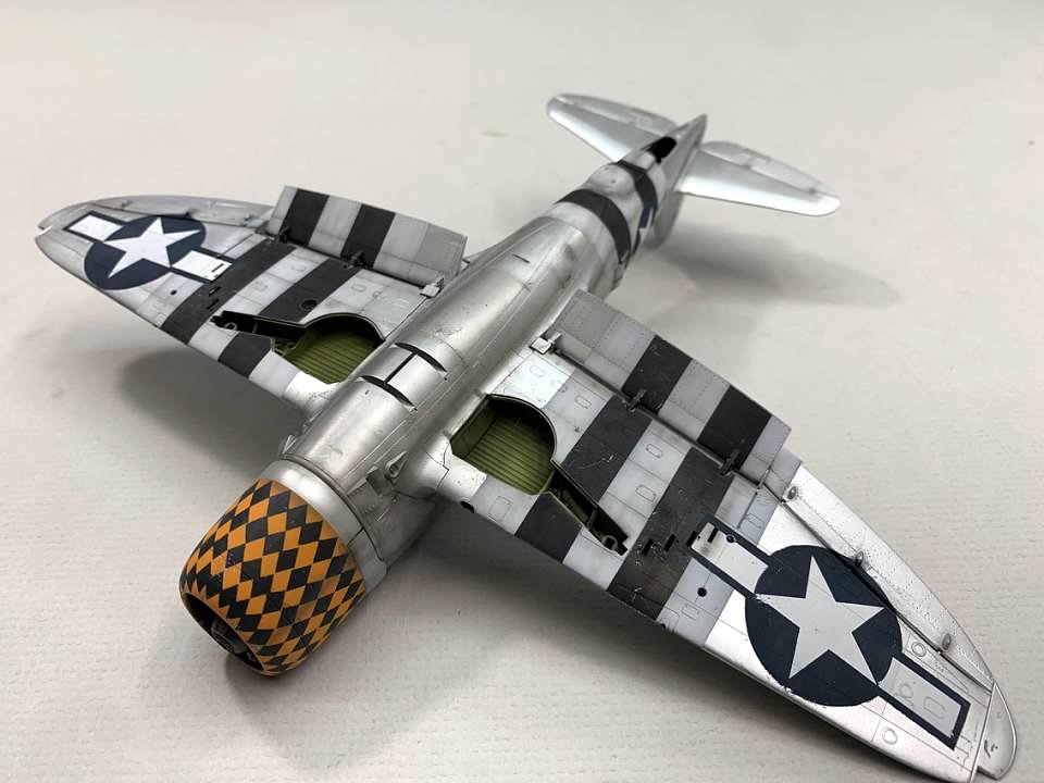

Quick update. It’s finished but I figured I’d continue with some in-progress stuff first. I continued with paintng. I added the OD anti-glare with AK Real Colors and the lower fuselage invasion stripes. I had some lifting of the AK Xtreme metal here and there which I had to repair. No rhyme or reason to why. I never have this problem with Alclad. I painted the stars and bars with the use of Montex masks. When I removed these masks some left residue stuck to the AK Xtreme. Again, no idea why. It was stubborn and I had to carefully sand and repaint these areas. This really annoyed me. This stuff is too fragile for taping it seems. I’ll still use it, but not for anything that involves taping. I’ll leave that to Alclad.

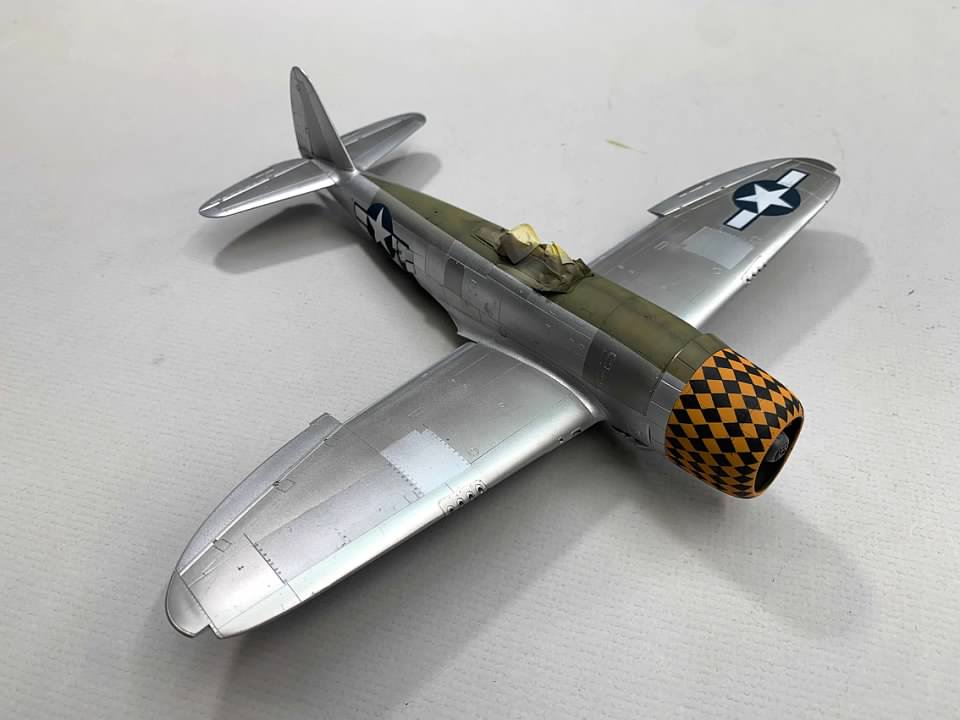

Next I added some postshading with NATO Black and Red Brown mixed with diluted alcohol to weather the metal. I focused mostly on the forward fuselage and along the wingroots. This took awhile to build up on the natural metal.

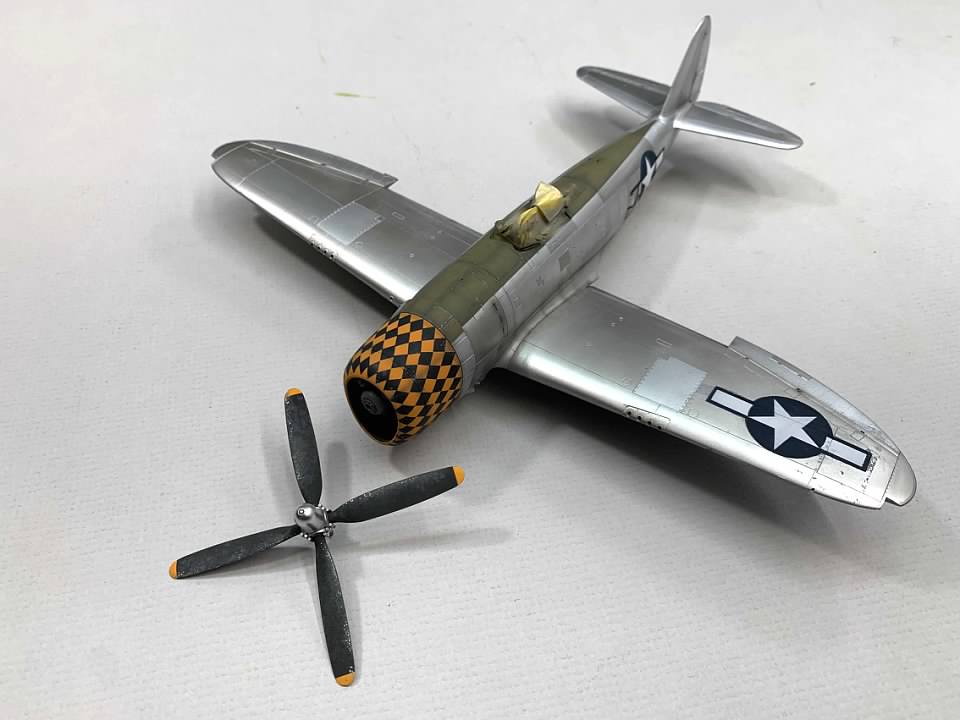

After a light gloss coat of X-22/MLT, I used the Superscale decals and as usual I had no issues.
Next I added an AK Interactive paneliner wash which also used as a filter to dirty up the NMF finish. I was going for a used appearance which I think has been achieved.

Outstanding as always. Would the diamond masking been easier using one of those Infini cutting mats?
Yeah, they have a comprehensive benefits package, including dental.
Thanks! Probably, I seem to always do things the hard way. Builds character…
