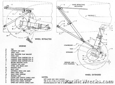

So far this is the best example that shows what I need to do in order to accomplish what I want. Let’s just hope I don’t screw it up!
http://www.pacificwrecks.com/resources/aircraft/b17/b17-gear.jpg
Almost every AM item for aircraft are created for showing whichever particular aircraft on the ground with haches, cowlings, panels, canopies, etc. OPEN. Think the bulged tires from True Details. Only those prop blur things and some seated pilot figures are geared towards in flight displays. The trend for model companies since the 80s is to not even offer a gear retracted build option, and seated pilot figures are extremely rare on new mold kits nowadays.
You are definitely going to have to modify your build yourself to show it retracted. But, at least on the B-17, that is a fairly simple proposition.
You can simply leave off the extension arms, the small parts of the gear leg, and tuck the main gear leg and wheel into the well. The tire sticks out the bottom of the nacelle with just a small bit of the wheel rim showing.
Yeah I figured as much. Only thing is I will have to check how it looks. Don’t want it to look too sparse because too much of the struts are missing. I will need to do this very carefully…

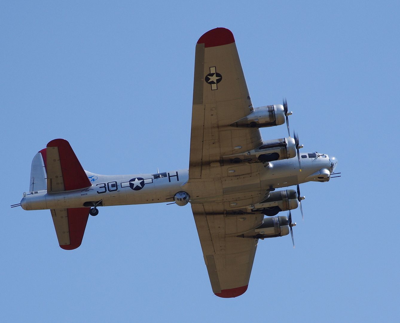

Here it is down if that helps. Surely it can be built both ways. They also fly gear down with some added drag. LOL.

Looks pretty basic from below. You may need some styrene rod to lengthen the leg to unladen dimensions.

Thanks for all the great pics everyone. Haven’t had a chance to sit down at the bench yet, so I haven’t even started the mod. But your pics help me a lot with referencing how it should look. One last thing though, in some photos I’ve noticed the main gear up but the tail wheel is down, and in others, all the wheels are up. I assumed that the tailwheel went up with the main gear, but was that not always the case?
The B-17 main gear retracted electrically rather then hydraulically, which is why it takes so long (ditto the bomb bay doors). An electric motor on a screw jack extended or retracted that support strut by folding it in the middle (When the crew spun that crank on the rear of the bomb bay bulkhead to extend the gear in an emergency, they are putting revs on that screw jack). When retracted all you see is a portion of the wheel and one side of the main strut. As mentioned, you may have to lengthen that strut to an unloaded position or to allow for the kit engineering. The tail wheel simply tucked up as well, but the retraction circuit could be disconnected either intentionally or it could be damaged, most would have it retracted, but you might find some not.
Post war USAF B-17’s had the tail wheels locked down just like the P-51’s had their tail wheels locked down.
