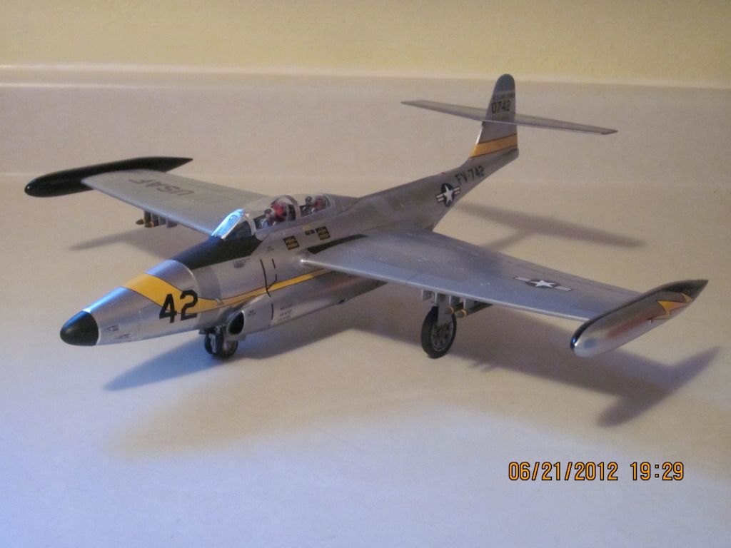

Hi guys!
Thought you might like to take a look at the latest and greatest (well…for me anyway). I’ve always loved the F-89 and all the variants. Heck, I love all Northrop planes. This one was extra special for me though. I love hearing all the stories my dad tells me of his life growing up on Hamilton AFB during the 1950s and '60s. His dad (my grampa) worked as a machinist on base.
When my dad was in his teens, he and one of his really good friends used to work on the base doing little maintenance jobs. My dad used to tell me about seeing F-89s all over the place. As luck would have it, I was able to find a set of aftermarket decals for F-89Cs from the 84th FIS based at Hamilton. So this one is for my dad. When he comes to visit next month for my oldest daughter’s birthday, I’m going to give him this model. Next up on the block with be an F-101B also with 84th FIS markings on it. He has great stories to tell about that plane, too.
So here it is. This was the first model I ever used Floquil on and I’m sold on it! It’s a combination of Old Silver and Platinum Mist. On a side note, I learned on this model NEVER to use MM metalizer lacquers over MM enamels. I ended up stripping all the paint off which took me forever. I shelved the kit for about a year before I felt the motivation to repaint it.
Enjoy!
Eric

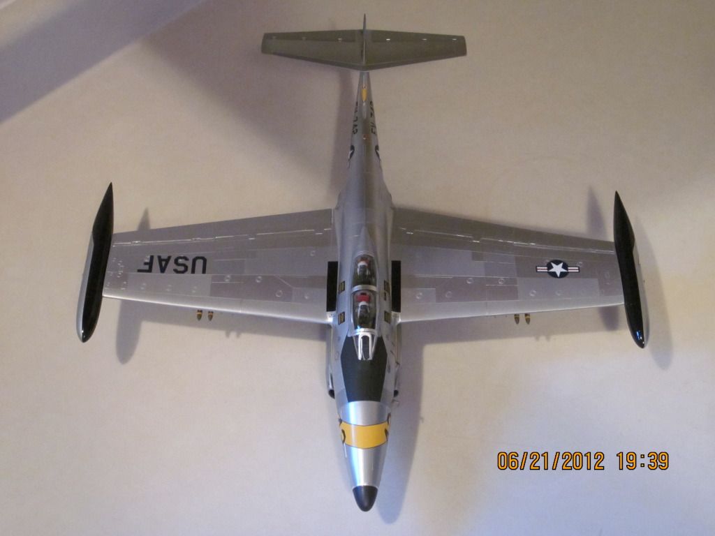

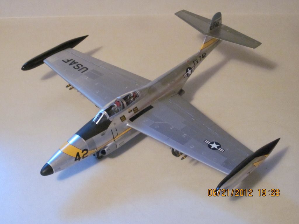

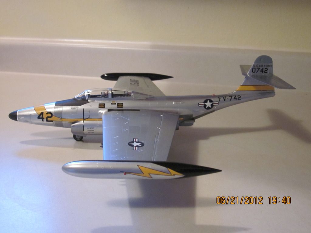

Thanks for the kind words guys! Mike, I’ve never been one to rescribe so no, I didn’t do that on this kit. I actually did an extremely light sanding of the lines before I painted. I didn’t want to eliminate them, just tone them down a tiny amount. Otherwise, the panels were simply highlighted thanks to the help of low tack blue painter’s tape to help me pick out individual panels. Not a single bit of paint lifted off with the tape!
I’m not sure about the rest of you but sometimes, for me anyway, I’m more lucky than I am good. On this kit, I think there was a bit of luck at play and I really surprised myself on how it turned out.
The Monogram F-89 was a great kit to build. I’ve got some more aftermarket decals leftover so if I ever see this kit again on the shelves, I’m going to snap up another one or two. The kit pulls no surprises and makes for an extremely pleasant building experience. It’ll take up a bit of room on your shelf seeing as how the real plane is quite large. I had it sitting next to my 1/48 Monogram F-80 and the Scorpion looks like a giant compared to it.
Eric
