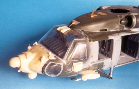

Yes, I found out the kit I bought “short shot” two “unused” parts. One of them was the K nose. The instructions tell you it is unused and has you install the L nose. The instructions are incorrect. I have a replacement part being sent to me. Should be here Friday. Already removed the L nose.
The sensors above the canopy are part of the photo etch set. I have not put them on yet because the top windows need to be installed first and I have not put the clear parts on yet.

That sucks. Cobra Company did sell an MH-60K conversion set in 1/48, #CC48002, but they are now out of business. Lone Star Models bought CC’s masters and is slowly releasing them, but the MH-60K set is not currently on their site. Keep checking there or maybe drop them an email to see if/when they may release it.
Lone Star Models: http://www.lonestarmodels.com/store
CC Set:
Good luck.
So here is where I stand, Lone Star Models does not know when it will get to the MH-60K set. I contacted them. I found out that Italeri stopped molding this part. Many modelling friends on Facebook have looked in their MH-60K kits and the part is missing. The kit was released back in 2007 and the kit did include this part. It appears that sometime around 2012 Italeri stopped molding this part. It is the only part that is not in the kit.

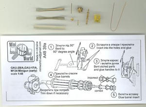

On the MGs, all 160th SOAR helos mount M134 miniguns, not M60s as the kit would have you add.
CMK and Mini World both make 1/48 M134 minigun sets.
Hello!
I have used 1/72 Mini World miniguns and they were amazing, very detailed and they are cast brass. Exquisite stuff, but pricey, too. That could be a reason, why you might want to consider the CMK set.
Good luck with your build and have a nice day
