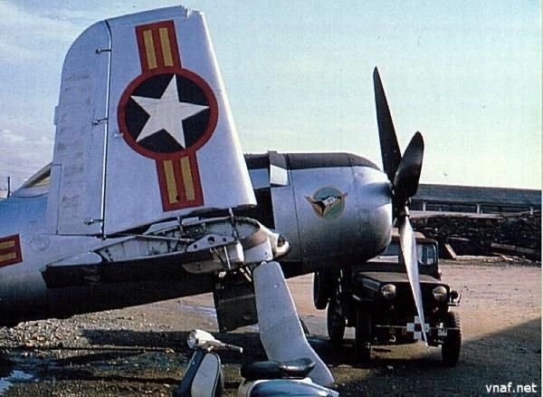

It’s one of their later moldings and is pretty nicely detailed, inside and out. Here is a photo of the real aircraft in the early 60’s

yeah, by the end of the 50’s, the remaining Bearcats we’re looking pretty rough.
