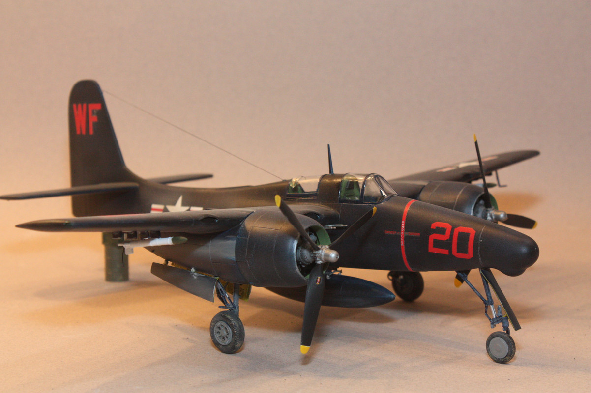

Like my P-61 last year, the challenge was trying to make this turkey look real, especially since pics I’ve seen show these were in really good condition. I used AK Real Colors Dark Sea Blue then did some minor fading and exhaust staining. I initially tried a grey panel line wash which looked absolutely awful, so I switched to an AK Paneliner designed for blue green camo, whch was a dark brown. I’m much happier. I did grime up the drop tank and painted it white for added interest. Overall, I’m happy with it.
