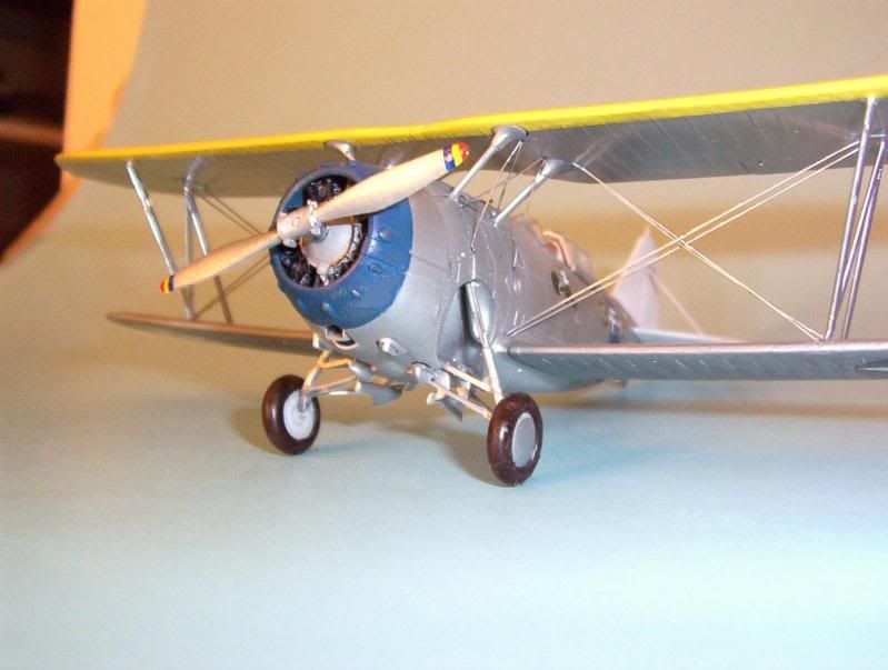

1/48 AM Grumman F3F-1 completed.
This is a great kit! Incredibly engineered and very enjoyable to build. My example is from VF7 U.S.S. Wasp ca 1940 during Neutrality Patrol in the Atlantic.
I screwed up on Aircraft #. It should be 7 for the leader of the 3rd section recognizable by the blue cowling and stripes. I don’t know why I put 13 on…[:$]
The only things added were an old .30 cal. MG barrel for the lefthand weapon and a brass tube for right hand 50 cal. MG blast tube. The radio antenna is invisable thread.
The only snags were with the PE rigging. The left wing flying wires were a bit fiddly. The landing gear was a bit fiddly also, but nothing really serious.
After building this wonderful kit, it will be tough to go back to Classic airframes “rough” engineered kits. [:P] I have alot of Golden age biplane kits to build…[Y]

As someone who has always steared clear of early planes (lack of skill) ,how do you attach the rigging wires with such a small glue area to it?
Theuns
As am I! The kit is dummyproof. The landing/flying wires are PE! There is no hassles, other than making sure there is adequate room for the parts; don’t fill the gaps with CE.
The radio antenna is invisible thread. That was difficult to attatch![6]

What were the colors you used, may I ask?
Regards,
Brad
Sure Brad. I used Testors non buffing aluminium metalizer on the fuselage. Steel for the landing gear struts. Tail was Tamiya Semi gloss black. The Blue was a mixture of Pollyscale Blue 23 and white 3:1 ratio.
The Wings were Pollyscale Orange Yellow, the lower sections were ATSF silver with SnJ powder. I used future on the upper top wing and lower section of the top wing and the upper section of the lower wing. I did not future the fuselage so to add contrast with the wing surfaces.
I did not weather it too much as these ships were kept in pristine condition. I did weather a little by the machine gun troughs and the landing gear wells.

I did this same kit a few mootns ago and had a litte problem with the gear struts not fitting well, had to reposition the wheel off-cente on that side to get it to sit level… Did you have that issue?
I did have trouble with the port strut not sitting properly. I don’t think I had to reposition the wheel though. It was one of the “problem” areas…[:)]
Mine was the right strut… If you look close, you can see how I had to move the tire…
