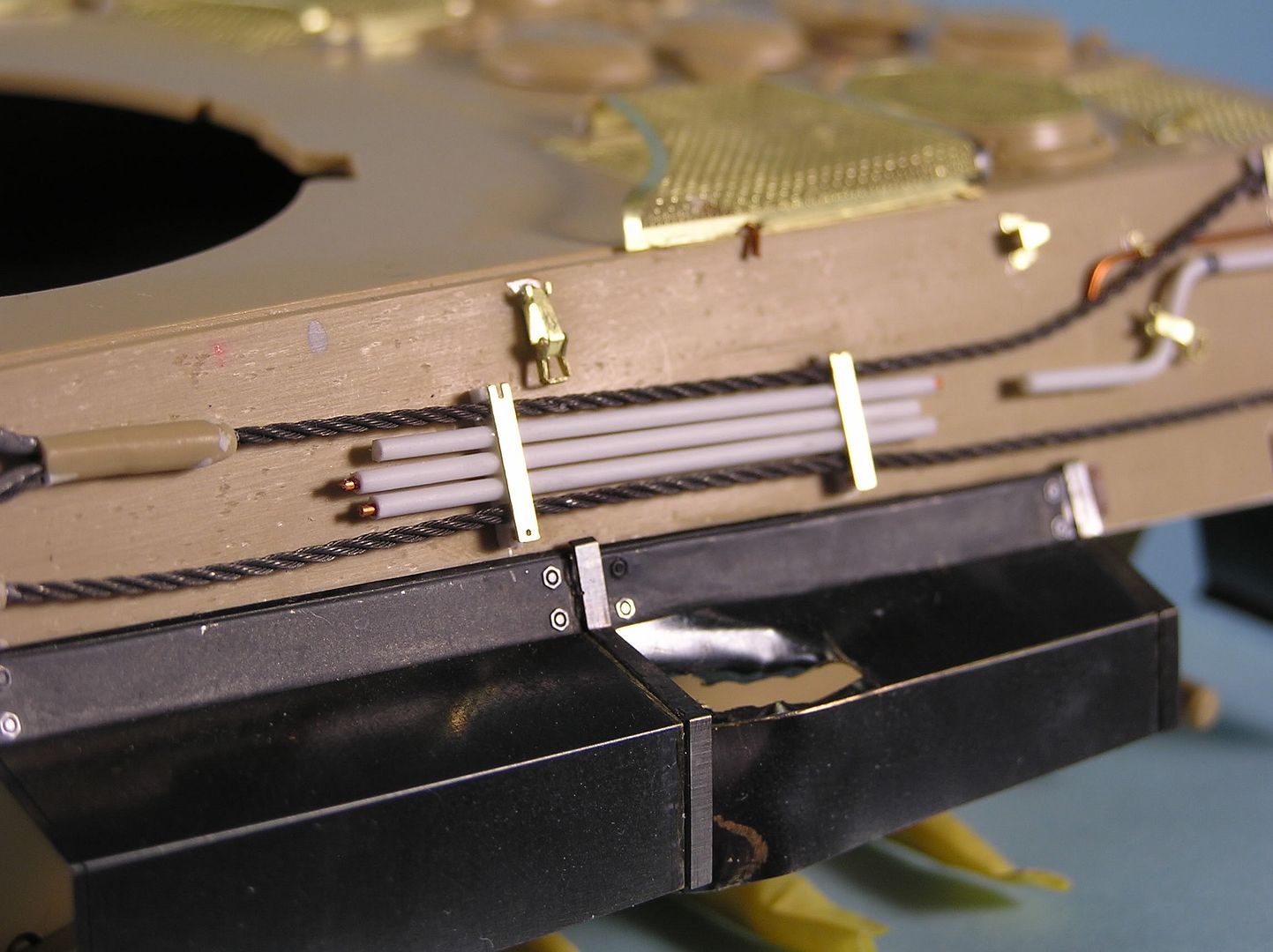

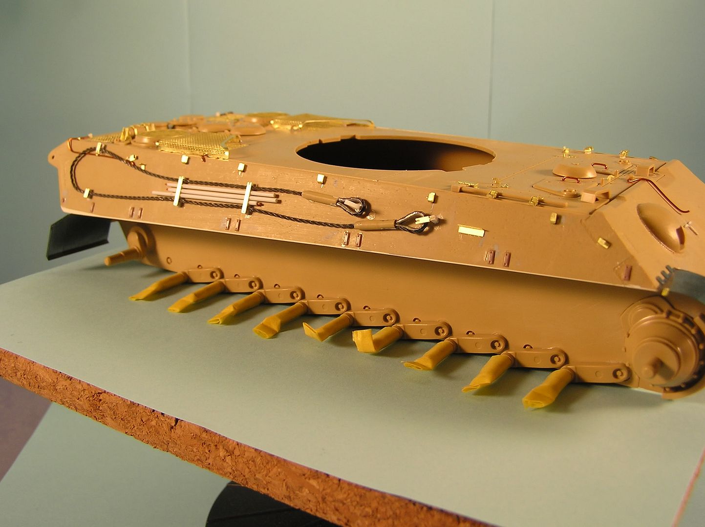

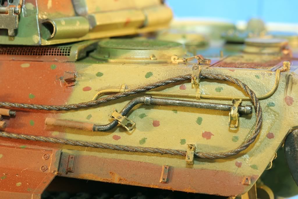

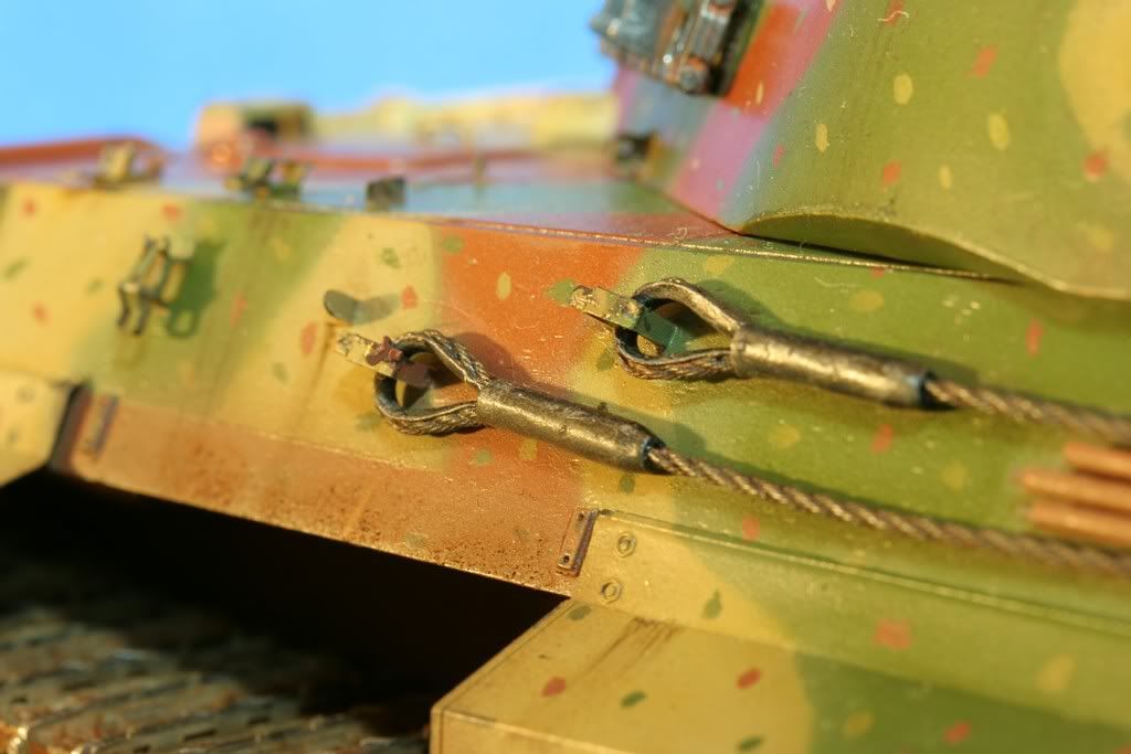

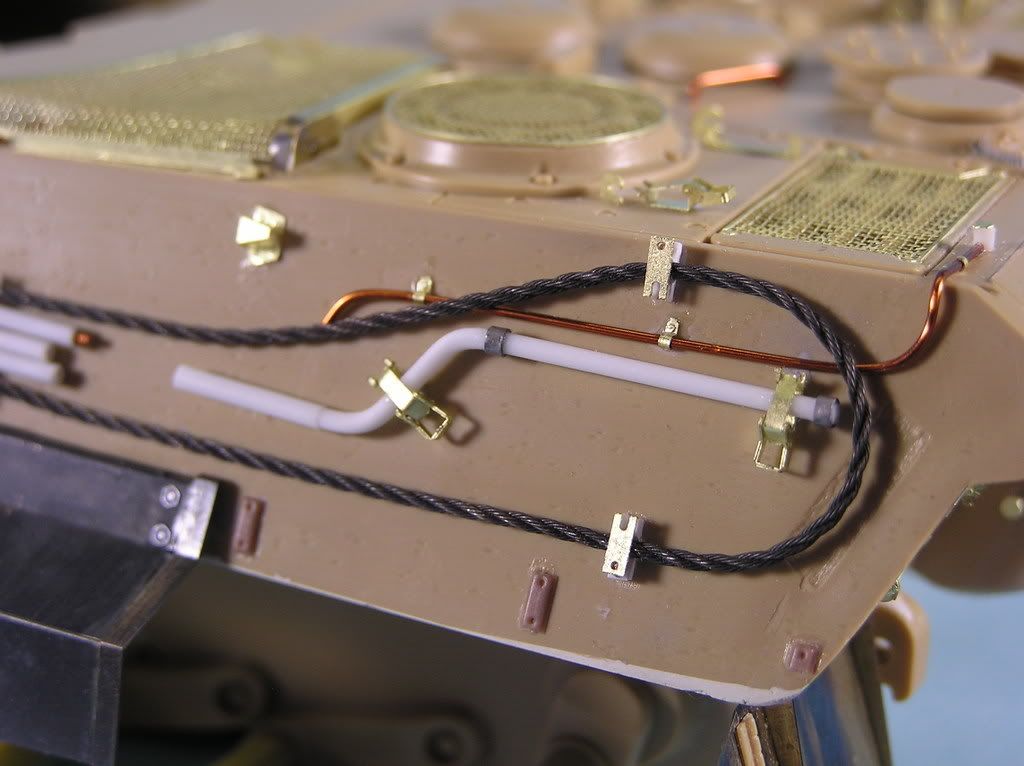

Here is how I did it on my Kingtiger.
The tow cables were made from plastic covered steel wire rope that I got from work. I melted the plastic off and annealed the wire with a small blowtorch. The cable eyes were made from a little piece of the wire and the metal on the inside of the eye was made from a thin sheet of lead peeled of the neck of an old wine bottle. Only the piece between the eye and the cable is from the kit part.
TMN1,
That is very nice work! [bow] me not worthy, me not worthy!
