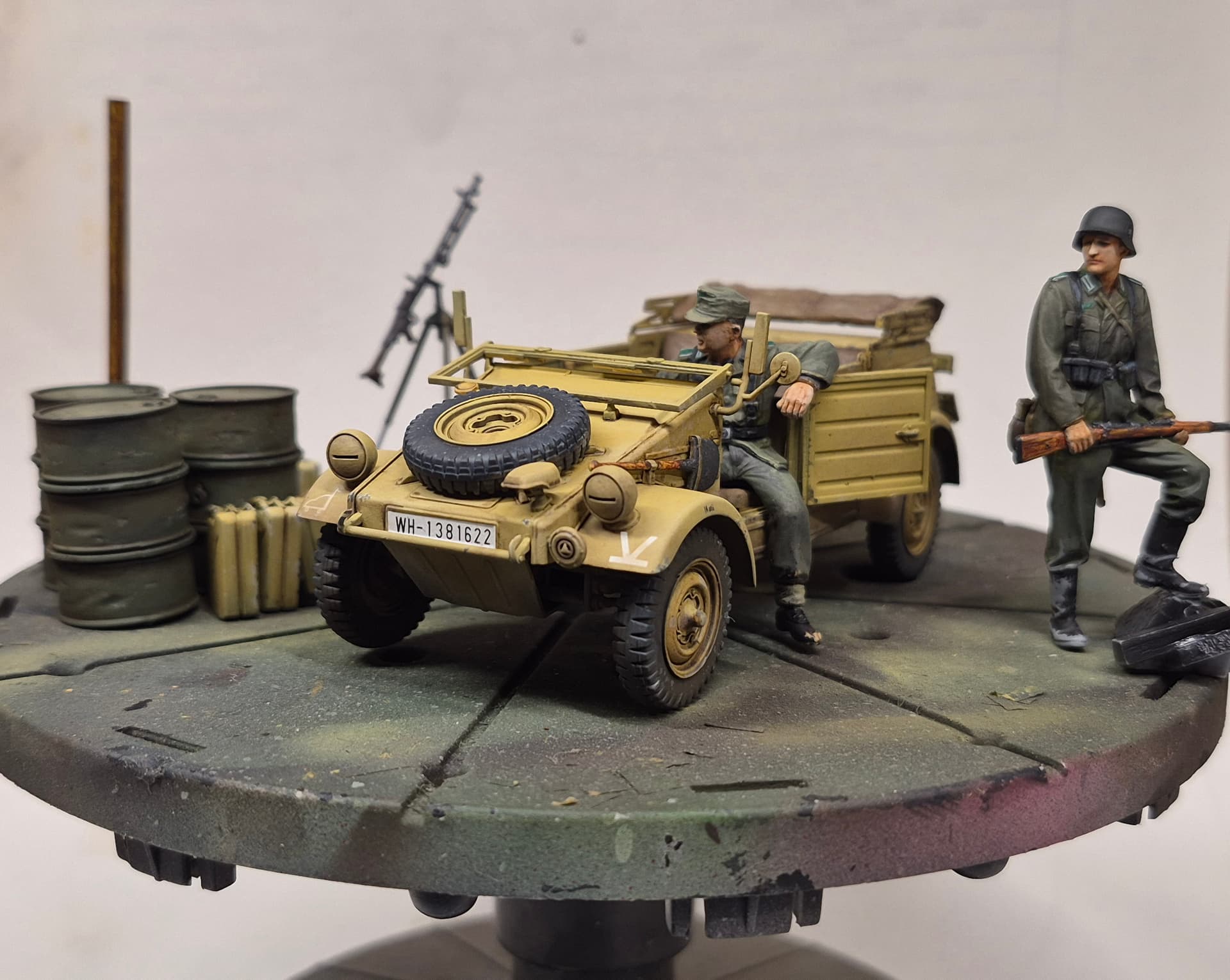

The Tamiya Kubelwagen is one that’s been in storage for awhile. It was an easy straightforward build. I used UV resin to replicate the speedometer glass and it worked great. After a quick cleansing with alcohol shot thru the airbrush it was primed with Alclad II and base coated with Vallejo US interior yellow followed by a post shading of Vallejo dunkelgelb. A spot of gloss coat was applied to decal locations. After the decals were applied and allowed to dry a Vallejo dull coat was applied to seal things up. An oil pin wash of burnt umber and black was applied to panel lines, hinges, embossed areas of the body. Again Vallejo dull coat was applied to seal this up before an oil mix of white and yellow ochre was dry brushed adding highlights. I haven’t used this technique for sometime. It was fun, but takes time to dry.

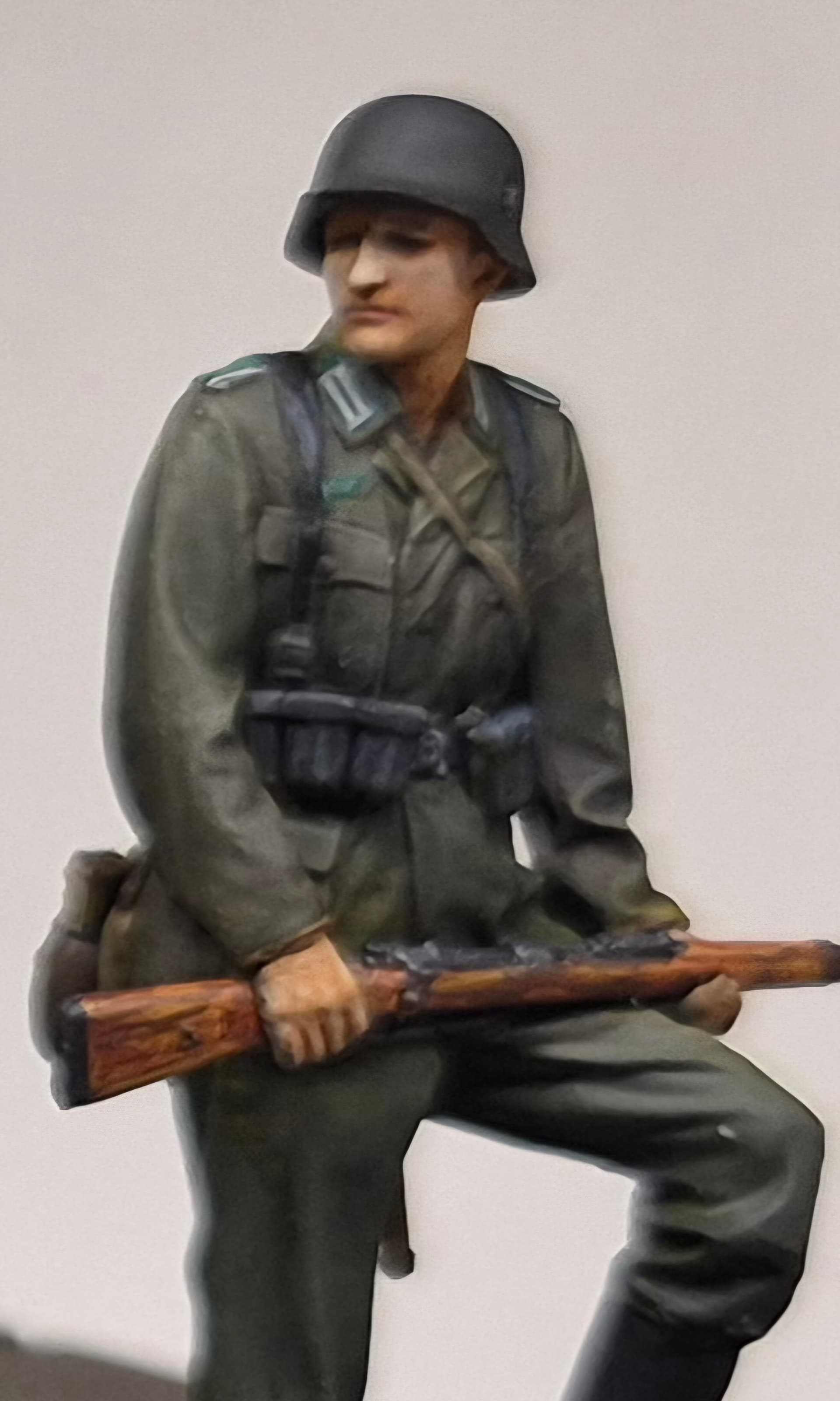

Both the driver and rifleman were primed with Alclad II then base coated with Vallejo followed by an application of a dull coat. Oils were utilized for shading and applied to flesh areas and the uniforms. When this dried dullcoat was applied again to seal everything. The uniforms were given an oil dry brush to bring out the highlights. The decals were added and I had some apprehension over whether they would settle down. They settled down beautifully.

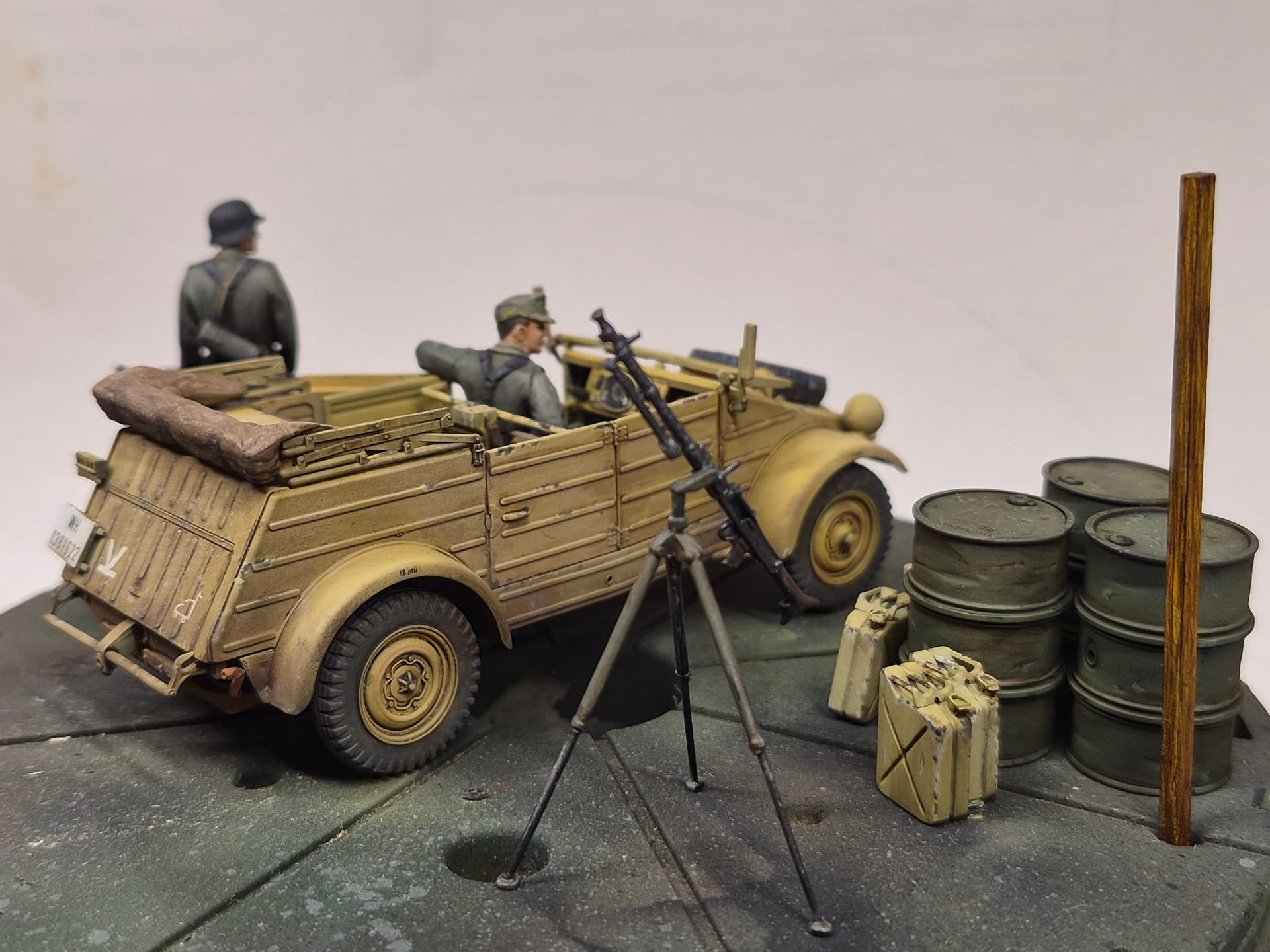

Added some barrels, jerry cans and an MG34 on an AA mount to get a feel for a vignette.

Great little scene,love the details and the figures.
Thanks Tojo, I need to get started on the ground work. There won’t be any big elevation changes, so it should be a quick and easy base.
Nice work on the vehicle and figures. Maybe a few ammo cans for the MG42
That’s a great idea, I have a few still on the sprues…thought about a few sandbags too.
Very nice paint especially the figures.
Thank you for the positive feedback. Painting the figures was a different approach that I wanted to try to see if I could get repeatable results with. The new generation of Tamiya figures are very good :+1:. Thank you again for the comments.
