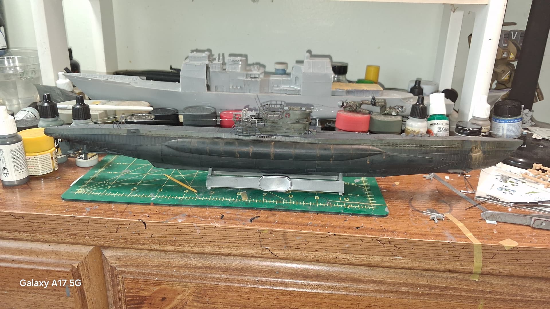

As far as the kit goes it’s not bad,going to add my own hand rails on the conning tower as there molded on.
It could do with a photo etch upgrade but not going to spend anything on it.
