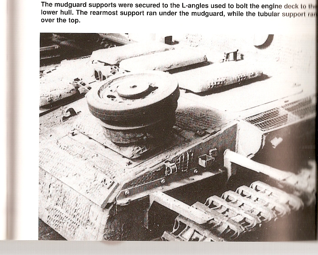

Heres a reasonable photo that i found. It appears to have armoured covers that go over the engine hatches which the kit doesnt supply.
…Guy
GOT IT! LOL! [:I]
Man…talk about a brain fart…I just recently built a StuG III with waffle pattern zim and they had zim all over the rear deck and superstructure as you show in this pic…so I take back what I said previously. Given that the StuG IV incorporated many of the same features as the StuG III, it’s likely it also had zim on the rear decks. I’m guessing the assmuption on the differences with the StuGs it that they have this huge blind spot at the rear that would conceivably allow an enterprising infantryman to toss a magnetic mine onto the rear deck and cause serious mischief.
Lufty, the armored covers you see here are specific to a StuG III, not a IV. The IV still had the engine deck layout of the Pz IV chassis, different arrangement from the Pz III chassis.
Thw whole reason for zimm was to prevent the mine from sticking to vertical surfaces of the tank, so there isn’t much logical reason to have it on horizontal surfaces since gravity would hold the mine in place…I have also seen the waffle pattern on some StuG engine covers, but never on the entire engine deck as the eduard pic shows…I wouldn’t add it if it were my build but that is a personal decision…

The StuGs were treated differently in this regard vs. regular gun tanks. Not sure if it’s because of their blind spot/lack of rotating turret, or what. StuG IIIs, especially those with the waffle pattern, had it over every surface except the superstructure roof and fenders. Given that it was done for the StuG III on a regular basis and the shared heritage of the StuG IV being built with the same superstructure and other features…I’d say it had a good shot of zim on the rear deck just like the StuG III. The engine access hatches themselves weren’t zimmed, the zim was applied around their outlines and to the armored covers.
Great photo, thx wbill. Still none of the IV’s though. Great looking III you have there. Is that for the Hunters build?
…Guy
Great pic…I stand corrected…pics of StuG IV’s are extremely rare even though roughly as many were built as Tiger I’s…most of these were built after the zimm ban in the fall of '44 so it might be hard to get a good angle of one with zimm on the rear deck…
Lufty, glad the photos help. As MR pointed out, pics of the StuG IV are hard to come by so you may not be able to find one of a IV with zim on the rear deck. It’s plausible enough though that I don’t think you’ll have a problem running with it.
