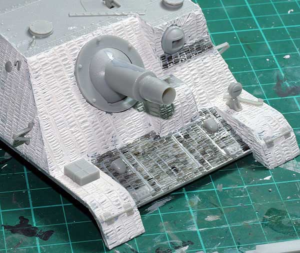

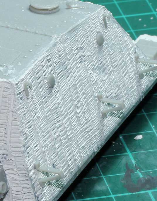

I’ve just finished Zimming my first AFV, like hermesminiatures and Tinkerer above, it’s a Brummbaer (but the Dragon late version). Seems a popular vehicle!
A bit of trial and error on which detail bits to stick on before and after, but I feel it’s turned out well for a first attempt. I pretty much followed Tony Greenland’s method in his Panzer Masterclass book.
First I used a rotary tool with a burr to roughen the surfaces and give the putty something to bite into. I then made a serrated comb from a 2" piece of .30 sheet styrene, one end was shaped to a 2-3mm point to use for individual indents where needed.
I used Milliput white two-part putty, and using a sculptors flexible knife from an art shop, I spread a side thinly with the mixed putty. For the whole process I wore latex gloves and had a bowl of warm water to hand. Milliput is only slightly irritant, but becomes very sticky. The water is very useful for unclogging hands and tools.
I then liberally wetted the palette knife and smoothed the surface, and then used the comb to make the marks. Thankfully my source pics for Brummbaers suggest a far less regular Zim finish than some other vehicle types, so I had a bit of flexibility.
On a couple of tight spots I used a variant on the hot knife method: a small screwdriver held over a candle for 6-10 seconds. Cheaper than a pyrogravure [swg]. This time gave enough heat for 3-4 marks at a time, without being hot enough to melt through completely.
If you try this, I can’t emphasise enough that you close ALL containers containing solvents and remove them from your work area. Naked flame and thinners/glue to not go well together!
I’ll try to add some pics when I get the chance. It won’t be quite as good as those above, but maybe you’ll find it helpful to see a first effort from a n00b!
