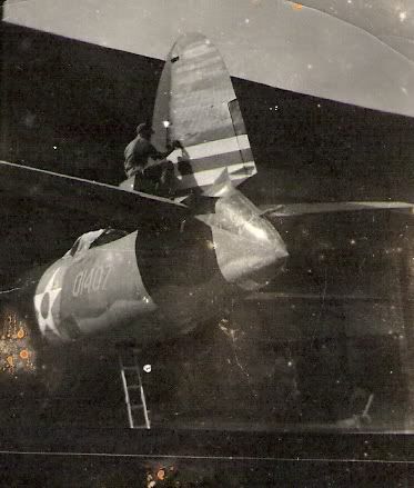

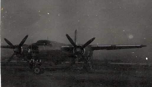

Have to give Ray another little “shock”. I know the 22nd BG were the first B-26 Marauder in the Southwest Pacific. Here are a few of Dad’s pic’s. He developed and printed them himself is the reason for the poor quality. He was initially assigned to the 81st Air Depot Group in Brisbane, Australia.
Shot of them painting out the early red and white tail fin stripes. You can see the yellow “tail number” on the side of the fuselage.
Shot taken from early P-40 of B-26 taking off.
