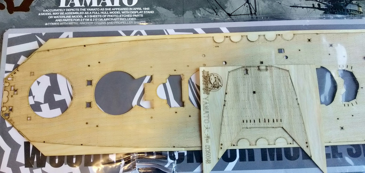

it will be mostly OOB , I did get a wooden deck for it ,

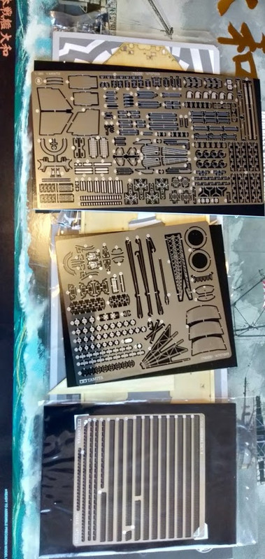

there is a bit of PE that comes with the model , I did get the railings for it , don’t know about them , look’s like a 1,000 pieces .

got a bit done , even though us modelers know these bits of PE , wont be seen , we still put them on .

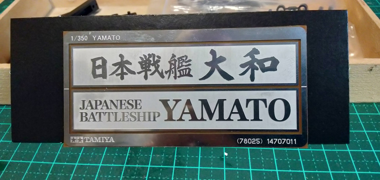

forgot to show the beautiful nameplate that comes with the kit.

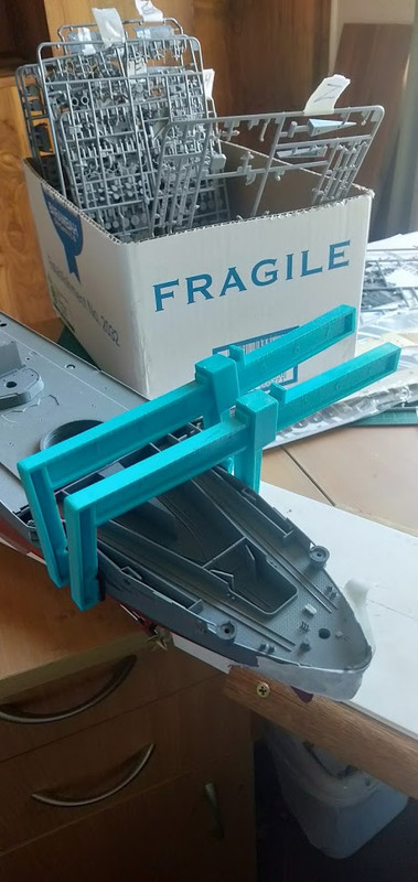

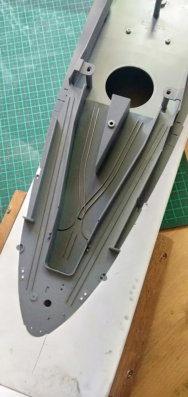

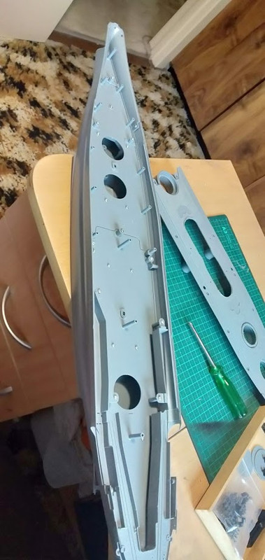

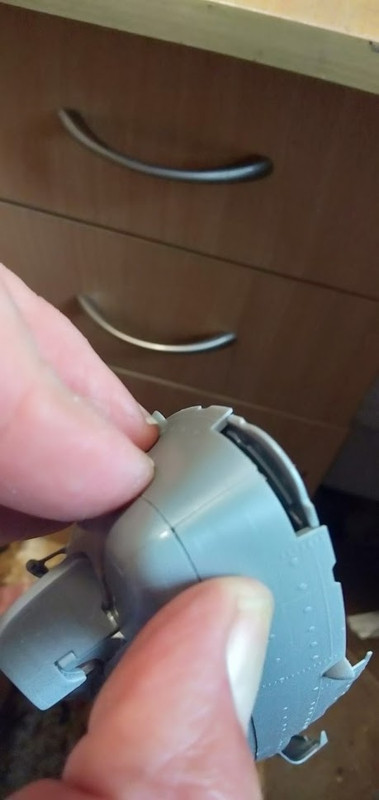

the fit of this kit is great so far , typical tamiya . the bow section is just sitting there .

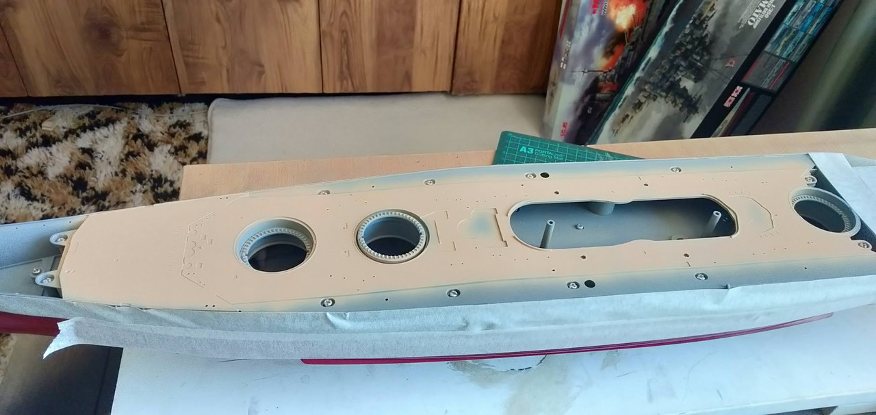

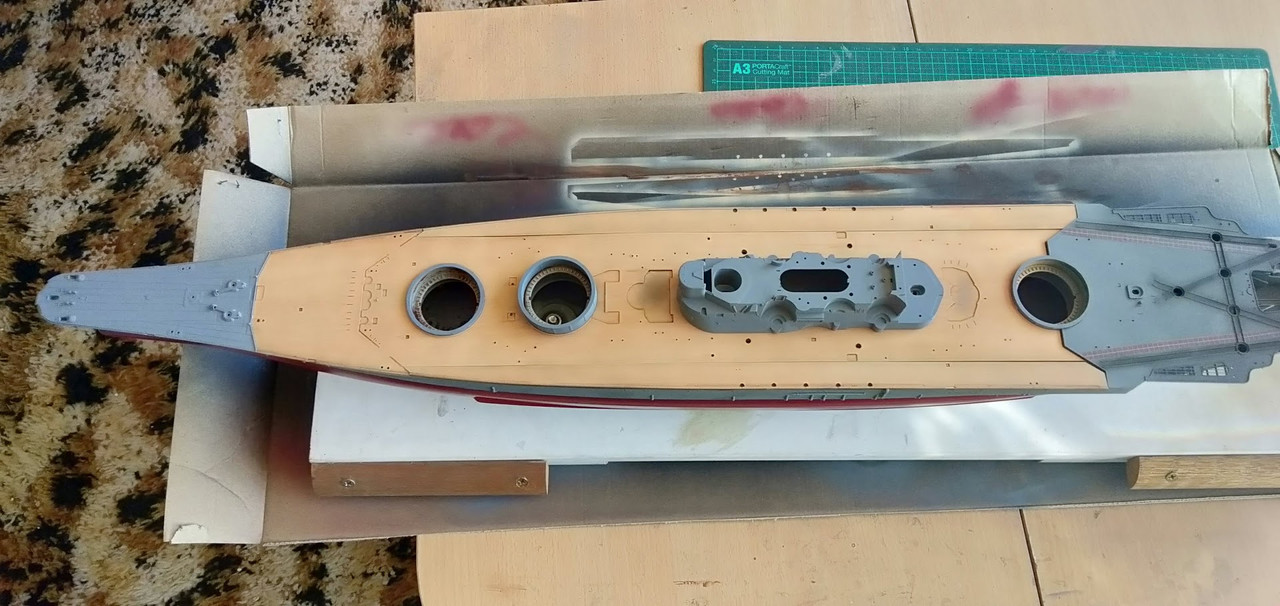

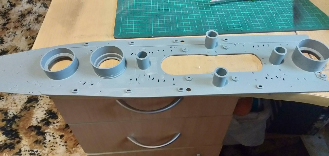

test fitting the false deck

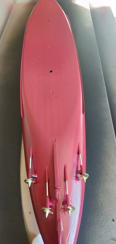

glued some bits and pieces under the maon deck . off to brisbane tomorrow for some supplies .

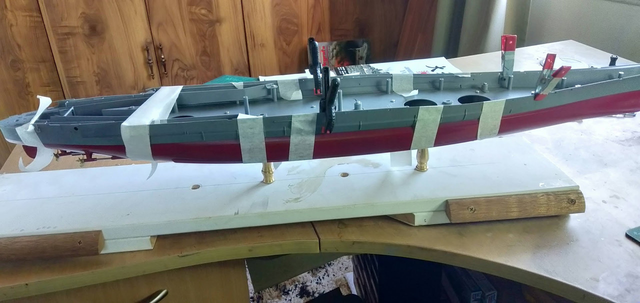

got some mr hobby no33 russet , doesn’t look too bad . at least I was able to start it .

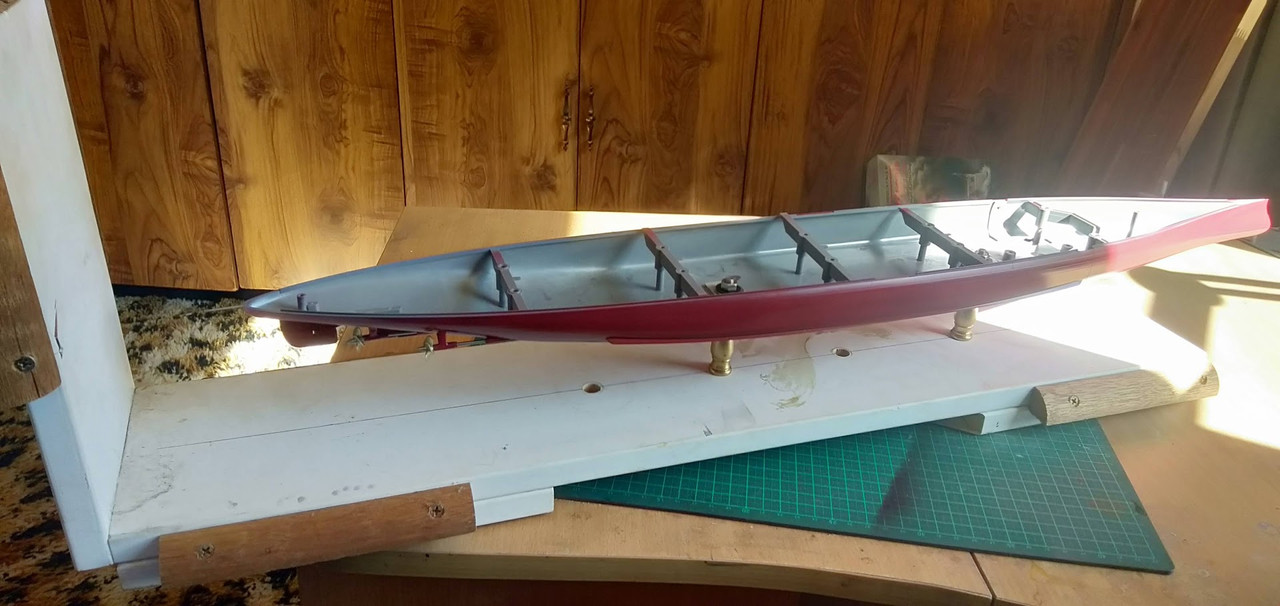

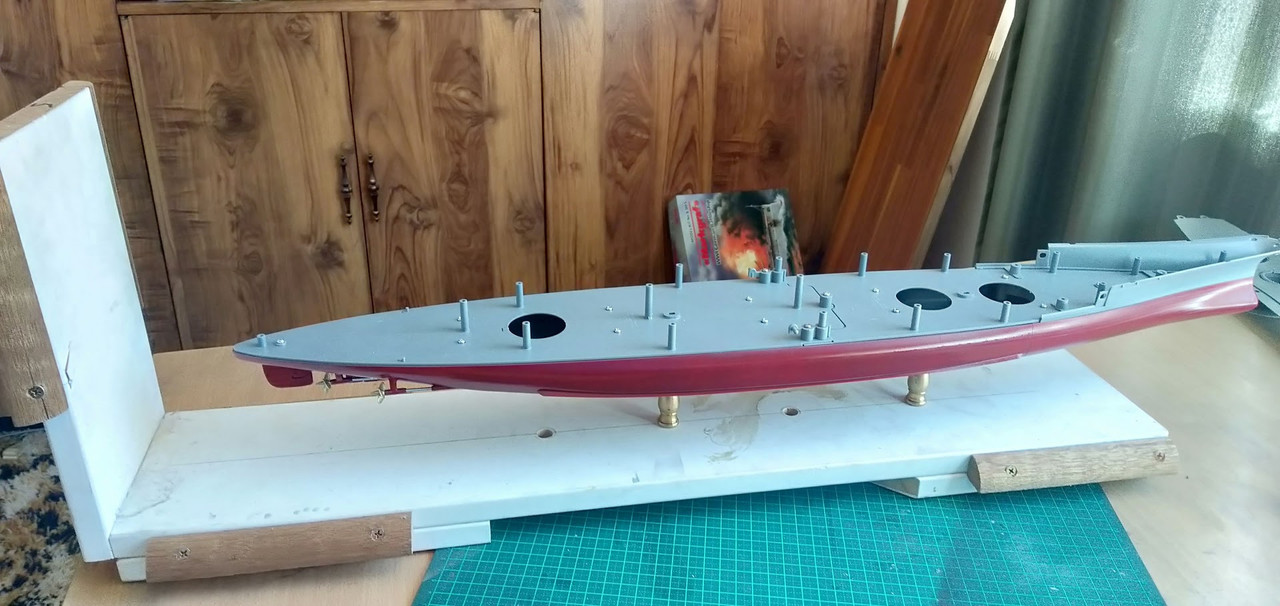

also got it mounted on a work board , which bill show me how to do .
the false deck is screwed down

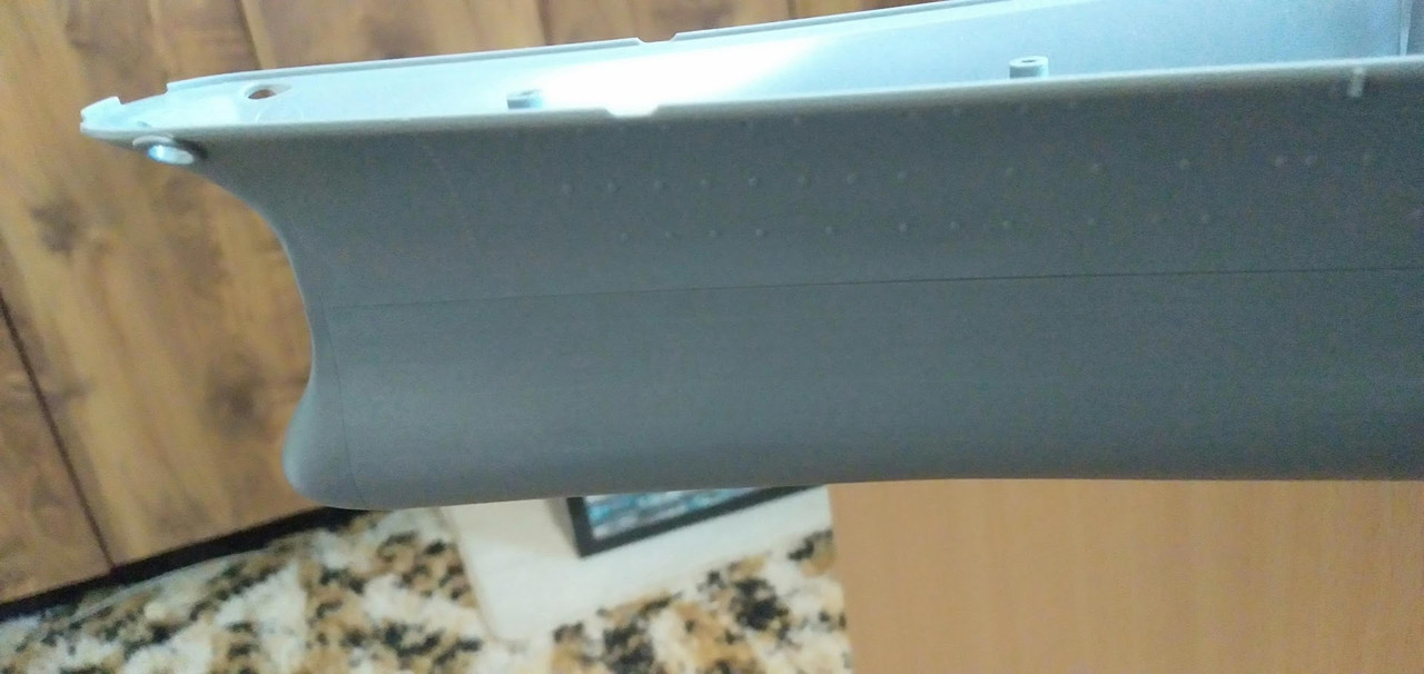

on another point , a bloke on anther forum , has pointed out that the stern of the yamato model is all wrong . it should be a flat triangle shape , to allow for something called a hein matt , for the retrieval of the sea planes , also the deck hung out over the stern . is this worth the effort and possible stuff up , guy’s .
I’m in the middle of building her myself and I decided to let it be, not brave enough to tackle such an operation myself. The model at Kure does represent the ‘triangle’ shape you are speaking of (instead, as you mentioned, the kit demonstrating the typical rounded boattail)
thanks silly me , don’t think i’m brave enough either ,

I wouldn’t change anything,
Remember the ship did go through some changes before the time she was sunk. Maybe the model reflects ( Your’s that is) the last stern she had. My old Nichimo model had the stern like on the photo. I have seen it in model form in 1/700 both ways.

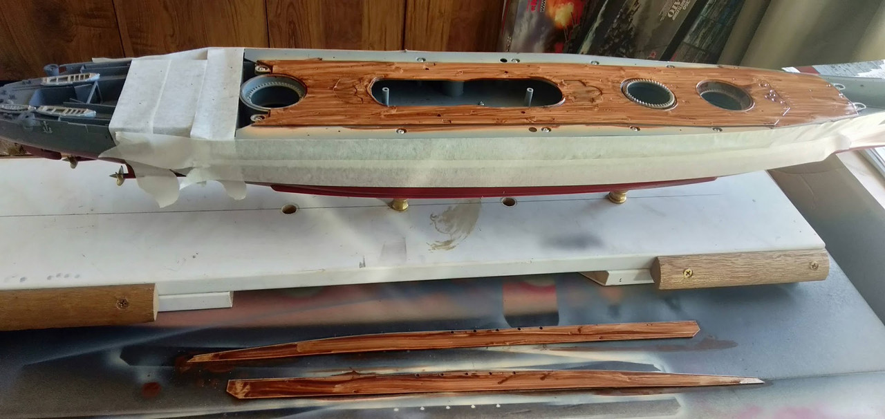

I had a wooden deck for the ship , it was just rubbish , very thick and wrinkly . so I just painted it instead , First a layer of MM light tan , then a layer of gloss .
then a layer of burnt umber oil wash .
then wipe off with clean tissue’s .
I’m not sure how to weather it , does anyone have any suggestions , please .
That’s some attention to detail at masterclass level, to be sure.
The weathering of the superstructure is a bit over-done, though. Yamato had 2700 crew who spent a lot of time in port and with the pride of serving on a Fleet Flagship.
Everything within arm’s reach would have een clean painted or polished to within an inch of its life.
Plenty of debate on whether Yamato’s wood deck was painted for war service or not. Or if it was more of an oiled Teak color rather than Japanese cedar–that’s modeler’s pick, really.
Watching one’s references for where russet linoleum was put down.
