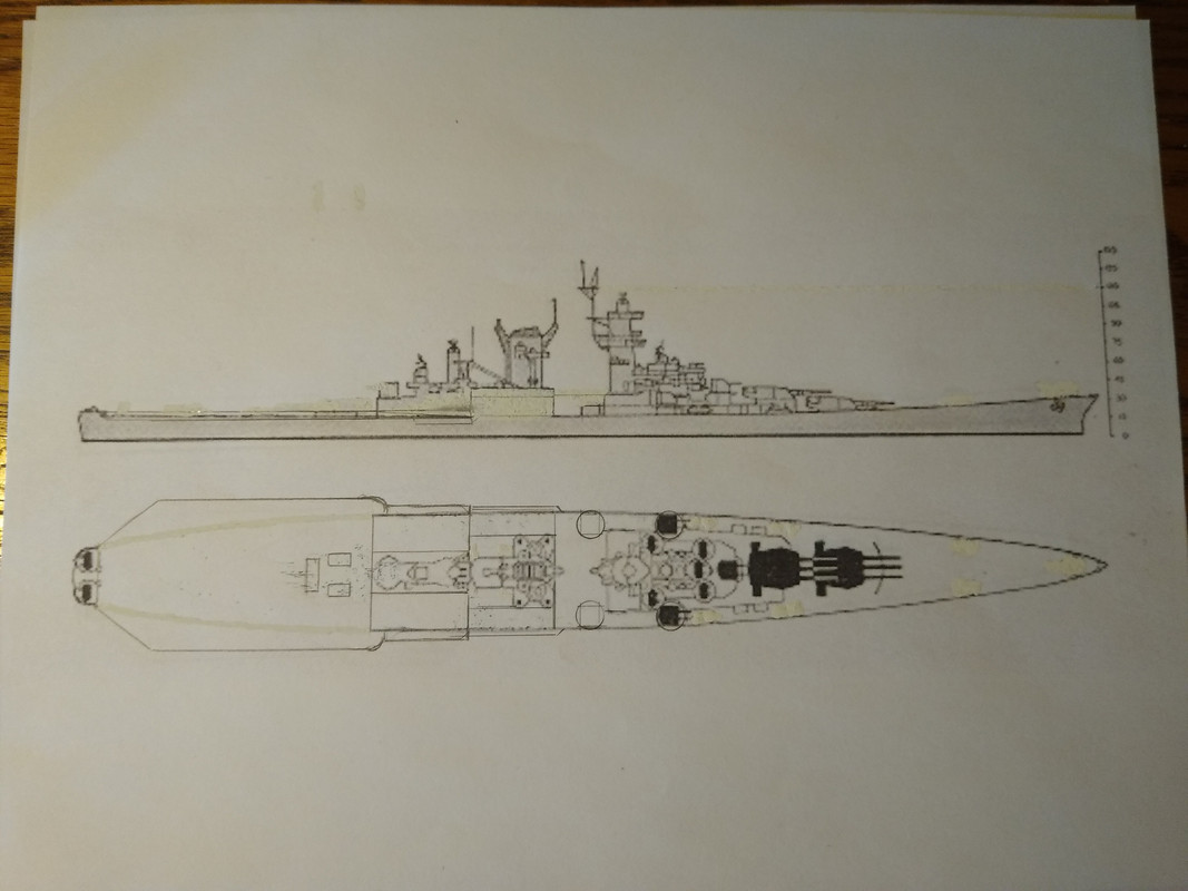

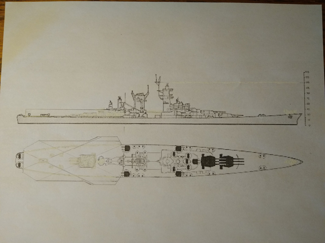

I’m thinking maybe lighter deck, primarily spotting / observation aircraft. The Alaskas were rated at 31 knots, maybe a large scout cruiser. Decent armament, good speed, larger than normal aircraft capability. NGFS + mid to long range eyes + speed. Something to think about. Then later, Harpoon + Tomahawk + CIWS + 12" hi-cap + Helos or STOL + lower operating costs than a BB. It could have worked, I think they may have retired them too soon.

As for a ‘modern’ conversion, here are two concept drawings I’ve been playing with.
If I pick up a 1/350 Alaska, I could use some of the pieces / parts I have from a Tamiya New Jersey (1990’s version) that I never finished.
