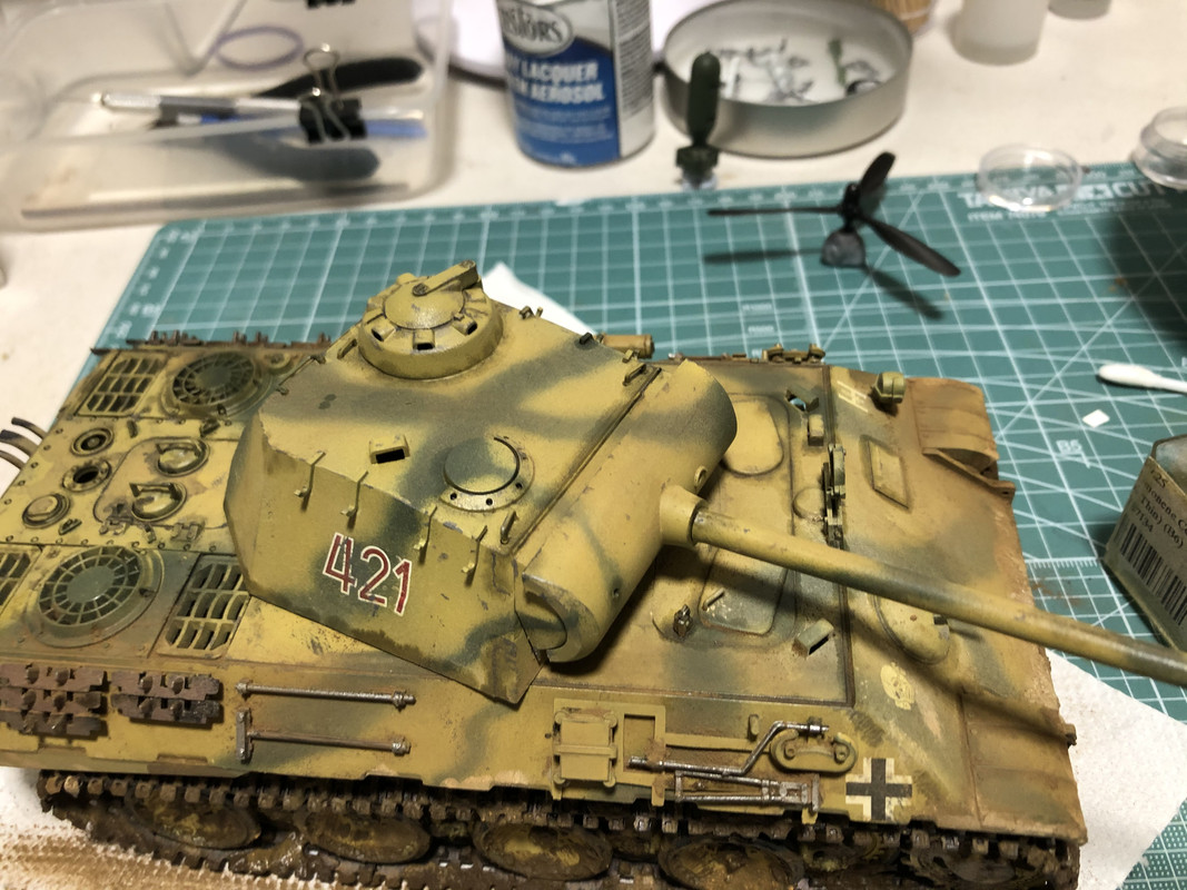

Hi all, I found this Panther kit to be sub-standard for a Tamiya. I guess it must be old. A lot of fit issues and very vague or missing information in the instructions. So, I decided it was a practice-only kit, which freed me up to try new techniques without being to precious. I hope to approach all kits like this now, and let fate take its course.
Can’t figure out how the spare track links fit…anyhow, here’s what it looks like so far. Still gotta weather the wheels, and make the tracks sag. Ideas on the latter please?

You did well with it so far. There is a lot of room for improvement, but don’t stress it. Most of us have built this kit at one time or another. As I stated above I upgraded and scratch built some stuff, tried new ideas, and added a commander.

Looking good! The kit is rough because it was the first kit Tamiya ever made and dates to the early 1960s. I agree that it’s perfect for experimenting on and incidentally, I’m using the same kit to tinker with DIY Zimmerit (which is something the kit needs because all but the earliest Panther As had Zimmerit).
As for track sag, short of using aftermarket individual links which can double the price of a kit like this, the best trick I saw is to drill a hole in the hull at a point where you can insert a spar to hold the track down. I did this for a Tiger and used a piece of brass rod. It looks pretty good, just use some extra thick mud or whatever to hide the spar between the track links.
IIRC the spare track links go on the small strips with the pairs of bumps, and get mounted at the aft of each hull side.

Hi Dazz. I know of two tricks for getting the sag. One uses cotton through the sprocket holes in the track. Basicaly, you thread the cotton through the top and bottom and tie it off, hiding it behind the road wheels. The other uses a cut off sewing pin. Hold the track in place, heat the end of the pin and push it into the hull. When it cools, the track will be hald in place by the pin. Then just a bit of touch up paint and Bob’s your uncle! I have used this many times on rubber band tracks and its never let me down.

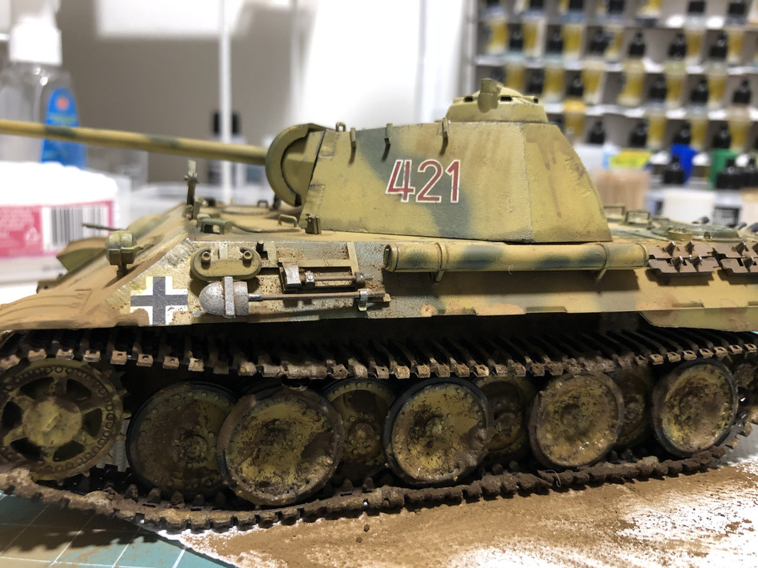

Well, I believe I’m done with this “practice Panther”, as I’ve come to call it.
I had fun and learned a lot without being too precious about it. Critique away please, I’m keen to know where I can improve.

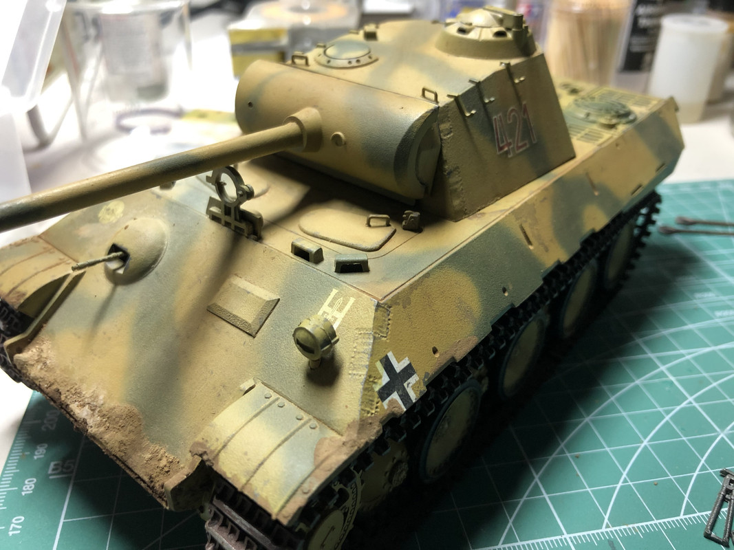

Oh that’s neat! Nice job with that vintage kit. Did you use pins or tie down the tracks to keep them from floating? And you got the spare track links right where they belong.

I especially like the dirt buildup around the fenders. Nice touch!
nah, I was lazy and just used super glue (tarzans grip) in a couple of places. Seems to work okay.
