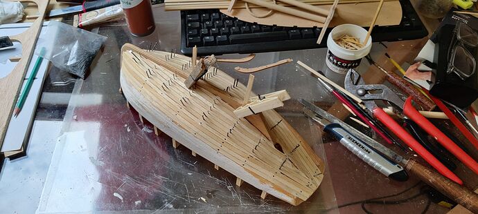

Anyway, I was a brat back then, went too fast and too rough at it, messed it up, gave up, never touched it again. Had been collecting dust in a drawer at my parents’ ever since, maybe, 1995? However my recent return to the hobby made me realize I could get this project back on tracks and work on it whenever I was visiting.

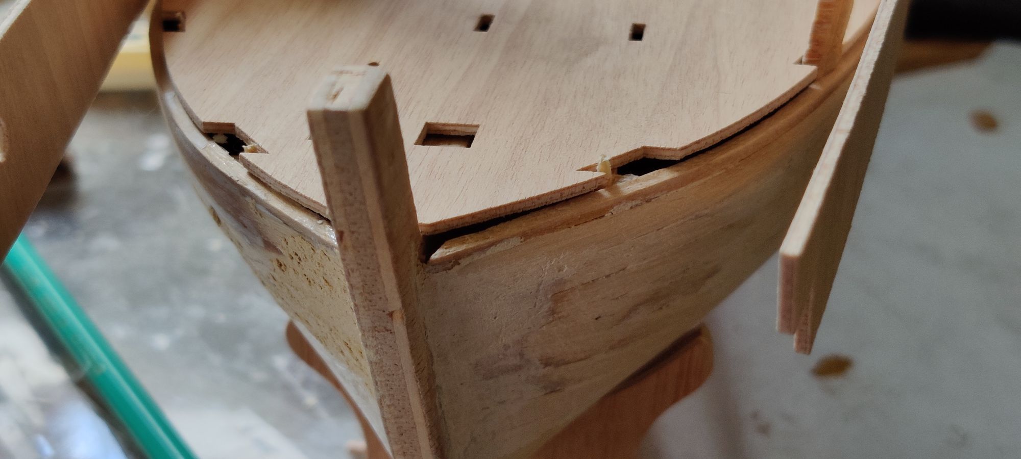

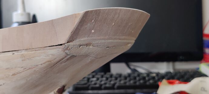

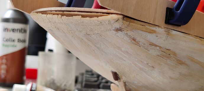

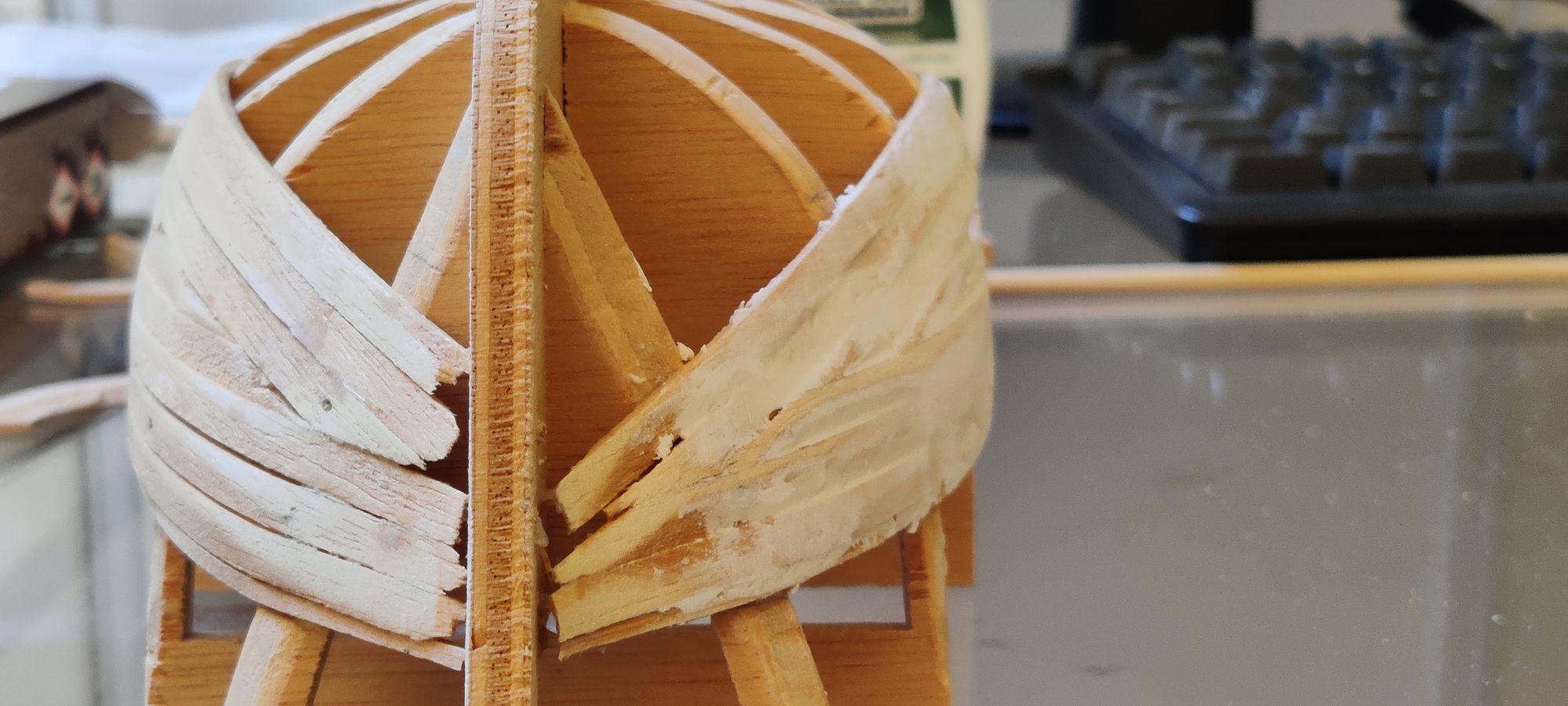

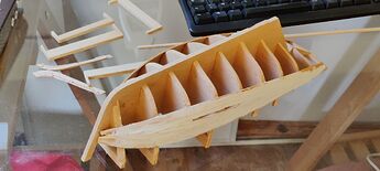

Not a happy place to start at. I messed up the angles on the bulkhead frames, which aren’t even glued perpendicular to the keel frame, which is even distorted. The planking doesn’t reach all the way to the bow stem either. There are holes, the surface is bumpy… Phew, a mess !
So I had to cut, fill, sand, adjust, rebuild… And resume planking.

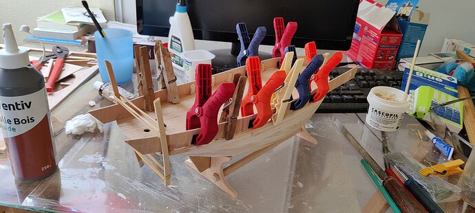

With no idea how to handle the stern exactly I went rogue and covered it with planks. Bad move. It’s better handled on the Artesania model, which provides one big single piece for the bulwark that extends from the hull to the ship’s rail. Heller sadly leaves you to bevel 1cm thick wood pieces and hope it will fit in the end. Ah well.

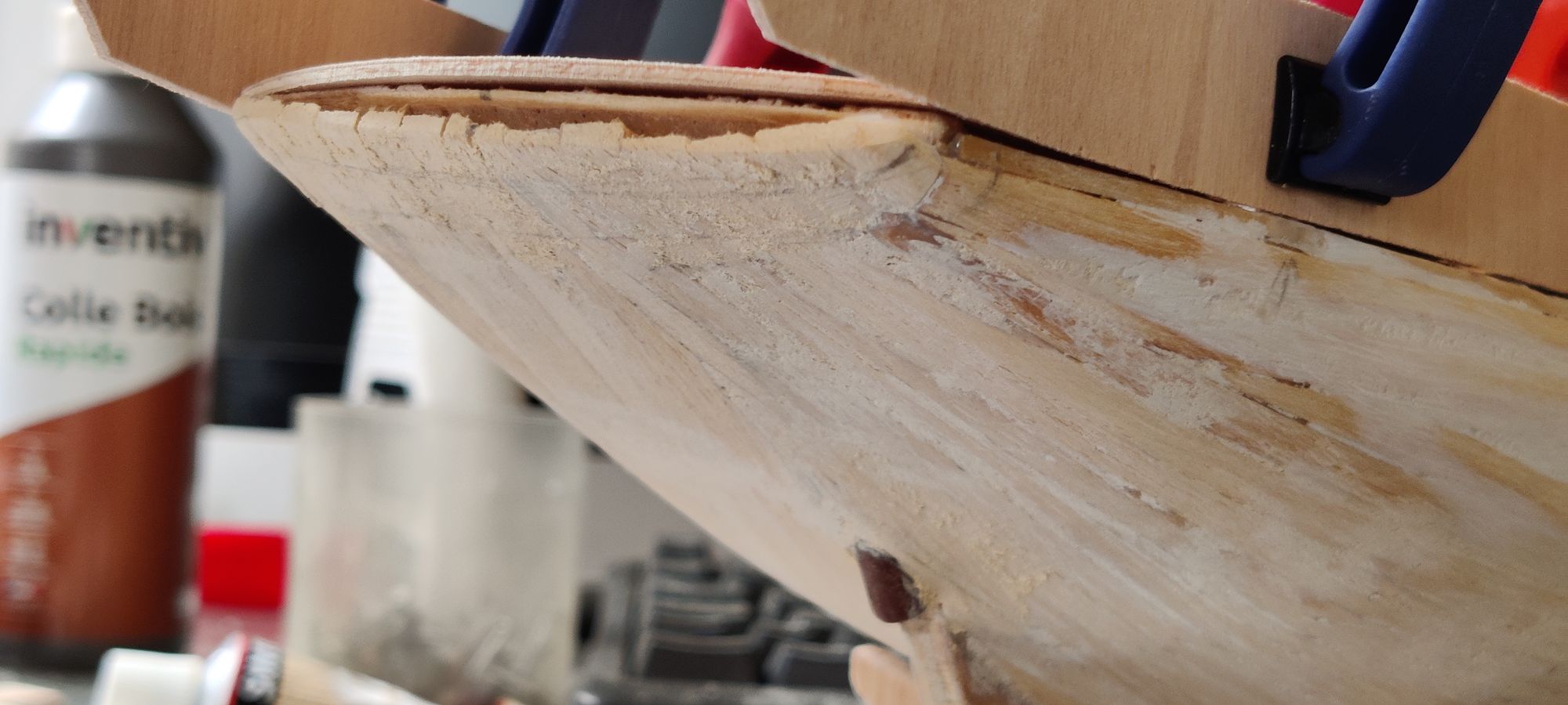

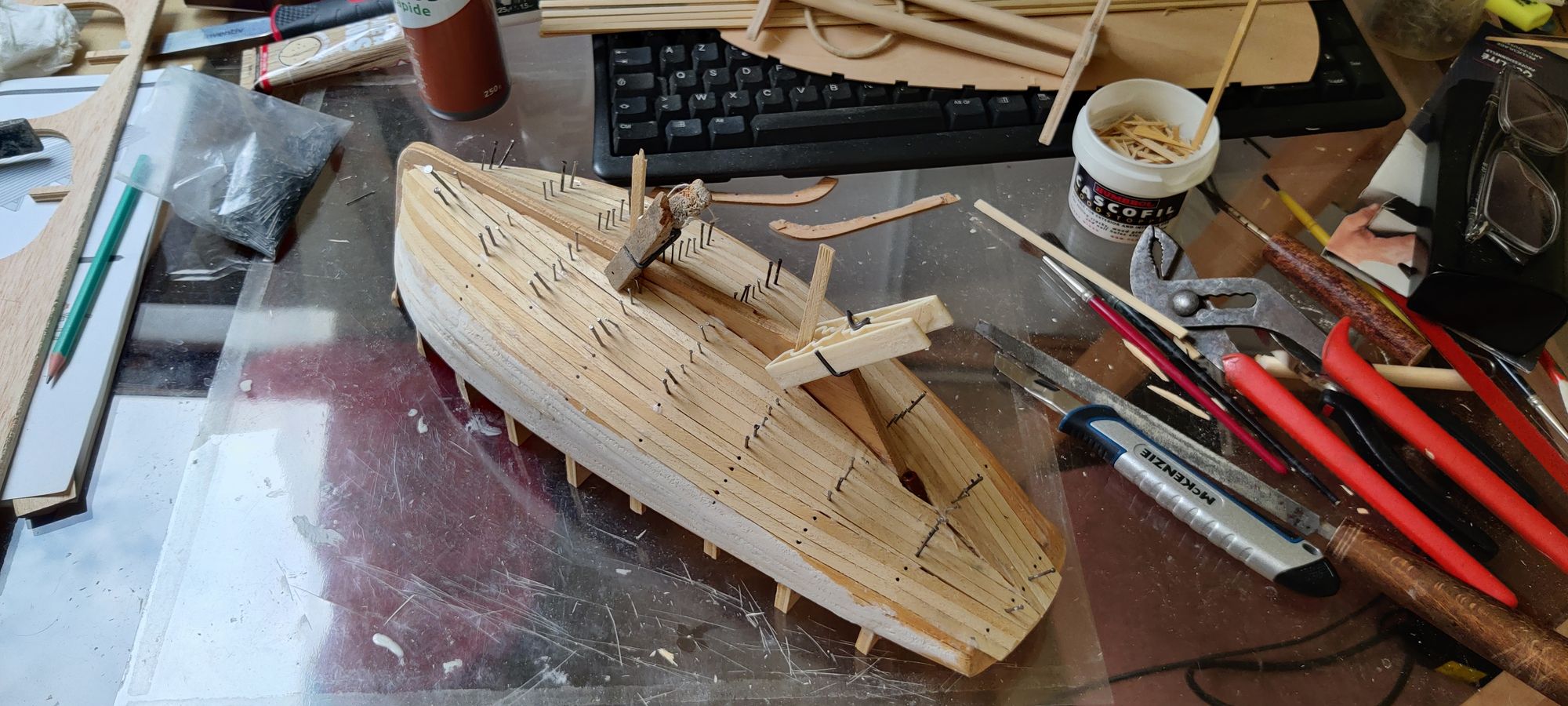

The stem ended up a mess too, and I had some terrible wood paste that wouldn’t mix to a proper “sculptable” material or stick to the surface. I hope I’ll get something better for my next session. Getting the rail in place worked decently enough, but the way Heller designed the kit makes the ribs extend over the deck ( much like the real deal apparently ) which also means it’s SUPER snapy and 7 of those little stanchions broke.

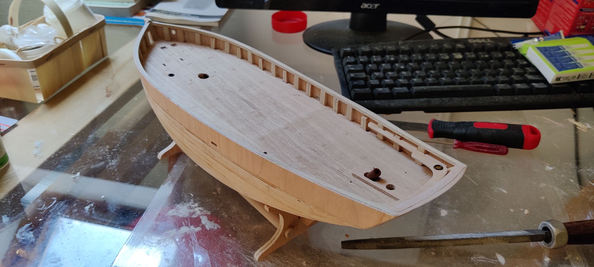

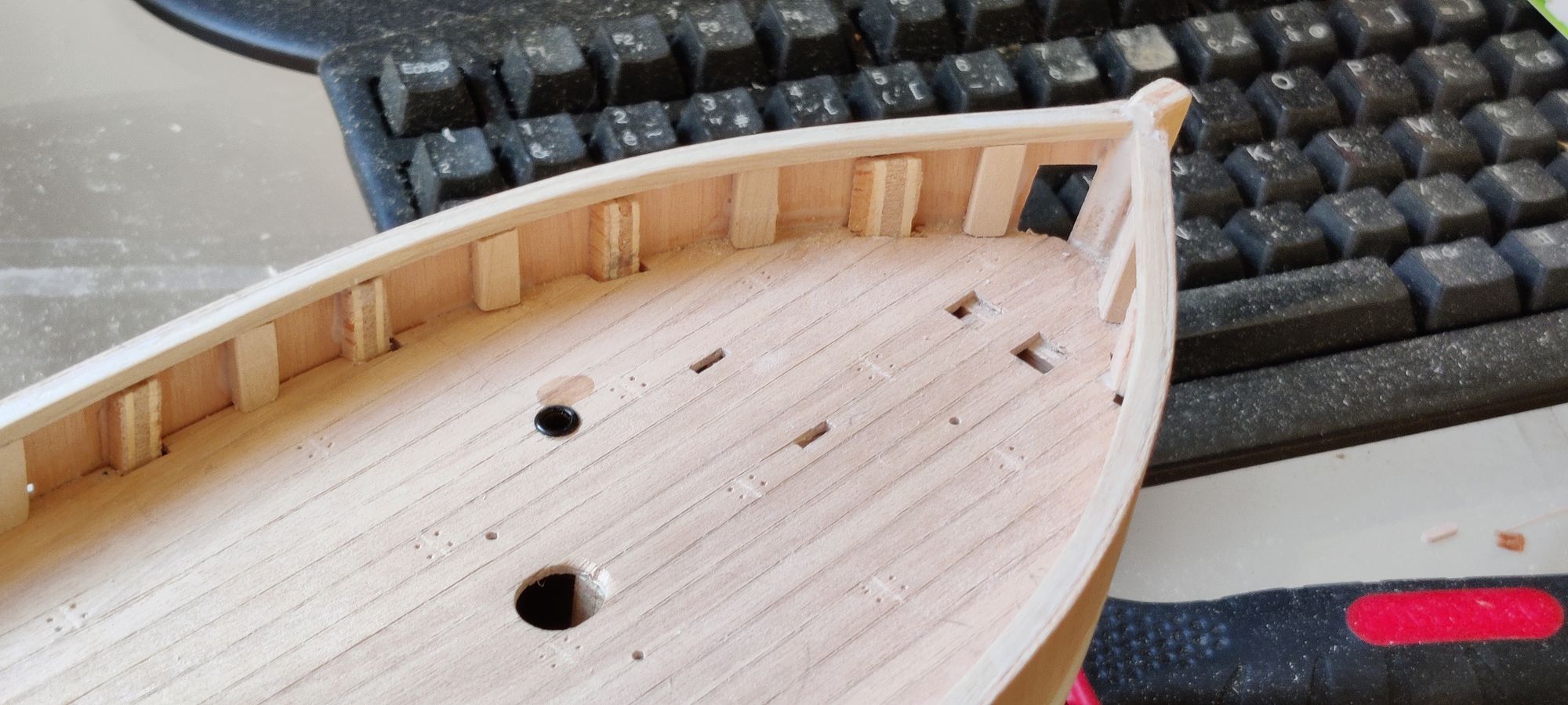

The deck itself was a pre-cut piece of flat balsa wood which had became pretty veiled. I carved planks and nails and did my best to straighten the thing.

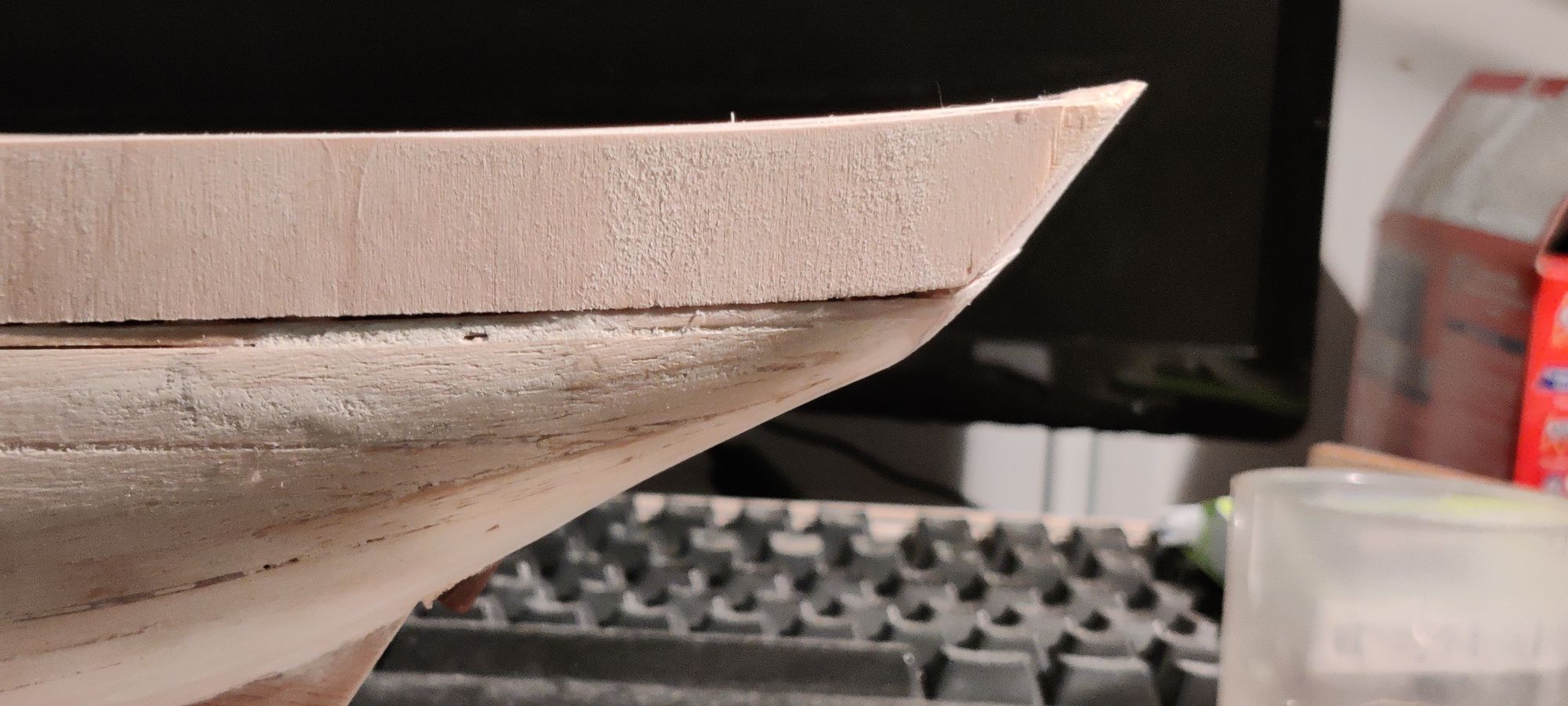

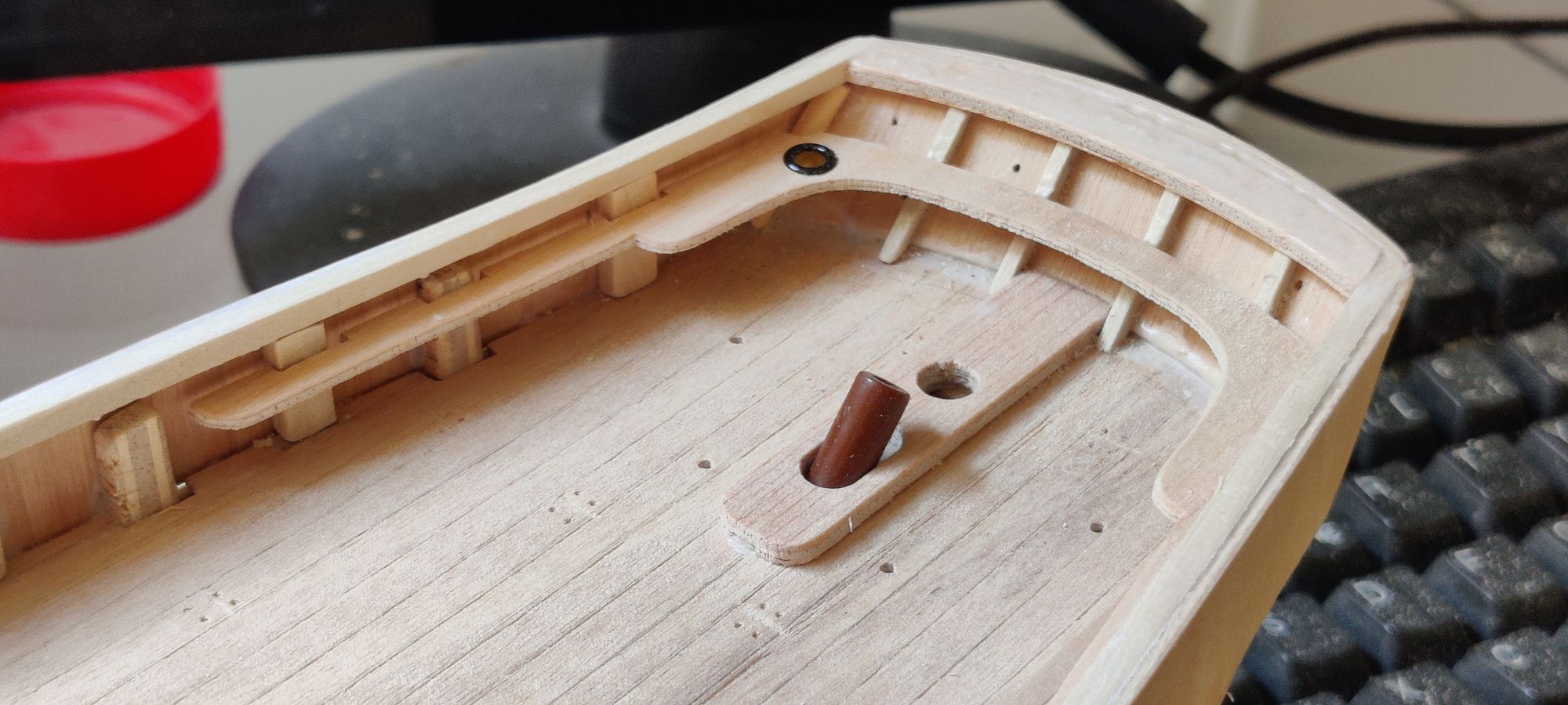

At this point I had a better understanding of what had to be done with the stern and the rear bulwark so … I ground away ! Yay !

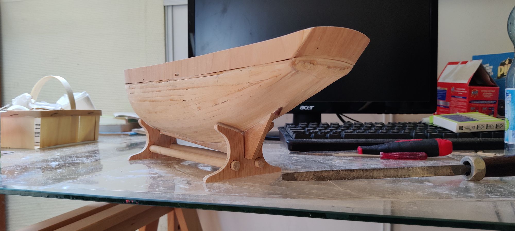

I will spare you all the errors and mistakes still waiting to be fixed ; this is where I ended up for this session. There are still a lot of unknowns. I have to find a good paste / putty that will go well on wood, if possible with a natural color close enough to blend in anywhere I’m supposed to leave it unpainted. Speaking of which, I wonder if there is some kind of wash that could be apply directly to the wood to make it look a bit older and stained and natural, instead of just applying Clear? The stanchions coming from the ribs have a “meh” texture, for example. For the actually painted parts, should I go with primer? Can I airbrush enamel, as the kit comes with 4 Humbrol paints? Funny times ahead !
