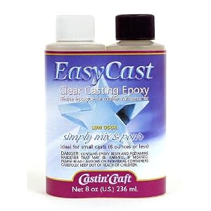

I ordered this stuff on Amazon ($10) since I didn’t want to spent a fortune on resin. We’ll see how this works out.
Thanks again everyone!
Let us know if you have any issues with bubbles when you mix and apply it. I’d personally be interested if casting resin is easier to work with in this respect compared to the Envirotex, since as I mentioned the only issue I had with Envirotex was getting rid of bubbles…no matter how careful I just couldn’t get the mix totally bubble-free, and endlessly poking holes into the poured window as Don describes is very tedious at best.
Also, I’d experiment on some plastic card or similar before actually using it on your model.
You bet! I’ve already prepped some scrap styrene that’s now waiting for its windows. And I’ll post my results here once I’ve received that stuff and tried it out. I’m really looking forward to that! [:)]
