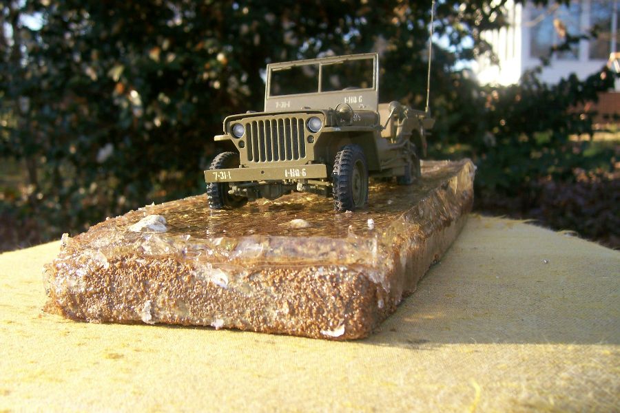

Had a GREAT test run with the Casting Resin
and I"m ready to get started first thing in the AM on the show nuff dio.

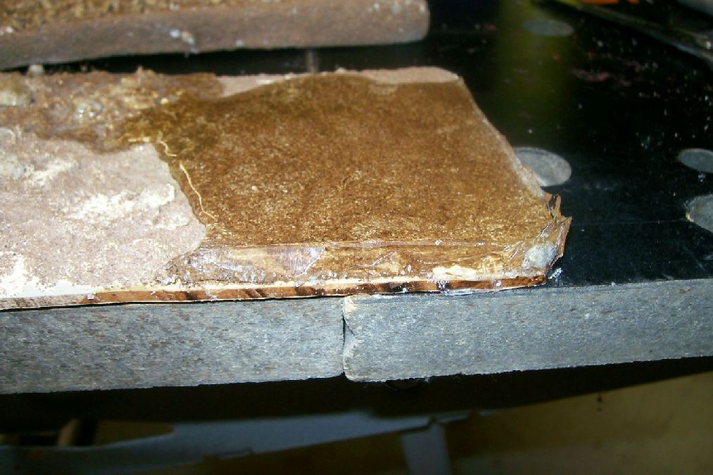

Well the resin is cast. Can only wait and see now. The stuff started globbin up on me, not sure if I didn’t have ratio right or not mixed well, Wish I could have had time for more testing and playing.
Here’s the damaged part…Just this corner is not hardening. I don’t know why other than my first try at this. It’s like jello goo
Another angle in the sun…
This is the good side. I believe what I will do is recast one more time using the same method but watch my ratios. Seems they want more hardener in the mix when the resin is thiner. Maybe I should have taken advice and done it in layers. As everything, patience is the key
We’ll give this a shot and if it craps out, well, To sears for a Tie for Dad…

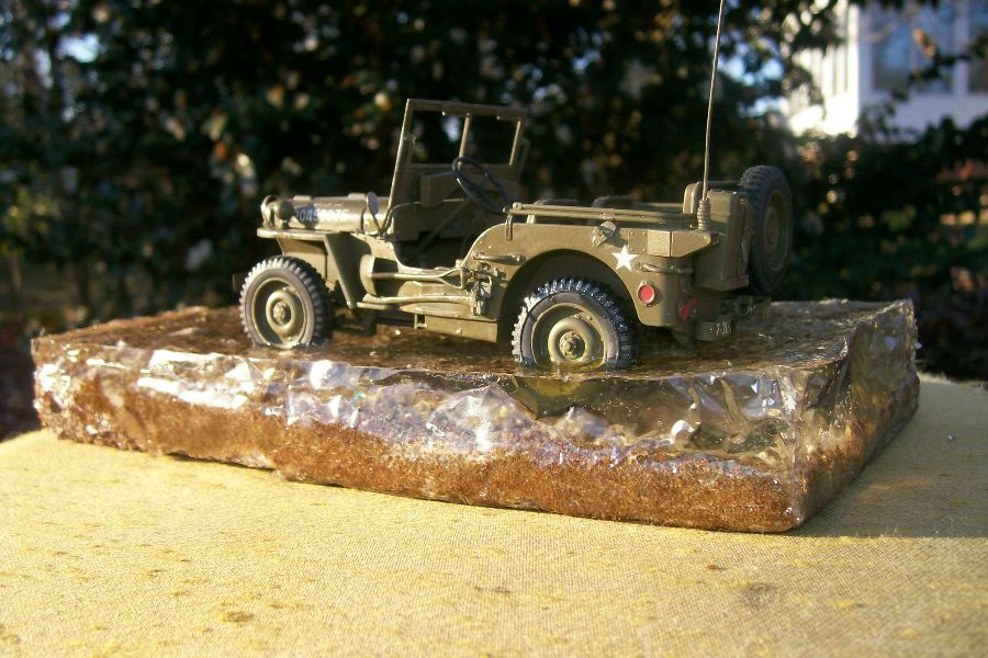

I kicked myself this morning. Went to check progress before heading to the salt mines and found my troubled spot had solidified nicely. IF I HAD LEFT MY MOLD IN PLACE IT WOULD HAVE BEEN FINE! I now believe it was a matter of catalyst ratio seeing how that was the thiner end of the pour, I’ll mix another batch with a higher ratio and recast that end.
My test sample looks great after sanding down bad spots and future overcoat, that stuff is amazing!

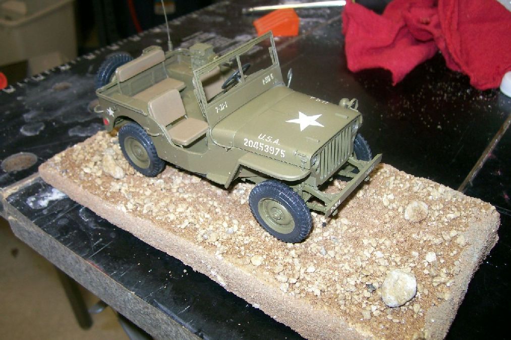

If anyone is reading this, I’ve poured my second casting this evening. Leaving the mold ni place overnight at least till AM. I have a good feeling about this one.
It really is looking super, Moon Puppy! Really realistic in my books!
The only thing I would have suggested early on would to not have put the jeep into the base so that it was parallel to the edges as you seem to have done; it’s generally more visually pleasing to skew the angles a little and not look so “pre-planned”, but I guess you’re past the point of that being an option…something to maybe keep in mind for the next one…
That Jeep’s looking very nice, Puppy! I really hope you get that clear resin problem fixed. Sorry I don’t have any answers, just two crossed fingers for ya! I sure likes it so far!
I would have loved to have more of a base working this but it came down to trying to fit in a display case to keep little fingers off. Using one of these 1/24 car display that’s only like 8" long and 3" wide (maybe wrong dimentions). But you’re right about having more space to worki wiht, Next thing I do will be without the restictions.

Yall are kind, I check curing process this AM, I’m thinking I’m good. the base is nicely incased in clear resin, almost like it is frozen, still a bit tacky but it was only 25degrees this AM and my garage is not that well isolated, heat is cranking. I’m still going to do some sanding of some of the rough spots and the orange peal effect is very prominent so I need to finish it off some how. I don’t have to worry about sculpting waves but would love to get the ripples from the what ever it is hitting the water surface in the original photo.
