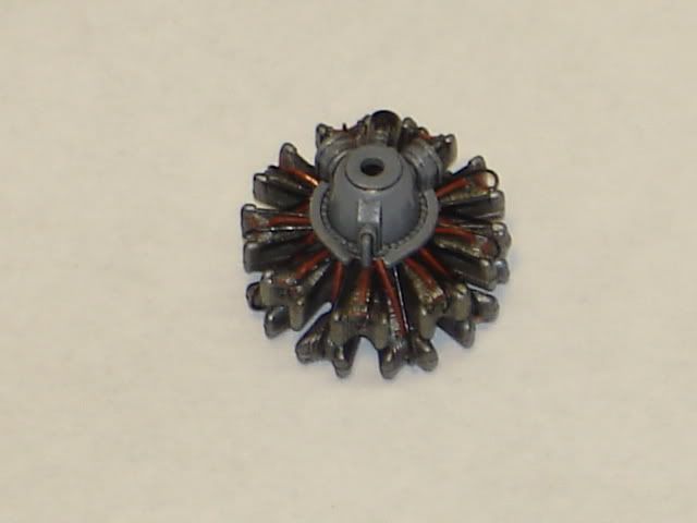

From what, you ask? Well, today, I decided to detail the engine for my Tamiya Corsair. The engine is the famous “Double Wasp” and is pretty well represented in the kit. However, I wanted to add a little more. Fuel and Electric lines did the trick. I used a thin copper wire I found around the house. Most of the wire was painted AFTER it was bent into shape, so it was a little nerve racking. But Everything went OK. Well, here it is!
Please feel free to tell me how to improve, I have a sneaking suspicion that this kind of thing will be happening to all my radial engines[}:)]

Radials can always get a little touch up to improve their looks. It sure is a tedious job to add detail to the ignition harness and cylinder heads - especially if you paint AFTER adding the detail… Well done.
But adding fuel lines is probably not quite technically correct…on radials the fuel is fed into a housing on the back of the engine (not unlike the way a two stroke lawnmower feeds the fuel into the cylinder via the crankcase) and is then fed into the cylinder heads through large diameter tubes…have a look at the pic taken by Gary Brossett of the back of a Wright Cyclone R2600 and you can see the exhaust outlets, as well as the intake manifolds that feed the front and rear banks with the fuel/air charge.
This detail is rarely provided with radial engine models, as you normally just can’t see it.
So adding fuel lines is probably effort that you don’t need to spend your time on…use that time to detail other bits!
Well done - and I hope you post more pics of the Tamiya Corsair as you move along with the build.

Lee, thanks for the tip. However, as much as I love loud engines and cars and planes, I know a surprisingly small amout aboe engines. It’s almost embarassing. I thought the black lines were the fuel lines in this photo, since the rustic looking lines are obviously spark plugs (i hope!)
Maybe the black line is a water injection line, since it’s a P&W R-2800-W, which used water injection to boost HP…
Radmax,
I think what you’re looking at are two different tipes if ignition wires…one appears to be gutta-percha and the other a rubber or plastic coated line.
Note that many radials had two spark plugs - one on the front of the cylinder head and one on the back side.
Or maybe you’re right about the water injection…I’m not sure.
Anyway, make sure you post pics of your Corsair.
