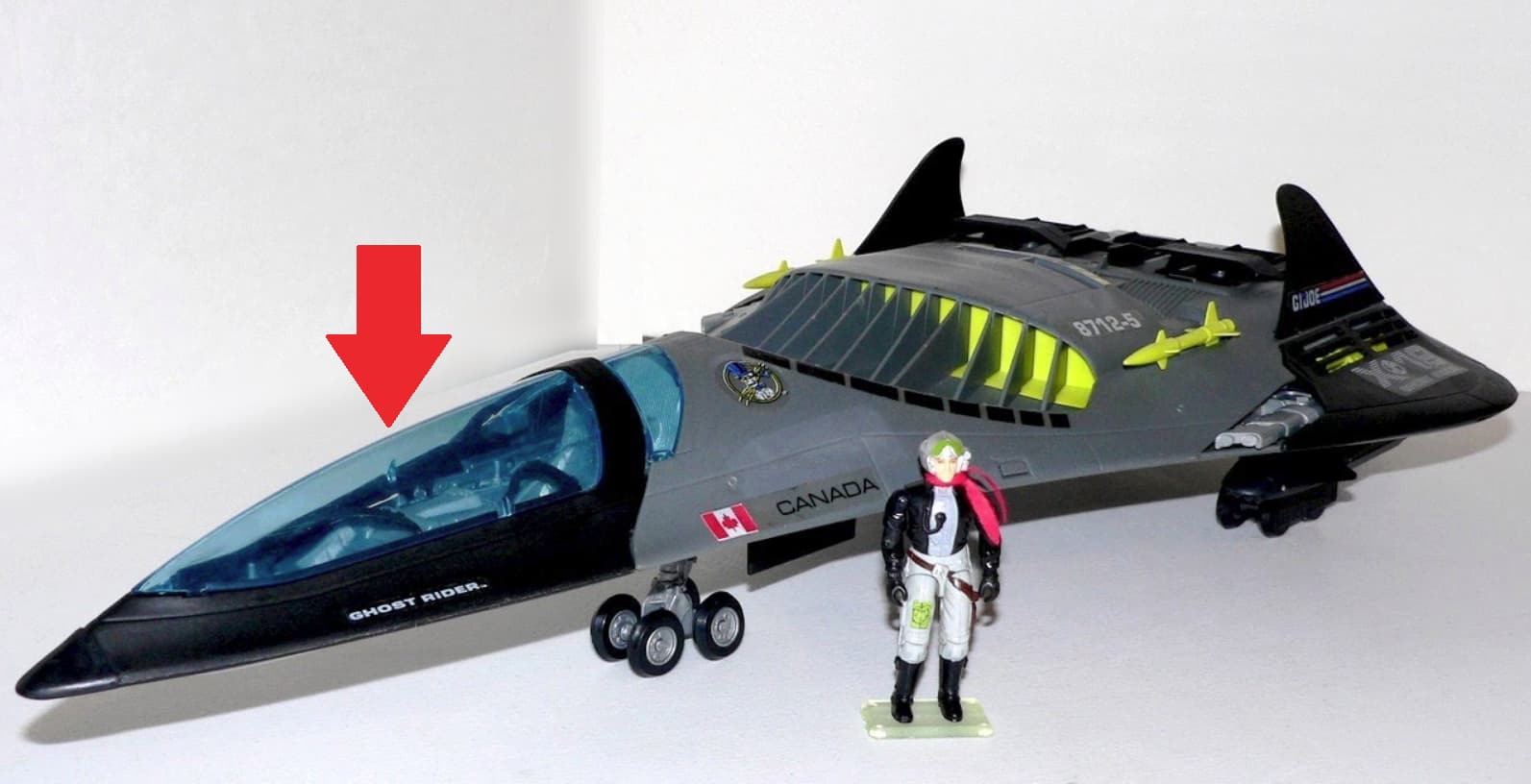

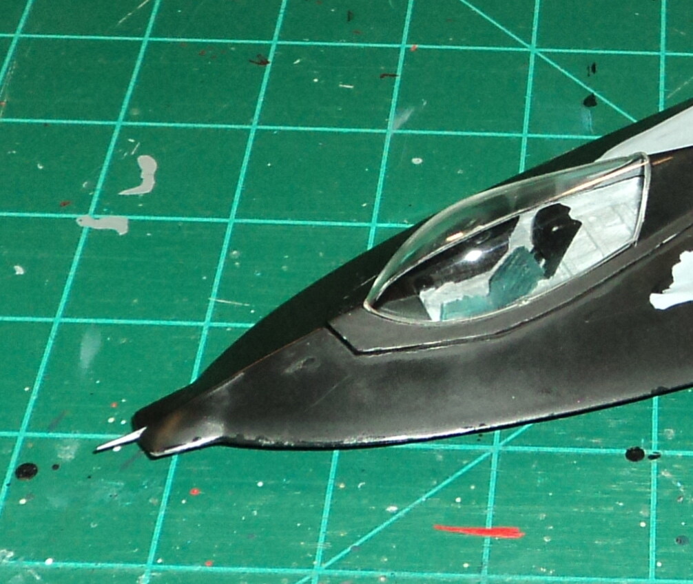

As I’m working on converting my Testor 1/48 scale F-19 stealth fighter into a GI JOE X-19 stealth fighter based on the old 1980’s toy, I’m going to need to tint the cockpit canopy a blue color.
What might be the best or easiest way to do this?
