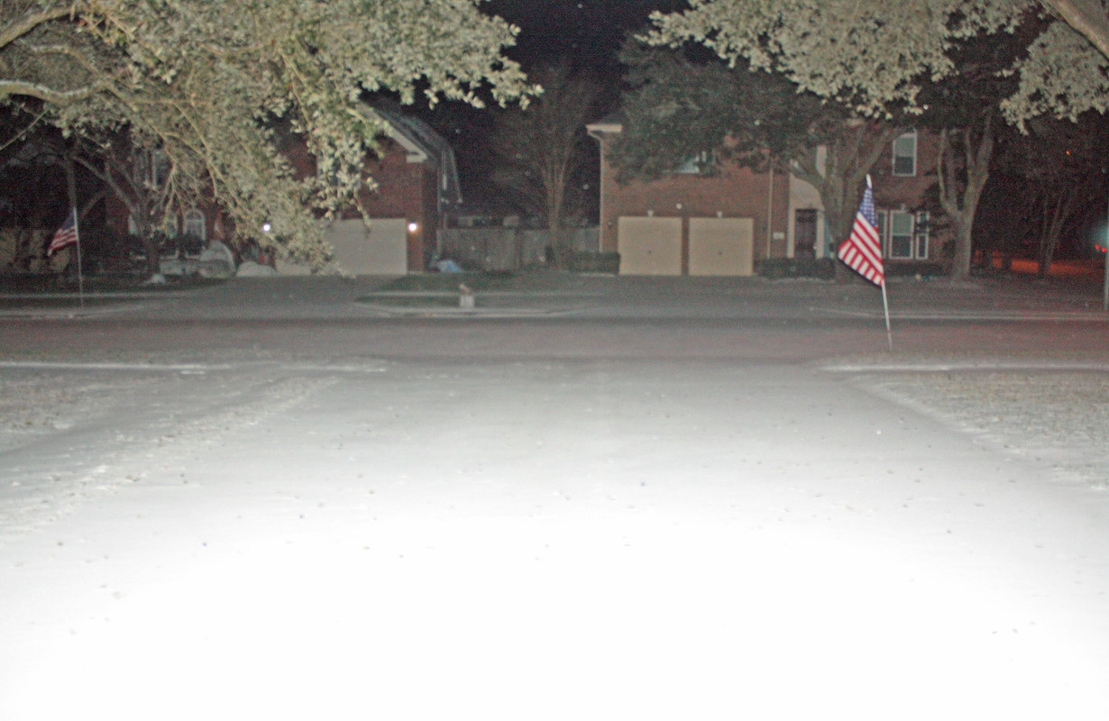

This was my driveway and the facing street when I woke up Monday morning:
While this may not be impressive for anyone north of the Red River (Texas - Oklahoma boundary), this is a winter wonderland for us here in the Houston area.
