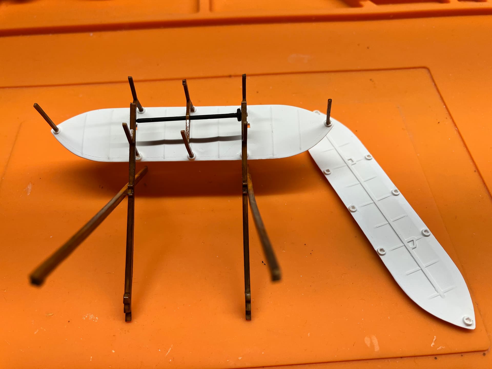

Here is another use of the Micro Liquitape. The instructions for this model are great as long as you don’t remove anything from the sprue to paint it. I really felt like I needed to test fit these parts before committing them permanently, as they are quite fragile and wouldn’t survive a gluing to find out that I transposed the parts. Since I am using superglue as most everything that could be assembled before painting has been done, I won’t worry too much about trying to get the Micro Liquitape off-especially since I didn’t use much of it and it didn’t take much to do what I was trying it for.
