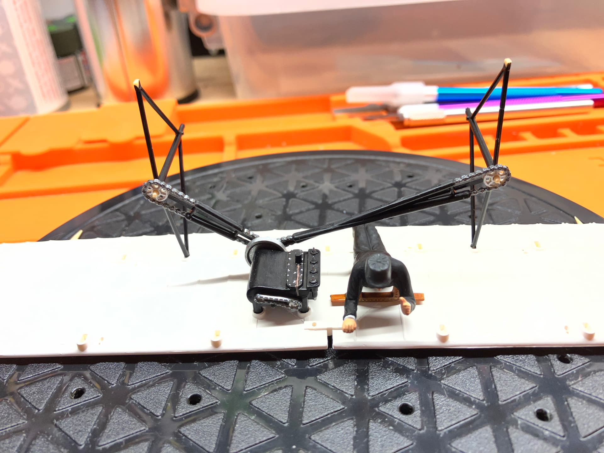

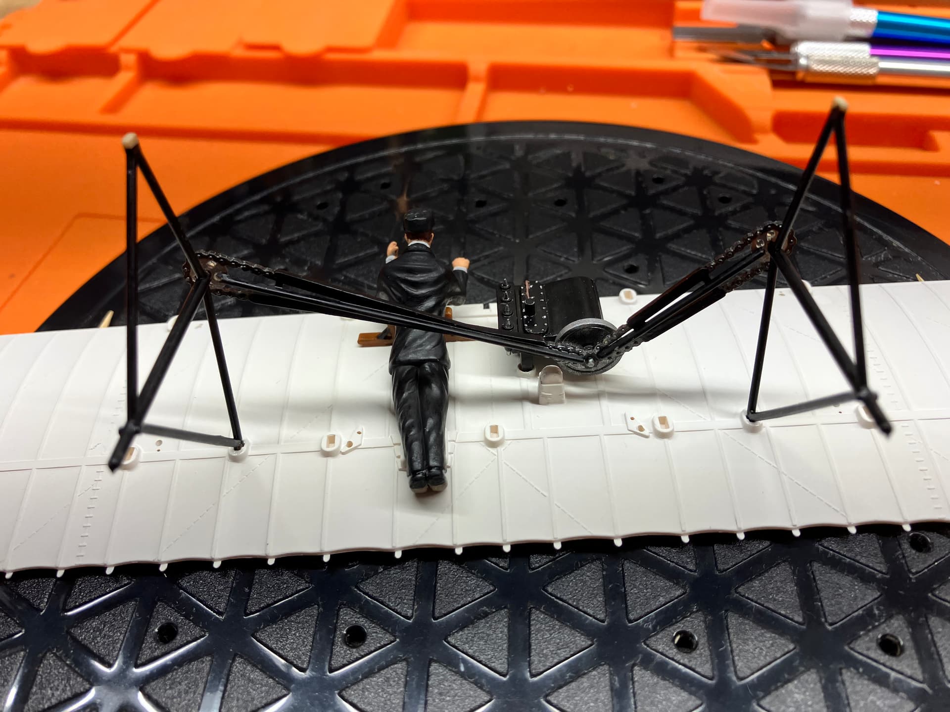

OK, here is what I came up with. I like it and it did serve the purpose I had hoped for. The parts were really quite loose and would not stay in place long enough for me check the fit and satisfy my curiosity as to what the final product would look like. It was interesting, in that you put the adhesive on and let it dry, THEN assemble the parts together. It does work well though.
I am a little apprehensive about removing the adhesive when it is ready to be glued up permanently, as I used it on already painted parts. The instructions on the bottle state that the dried adhesive should be cleaned up with paint thinner-which I would think would remove the paint also.
