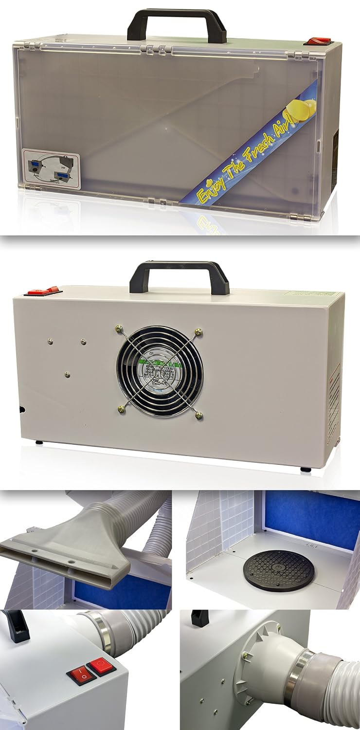

I’m very happy with this Amazon model. It folds onto itself and become a little suitcase for storage. Never seen a spraybooth that could do that. Only $80, which is as low as it gets.
http://ecx.images-amazon.com/images/I/81haYDqT-IL._SL1500_.jpg

…did the post re: portable spray booth get here by accident?
