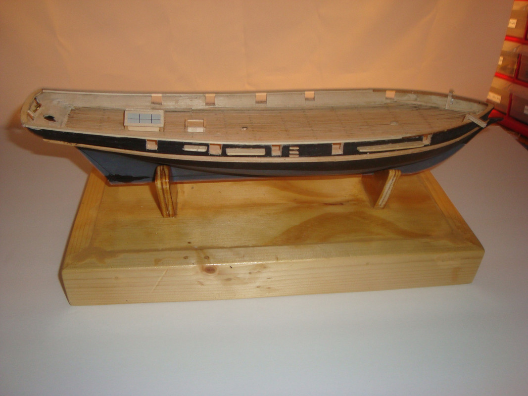

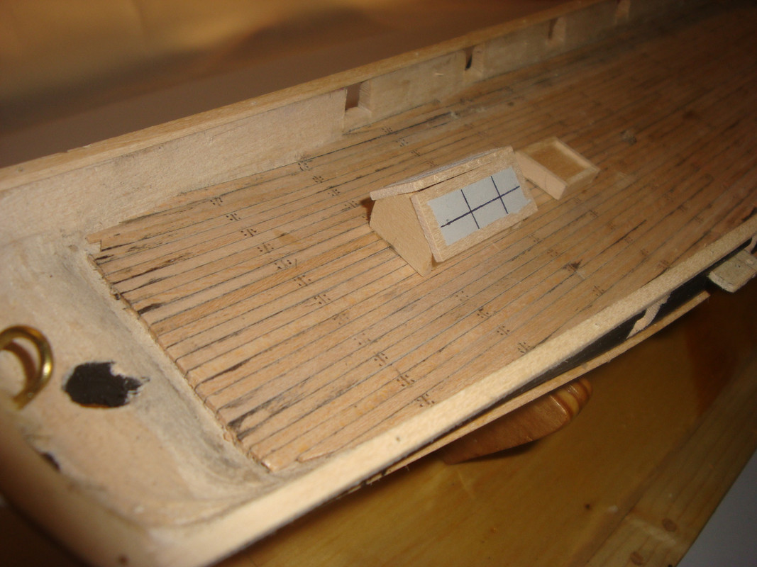

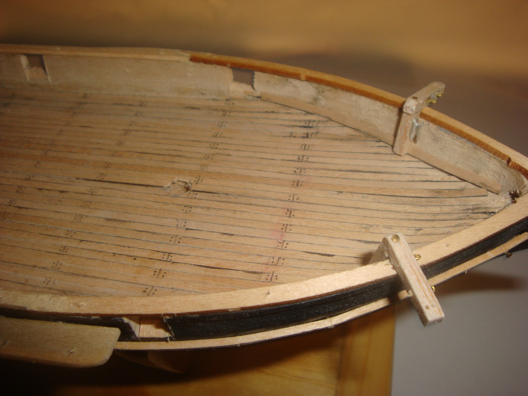

Well I am back, sorry for the delay. I did purchased the Dapper Tom, the ship is smaller than I wanted, as I had explained before, the main reason I wanted a larger ship is so I can work with the little parts. I am 76, and my eyes and hands do not work as well as when I was 26.( I guess is why it is called old age)
I have run into several problems, some expected, some not, for example, on the instructions it says to make the water pumps and has an illustration of how it is supposed to look like, but, there is no reference as to the size of it, and since I do no have a clue of how big the pump is supposed to be, I guess I have to guesstimate it.
I found that the instruction can be confusing an do no have sufficient detail to help a beguiner like me to understand what I am supposed to do. I am progressing, but very slowly.
Is the instruction on all wooden kits as vague as the Dapper Tom? Or it just this manufacturer. Well attached are some photos of my progress with this ship.
Tom1
Tom2
The deck was lay in using small strips provided in the kit. The 2 items on the deck were also made, they are not perfect, but I hope it will do the job.

Hi Joe! It looks like you are off to a good start. Don’t try to rush it. If you see any problems or have any questions, just ask. That’s what we’re here for.
Keep up the good work.
Jim [cptn]
Stay Safe.
Oh, I almost forgot. My wife has a saying that I rely on to this day. Measure twice, cut once. [;)] She’s been a seamstress for about 40 years.
