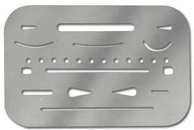

Any Photo etch template such as Lion Roar, Verlinded, Eduard etc…as long as its pe, it will bend and flex for going over curves. Don’t forget using thin strips of Dymo (label tape) works great too.
Stainless Steel Erasing Shield:
I paid 35¢ (in 1965 money). I don’t need it often, but when I do…

+1 on this. I bought one at HL with a 40% off which made it was less then a dollar.
