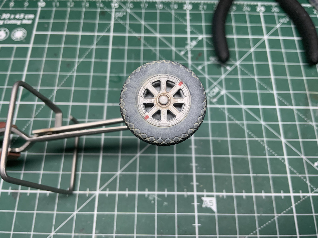

I’ve been experimenting with Ammo by MiG washes lately and I’ve been happy. They dry nice and flat and you can use enamel thinner or mineral spirits to reactivate. They come in over 20 colors. This is the dust one. Of course test on junk plastic before using. If you switch to Flory it’s really safe as it can be removed with just plain water.
