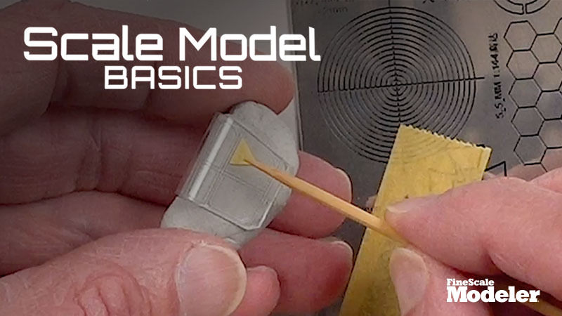

For masking canopies without pre-cut masks I have used the method FSM shared of applying tiny triangles to fill the space between the frame.
It can be time consuming, but it isn’t difficult and I’ve been very pleased with the results. I’ve also used this method when I’ve had to mask a curve of varying radius and irregular shapes.
