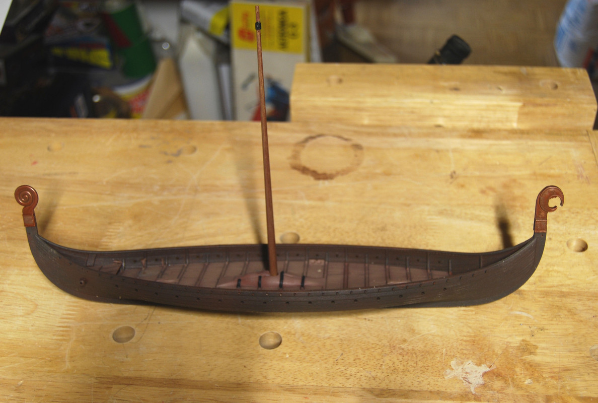

After the neat builds I have seen here on this kit, and the fact that I am in the middle of a course in Viking history, I couldn’t wait any longer to get the kit on the bench. I want to not duplicate any of the previous models presented already, so I will be trying other options whenever I can. I decided first off I would not gild the figurehead or the sternpost carving, depicting these figures as bronze. I have seen pictures of bronze figureheads, and decided that the Vikings were after plunder, and wouldn’t waste gold instead of steal it. So I used my technique of starting with Alclad copper, followed by a very light coat of a dark brown, Then medium gray and zinc chromate washes. I felt the artwork on the shield decals was a bit intricate, so hopefully I will be able to do some simpler inkjet shields with a bit less fancy design.
Here is my start.

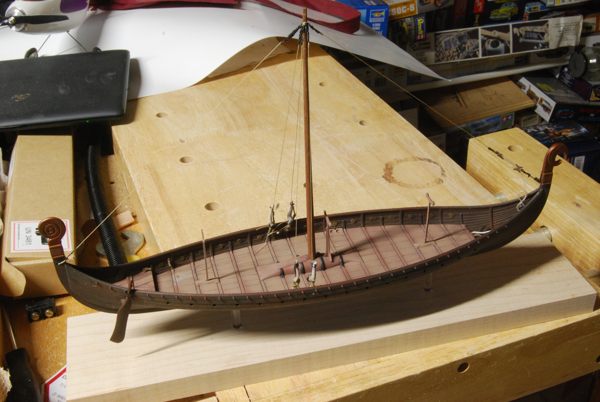

Got some more work done over weekend. Since I intend to showship rigged for sail, oars stowed, I punched out 32 disks from0.020 styrene to act as oar port covers. These were glued inside hull and painted.
I have started the rigging. I found a couple of diagrams of viking ships, and several pictures, graphics, and pictures of rigged models. No two were the same. I have read about the variability of Viking ships so I feel free to rig with the conbination I chose, as long as things would provide the functions ofthe lines shown in these references.
Also shown are the completed 24 shields using the kit decals. There will be eight more using homemade decals with common Viking graphics.
Decided to redo the forestay. Several problems- the tensioning area was too high up, and the serving was pretty crude. Havent done much rigging for a few months and need time to recover my rigging mojo.

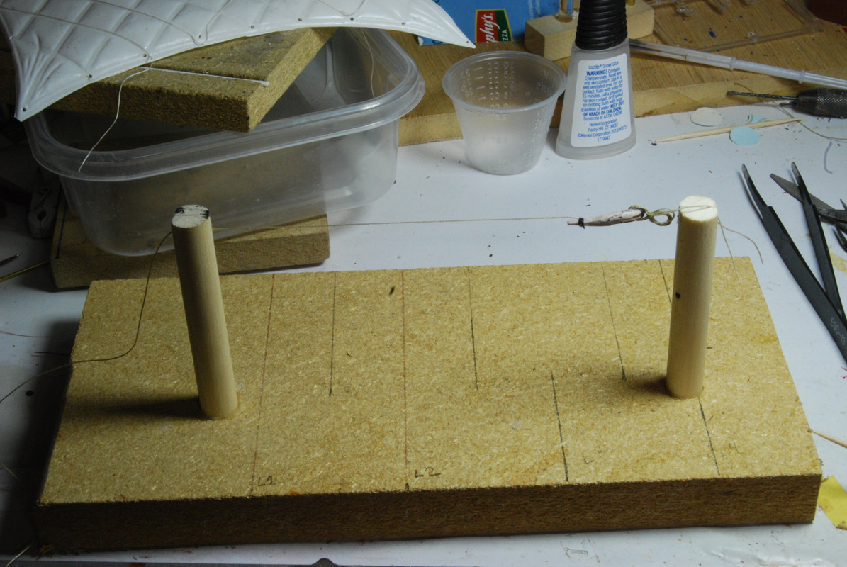

Here is a shot of the simple jig for serving parts of the lines near ends.

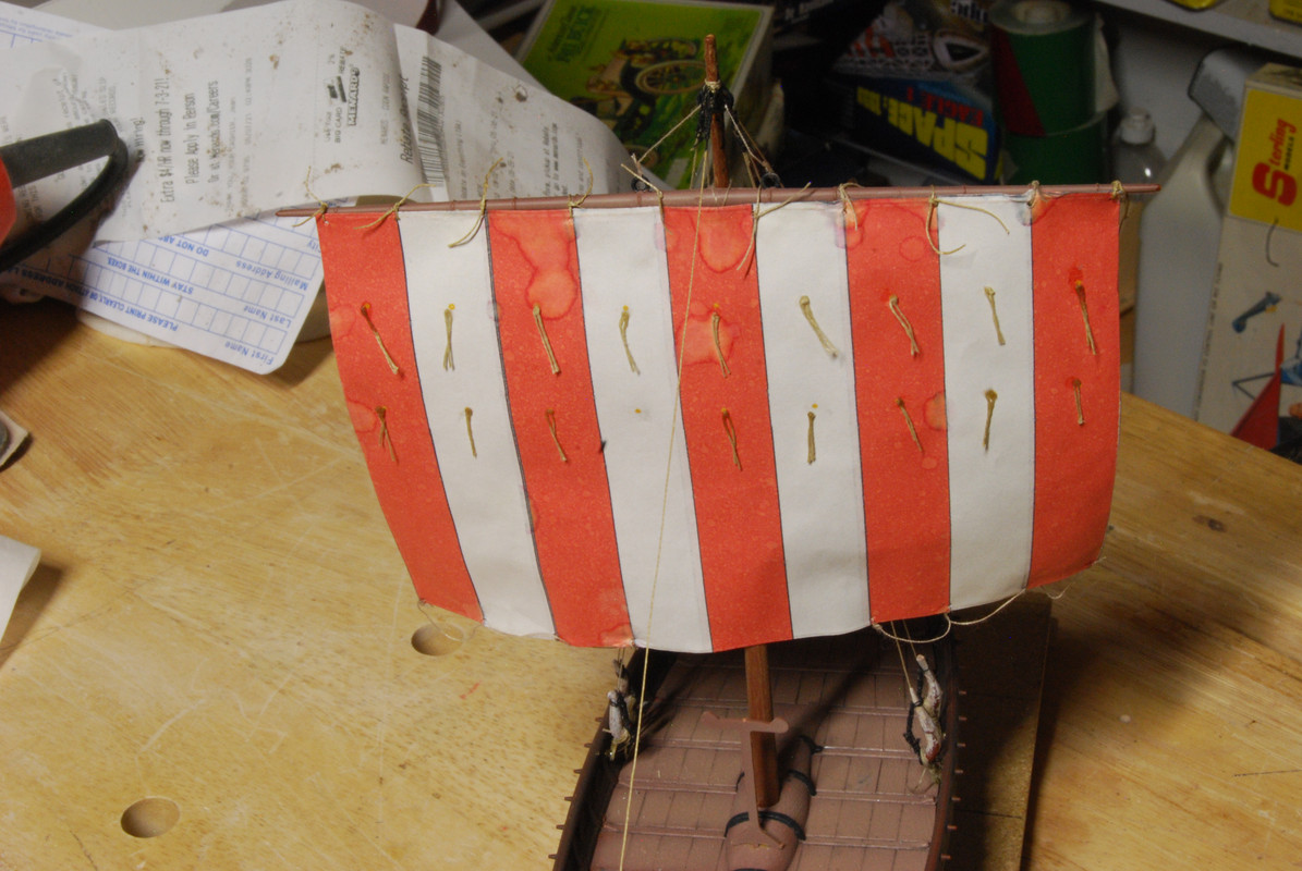

I am starting on the sail next. This is going to be a lot of work. I don’t particularly like the kit sail- I believe it is molded with too much depth. But I am not a great tailer, and didn’t want to put in the effort to sew one from scratch, so I’ll do the best I can with the kit sail.
In my old thread, I show how I made mine out of vellum paper. I thought it came out pretty well.
Bill
looking good don

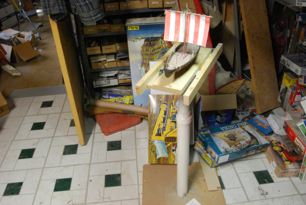

Finally discarded the kit’s plastic sail, and made one from paper, a pretty simple, with inkjet coloring. I got it wet in a few spots and it made a slight stain. But I figured Viking sails must have gotten wet at times, and it looked weathered, so I left it. Working on the running rigging now. Not much to it, be done soon. Then will be stowed spars and oars, followed by the shields. Also gave the base a couple of coats of glosscoat- it will be ready soon.
I am doing the rigging on my rigging stand. It is a simple stand made of two sort of telescoping pieces of PVC pipe with a swivel tray on top. The height is adjustable in one inch incraments. The bottom pipe is fastened to a simple plywood square with L brackets. I find it very handy.
