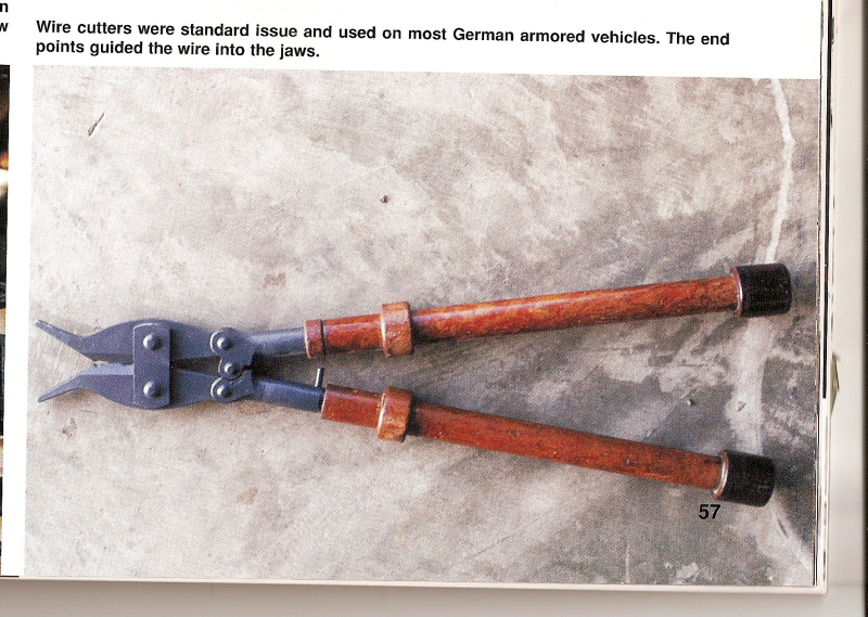

the wire cutter handles were ‘bakelite’(sp?)(primitive plastic) not wood-- does that help?[:D]–I assume you are speaking of axis tanks[}:)], but, I think there is some debate over this— in some pics I have, they look like wood over a steel shaft–tread[8D]
Wire cutter handles (German) had two types, one type was bakelite, the other was resin-impregnated corrugated paper. Given the amount of pressure required to use them, a smoother handle was more desireable I think with the added bonus of having greater protection/insulation against potential electrocution when cutting, well, wires. [:)]
As far as the actual tools and what they looked like, hunt around using Google for WW2 re-enactor/collectible sites and you’ll find lots of examples available. They pop up on E-bay a lot under authentic memorabilia too. For the most part though they were rather ordinary…ash handles and metal/steel heads with the exception of the wire cutters.

Dupes so you want to know there functions.Well shovel for digging around the tracks if need be-like mud-to get to the links,also for digging fox holes and embankiment.Who want to get caught in a shelling birage in a tank.Axe for chopping wood and cutting trees out of the road.Sleadge hammer to pound track pins to bust them loose to replace.German had two “C” looking things to help pull tracks together and fasten.All them rods on the side of the tank were ram rods for cleaning the gun barrels.Then you had pry bars and crank handles for jacks.Also the jack too.When a tank came out of the factory all tool except handle were steel and shinny,most tanker would paint them the color of the tank so sun light would not bounce off and give away there position.Or they would dull them with grease.After a peroid of time the paint would chip off showing the steel again,so when it was time to repaint the tank,the tools got a paint job too…Digger
A German tank veteran said that tool stowage locations were adhered to rather strictly – most important with the sledge hammer and the pry bars. The reason was if a track was thrown at night, every crew member could get out and get the needed tools to quickly repair a track. The pry bars and hammer were vital to this task. HTH

If you can, grab any of the Achtung Panzer books which have drawings of the tools and their mounting brackets/clips. I don’t have anything more than that. Good luck
