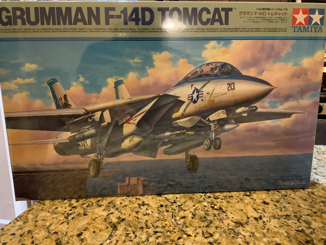

Very excited. Look what came today.
Happy about the box of plastic that greeted me by the front door this evening. Anyone build this kit? I heard wonderful things about it. Any of you guys have any pointers before I dive into this thing?

I built the 1/48th Tamiya F-14A, which is largely the same as the D. Its an excellent kit that is the typical well-engineered Tamiya model. The main issues I had with mine were the canopy and windscreen. The canopy was slightly warped inward on the sides, so I had to use a temp-controlled heat gun and creative use of double-sided mounting tape to slowly work it back into shape so it fit correctly all the way across the fuselage. The windscreen assembly was probably engineered with tolerances that were a little too tight. I couldn’t get it to mount flush because I had already painted everything and tried to put it on at the end. Definitely check the fit on that before painting anything. You may opt to attach it first, and then mask and paint.

There will be a ledge at the meeting point between parts B4 and B17. Don’t waste your time sanding/filling; it’s supposed to be there.
I agree with the comment on the tight fit. Test fit everything beforehand.
