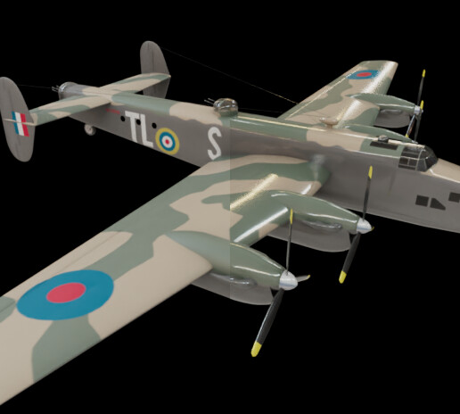

I’m not sure of why but high roughness scatters lights more, adding virtually a new layer over the paintjob. Gloss meanwhile focuses the light instead of spreading it on the surface. I’d hazard the guess that gloss actually reveal the “true” color underneath… But you have all those reflections that look out of place. It’s more or less the same difference between wet, fresh paint vs dried paint 24h later, I suppose.
here you can already see with a simple CG setup how the green and brown colors look different when matte ( left, high roughness ) vs glossy ( right, low roughness )
