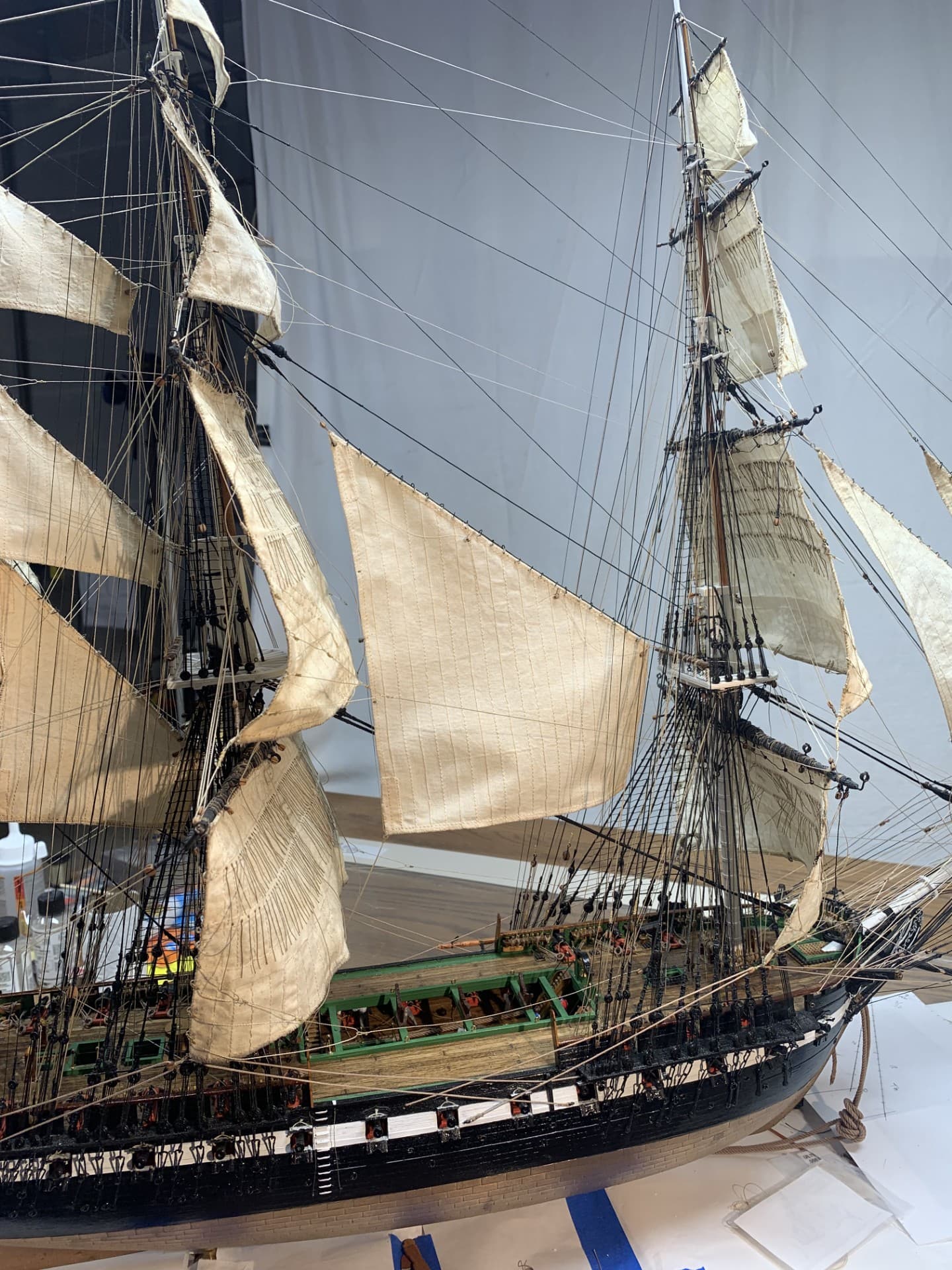

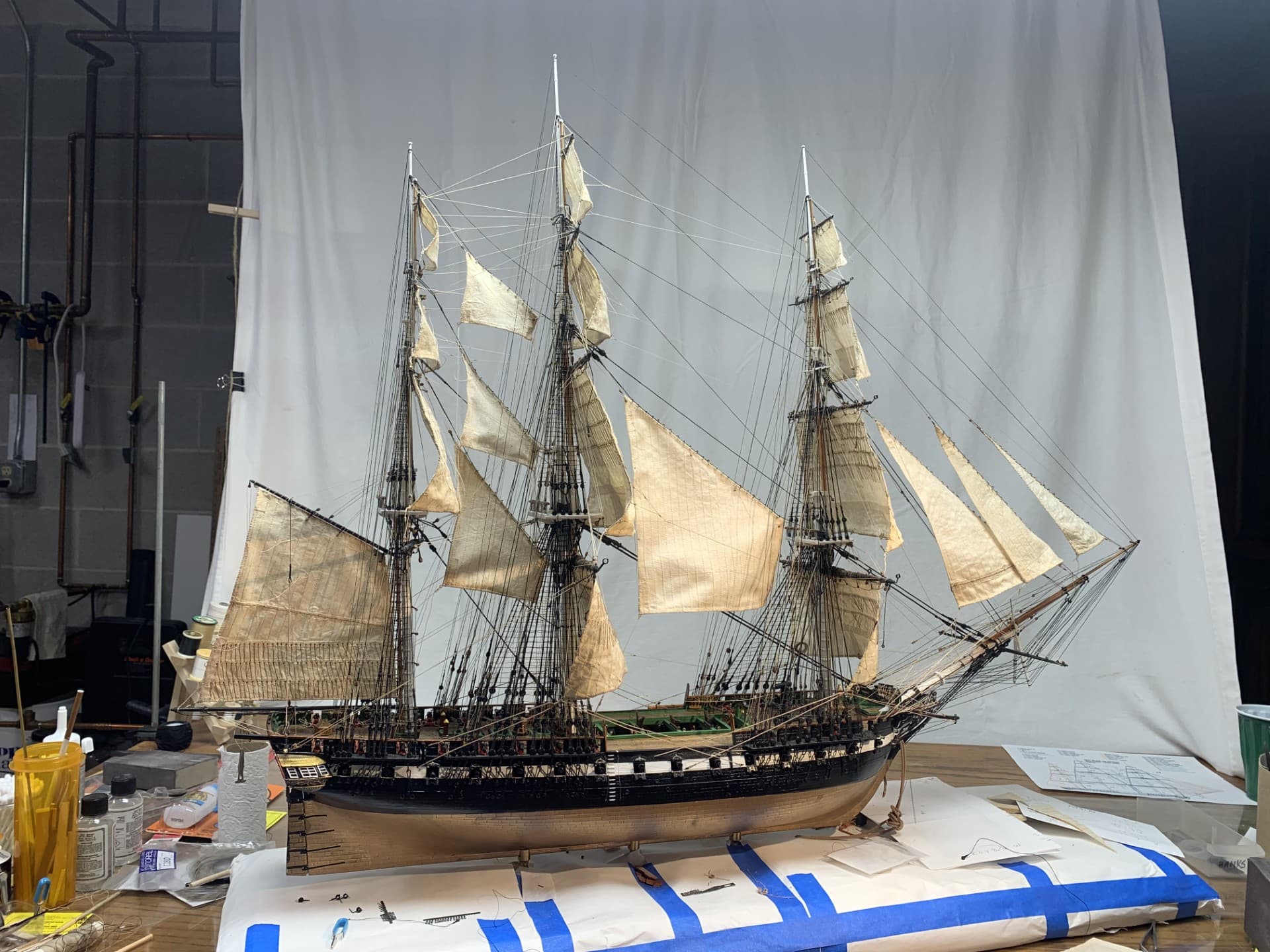

Sewed in the bolt ropes, added all the blocks (and a thimble) to the main topmast staysail. Ran the line for the haliard and rigged it to the sail to help keep it pulled aft so I could rig all the hanks in place. Tied off the fore upper tack, rigged the downhaul, and then got the haliard all tied off. Also rigged the sheets, which tie off to a cleat on the boatskid. All that is left are the lower tack lines, and the main topmast staysail will be complete.
Take care,
Bob
