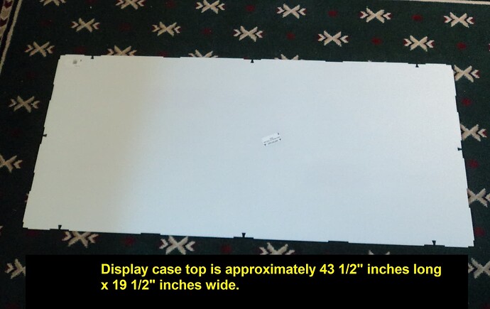

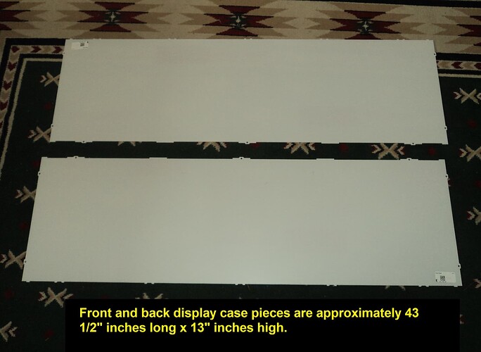

The Good News: My LEGO display case arrived today! :smiley: No missing parts and no damage either.

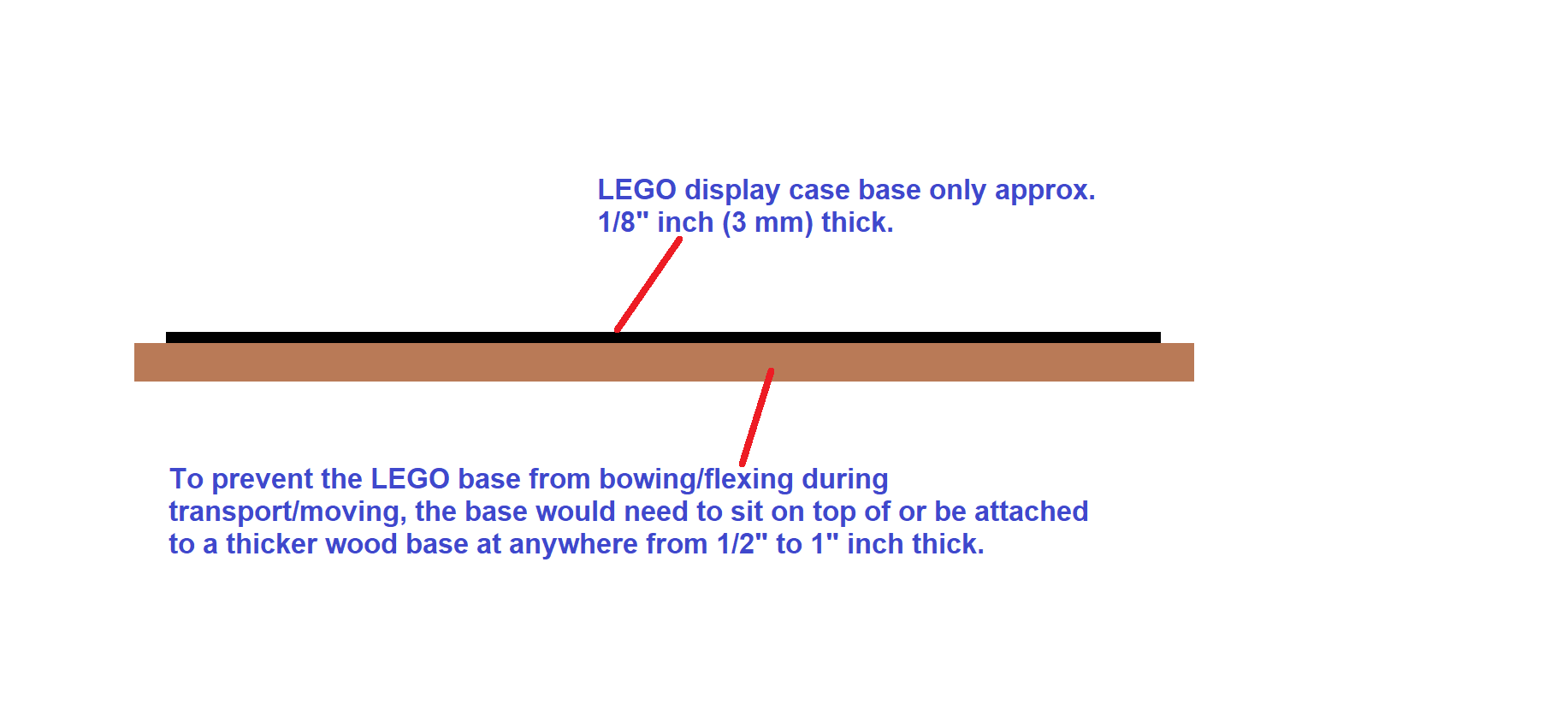

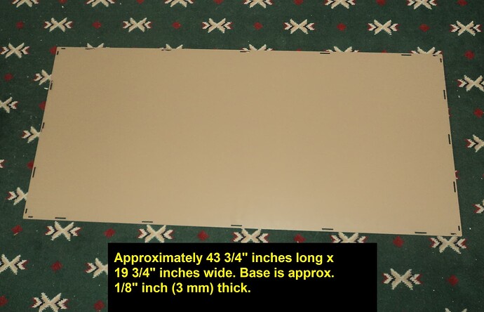

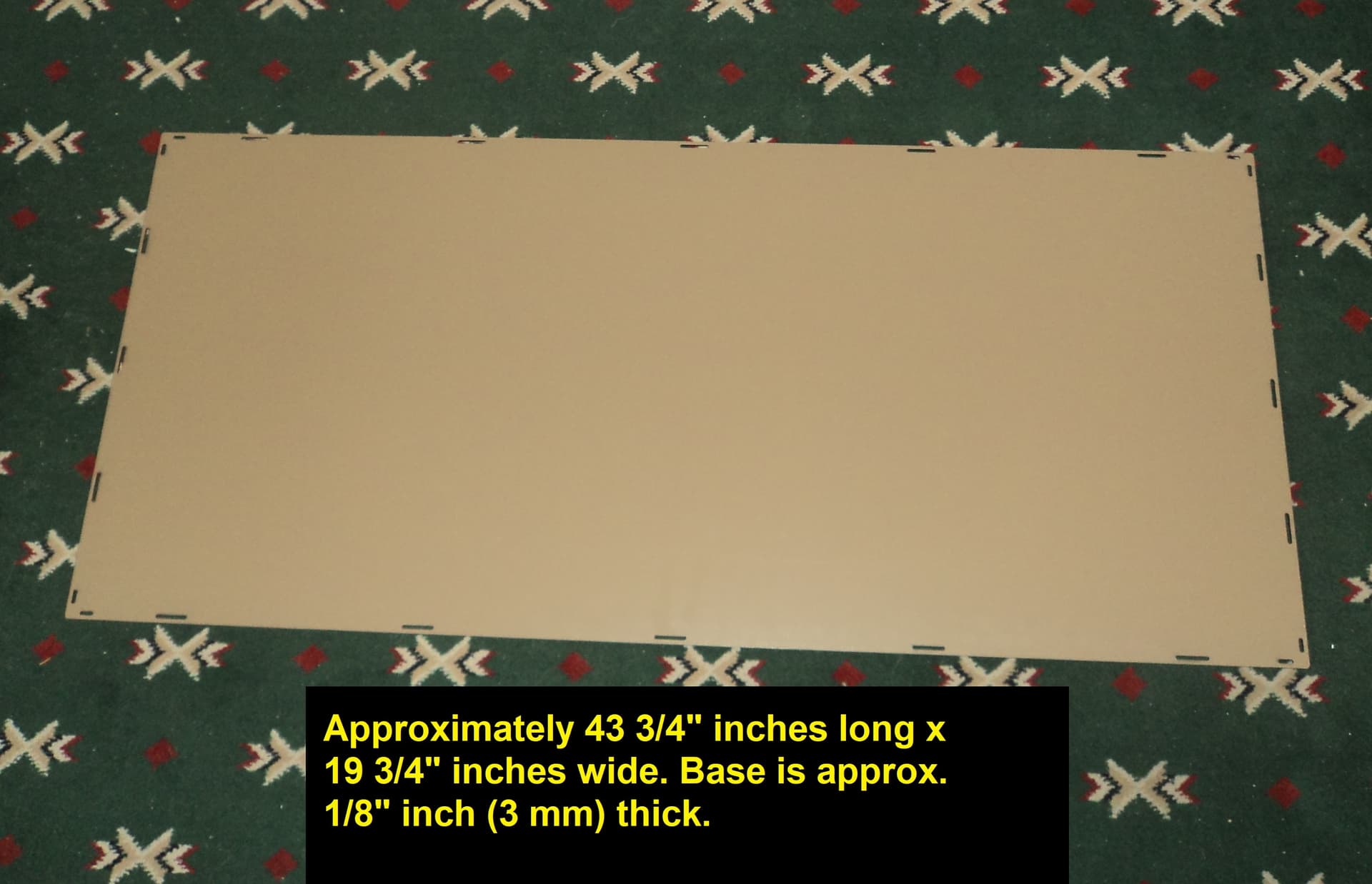

The Bad News: The display case “base” is only 1/8" inch (About 3 mm) thick. I was hoping it’d be thicker. :frowning:
The Ugly News: I can’t build this case until I get a thicker wood base for the LEGO case to sit on. :enraged_face: Diagram picture will explain further below.
Note: All dimensions are approximate. I did not measure to the exact 1/16" inch or whatever.

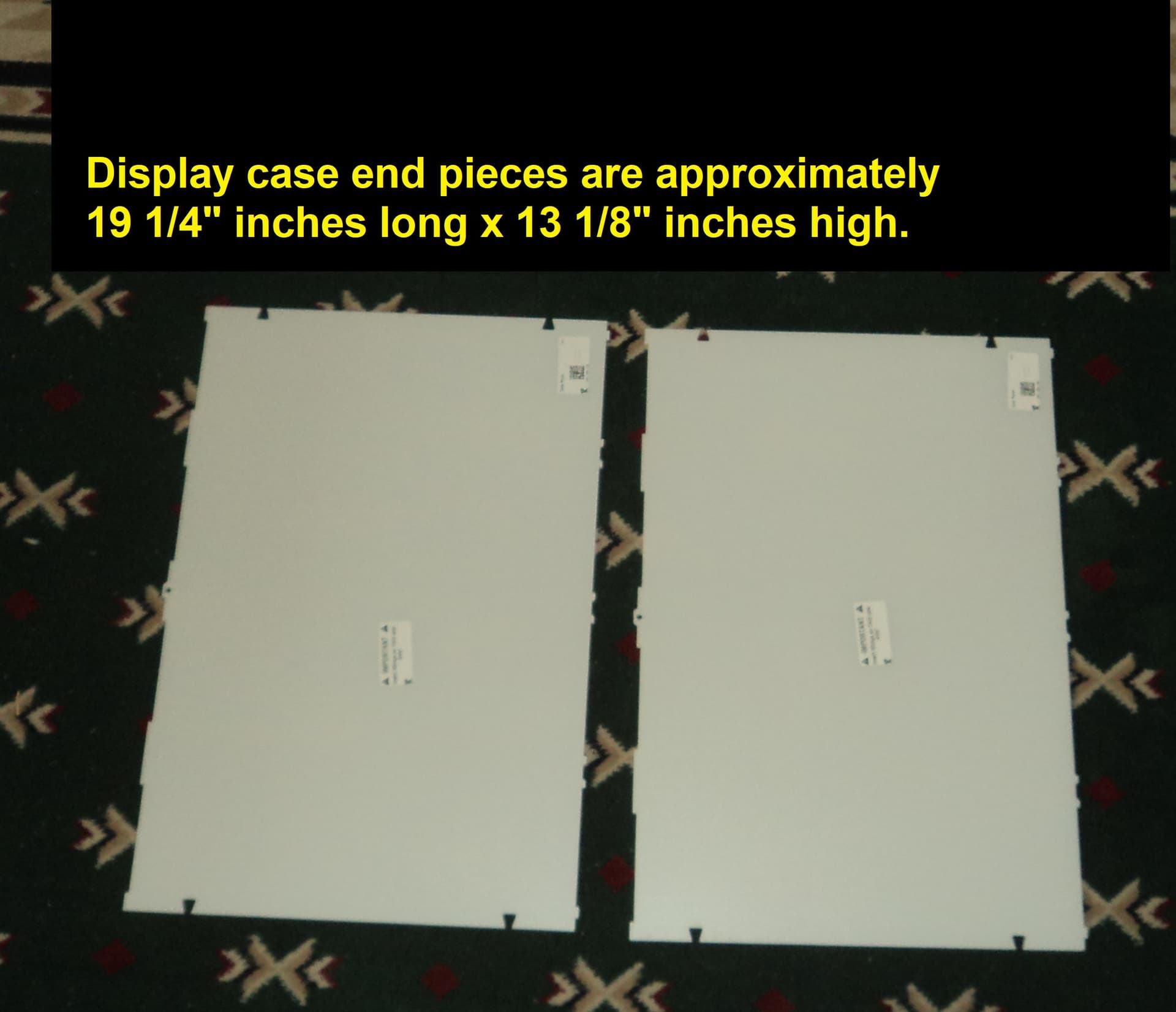

What I got was the Concorde LEGO display case which is the only size capable of covering my 1/350 scale TAMIYA converted/kitbashed Enterprise CVN-65 carrier model.
From the time I ordered the case to the time it was delivered today took about 1 to 1 1/2 weeks. Not too bad. :smiley:
And to say the display cases pieces were packed really well would be an understatement. Lots and lots of bubble wrap. :open_mouth:
So after seeing how thin the base for this display case is, I would probably only recommend LEGO display cases for small to medium sized models. If you’re going to use a bigger display case for a bigger and/or heavier model, you’ll have to put the display case base on top of another thicker wood (or other material) base as shown in the diagram further below.
WOW! That’s a huge box/base. Thanks for the tip to add a wooden base if you have a large/heavy model. You’re lucky that there wasn’t any damage during shipping.

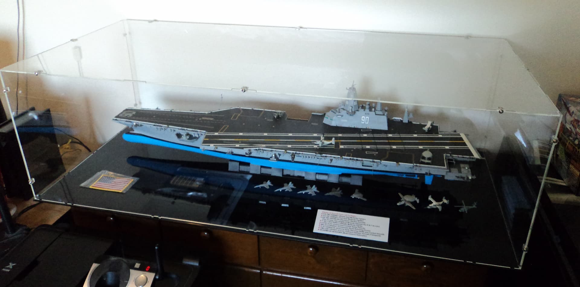

Ask, and ye shall recieve.

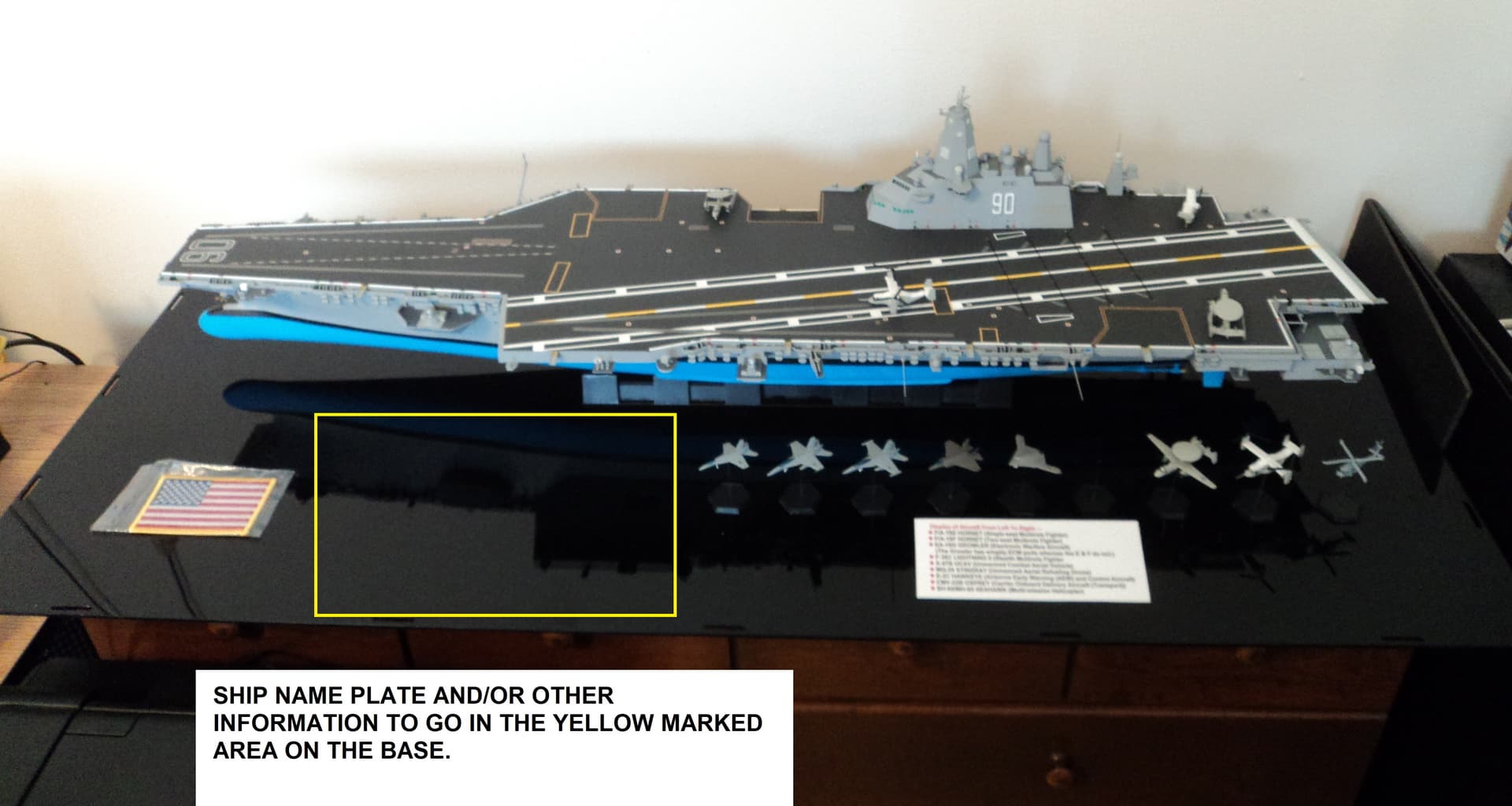

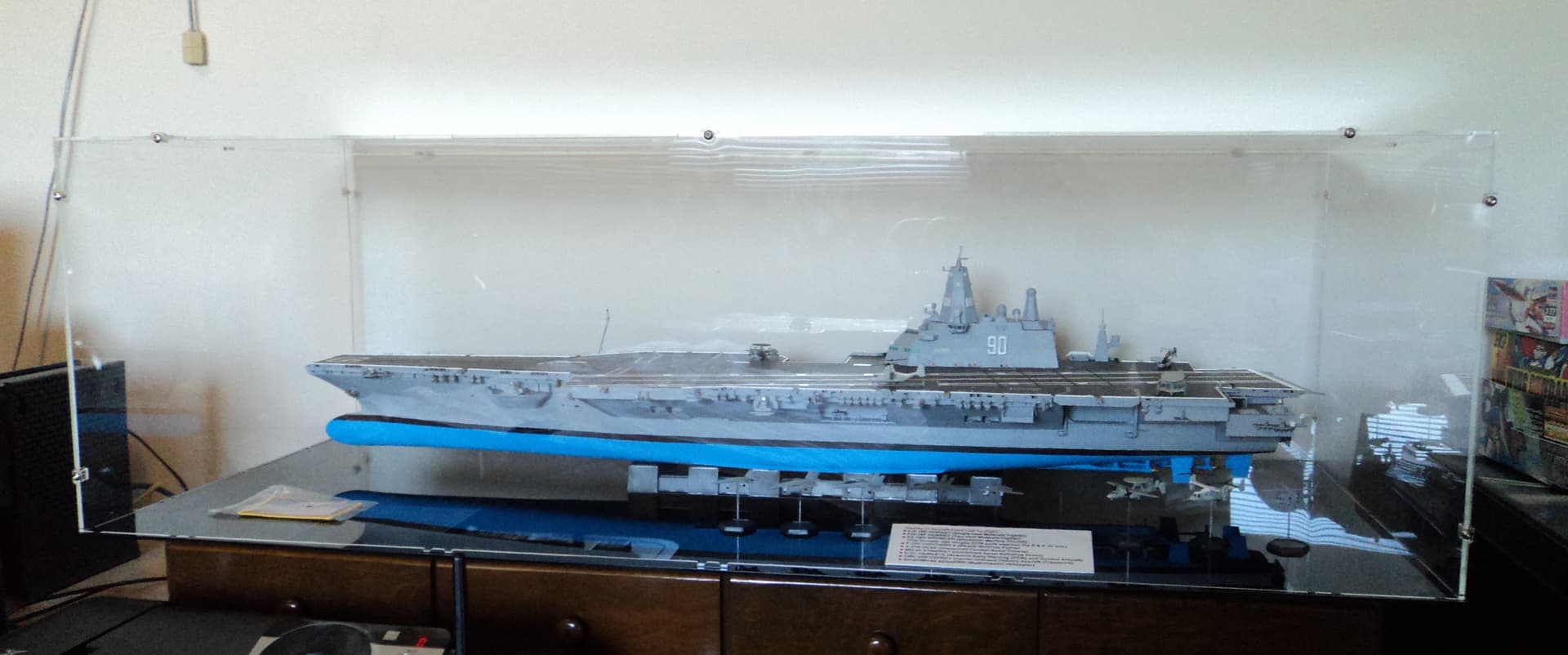

PRELIMINARY TEST PICTURES

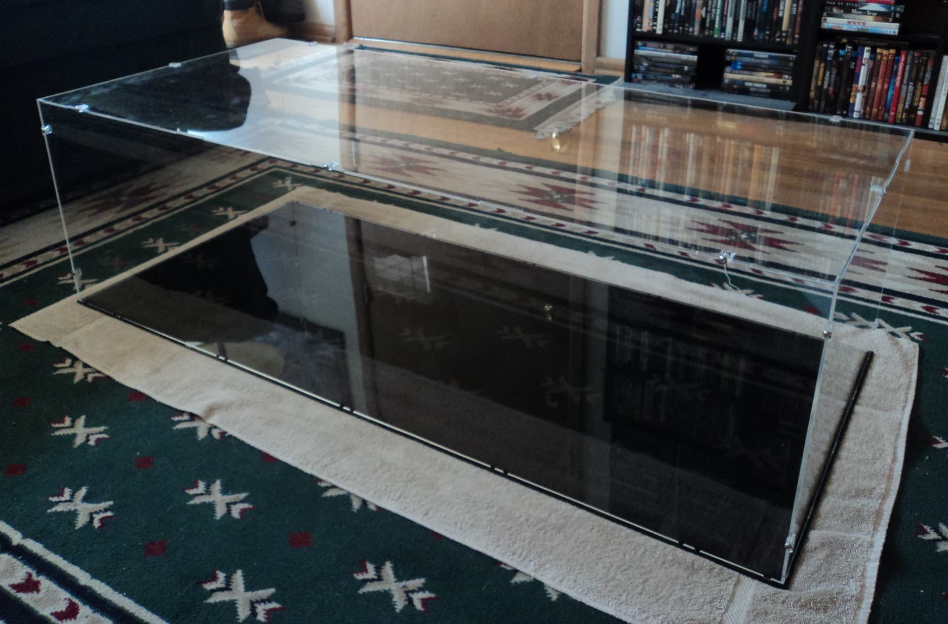

So I said screw it and decided to build the display case because I was curious to see how it’d look.

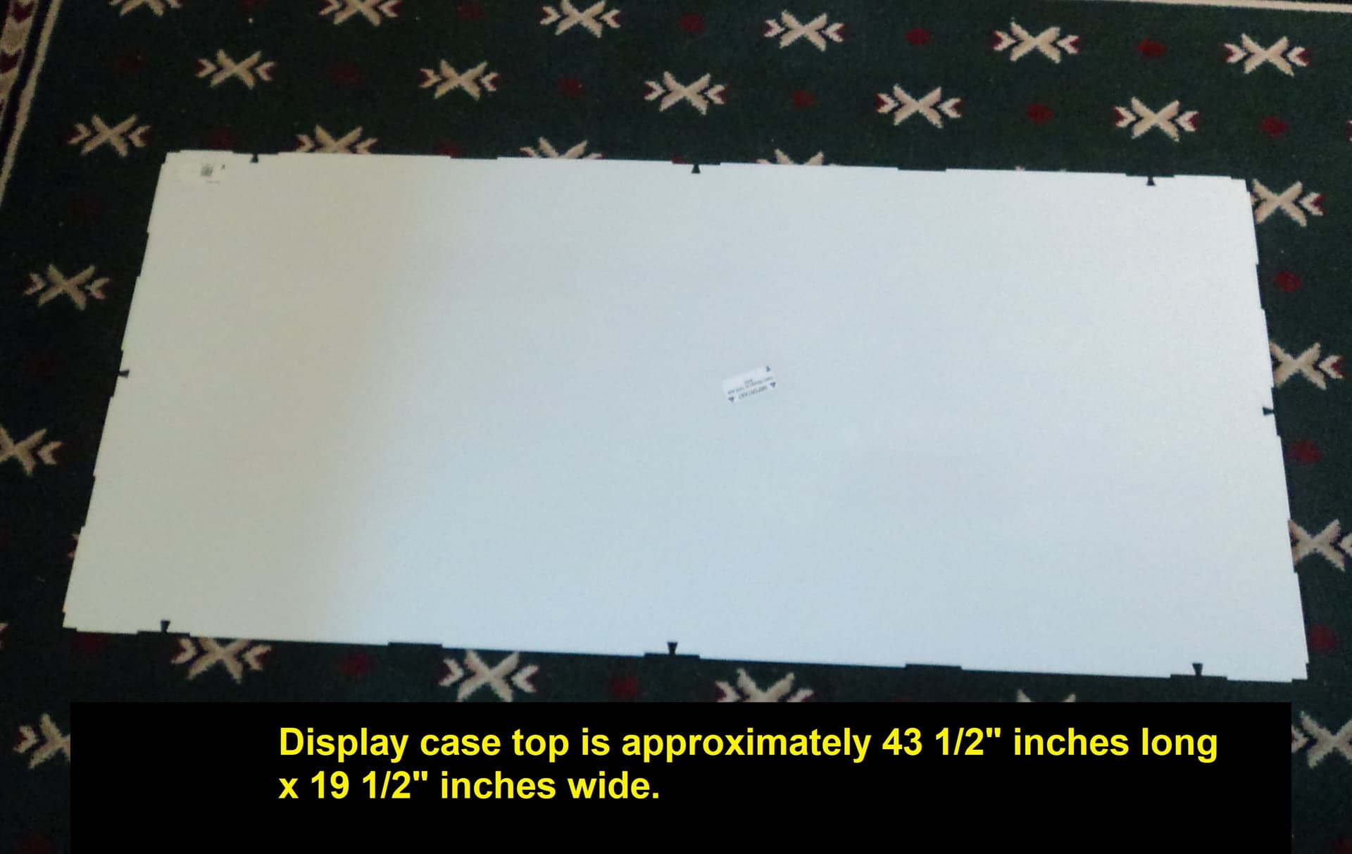

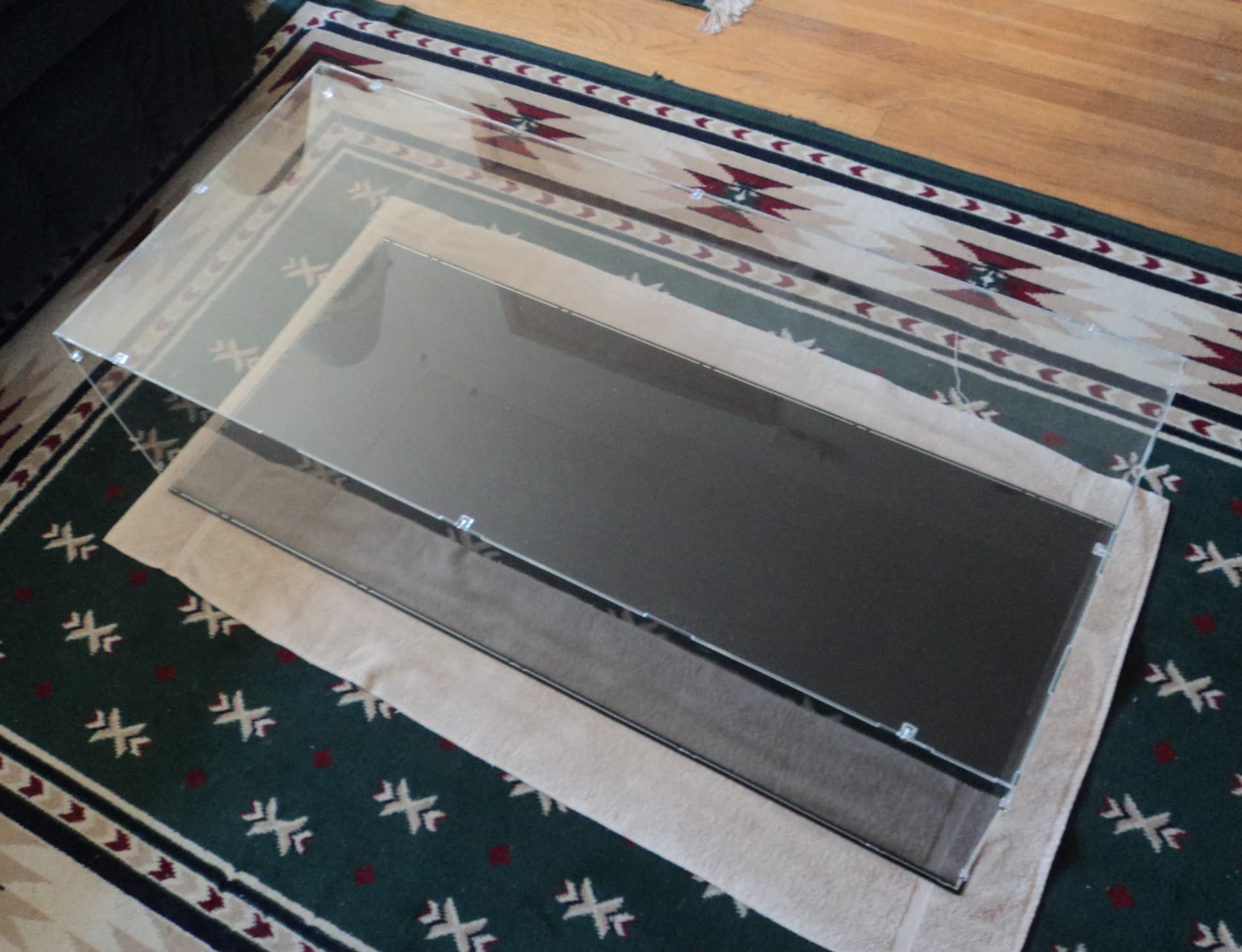

It’s big and it holds my 1/350 scale carrier model perfectly. Nothing inside the case is permanently attached to the base. Everything inside is just for test fitting only. I was able to build this case by myself without too much trouble. But the larger and/or heavier case a person gets, then they may need a second person to help them build it and/or move/transport it.

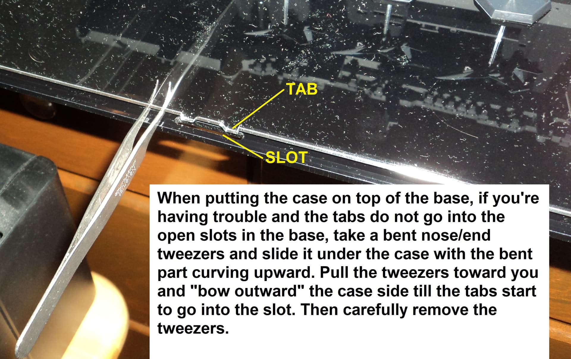

Before assembling, make sure to CAREFULLY remove the protective wrapping on both sides of all acrylic pieces. It’s best if you lay the acrylic pieces flat on the floor on a soft towel when removing the protective wrapping.

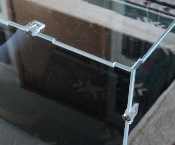

I’m sorry about the blurriness of some pics. I tried to take a pic of the plastic clips that get attached to the acrylic panels and also the screws, but my photography skills are not as good as my modeling skills. I did get enough plastic clips and screws as I had 2 extra of each leftover in case I lost any. Thanks to Kingdom Brick Supply for providing extra. The screws do take an allen key to turn. KBS supplied two of those that they sent me.
Something else I forgot to add. The instructions for these display cases are really simple. This is all I got shown below. Not very much, is it? So if anybody buys one of these types of cases, study the parts and look at them carefully. Do test fits before you make final adjustments and fastenings. And if you run into trouble, contact the manufacturer for advice.

I went out today and bought a thicker wood board to set the display case black base on.
It’s Aspen wood. It measures 48" inches long x 20" inches wide x 3/4" inch thick.
The display case black base measures approximately 43 3/4" inches long x 19 3/4" inches wide and is 1/8" inch thick.
So the black base will fit perfectly on top of the wood board…and with 2" inches on either side of spare space.
So the main question is: Best way to attach the black acrylic base to the wood board?
Glue it down? Or screw it down by drilling and placing screws at corners and/or a few other points?
The black acrylic base is smooth and shiny. So I’m not sure how well gluing it down on top of the wood board will work.

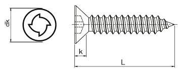

I would say screws. Most importantly mark holes and check 3+ times to make sure they are where you want them. You should be able to find some screws with either a brass finish or nickel (possibly a unique driver shape for interest) to make them pop.
But then you would probably need a $150 screw driver to put them in. :rofl:
I would counter sink them into the plastic base to leave them flush after mounting, but with only 1/8” of thickness to work with, it will take some finesse. If you haven’t done this before, or even very often, make some test holes in something of similar thickness before working on the final product.
If you decide to leave the screws proud and not countersink, find some nice screws and use washers / collars as well to give it a bit more of an industrial feel.
After posting this picture, I really kind of like the look and think it would compliment your display very well….and no need to countersink them.
I like the look of those brass/gold colored screws in that pic. They look nice. They shouldn’t be too hard to find as I have a Menards and Home Depot near me. I wonder if they come in a black color?
There is always this option if you can’t find black ones.
Seems there are a few options for this product.
I think I still have an old bottle of Blacken-It somewhere. I used it long, long ago to blacken some chain for a battleship kit.
But I like @Frozin 's comments about the brass screws as it may compliment the base/display.
