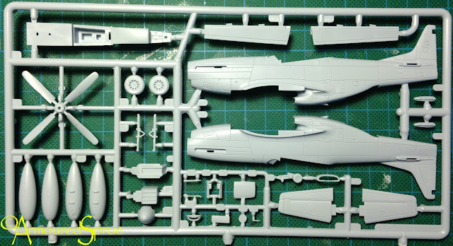

For my next project I have chosen the excellent new tooling Airfix P-51D in 1/72nd scale (A01004).

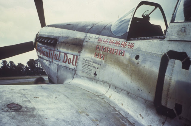

I’ll try to make the personal airplane for Lt.Col. John D. Landers, the P-51D-20-NA, 44-72218, Big Beautiful Doll, , 78 FG, 84 FS which I consider as one of the most colorful Mustangs on WWII.

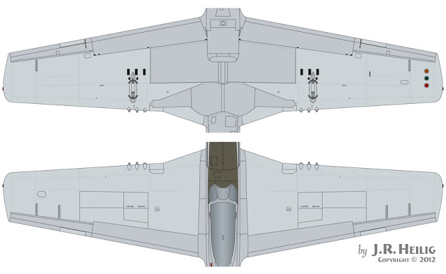

In the photo above we can notice that all panel lines on the upper wings have been carefully filled, smoothed and primed before application of (on natural metal Mustangs) final coats of high speed silver lacquer. Even small flaws on the surface of P-51 wings could cut performance.
Another photo from the book P-51 Mustang in Action (Squadron - Aircraft No. 45) showing the Dallas production line, we can see that the main wing panels are painted in primer, prior to being sprayed silver. All P-51Ds were painted in this manner.
This is a characteristic mostly overlooked in Mustangs scale models and I decided to replicate it.
Firstly I searched for a schematic showing which panels should be filled, after looking on several modelling forums, I came across the below schematic:
The photo below also helps to confirm this schematic, note how smooth is the wing surface.

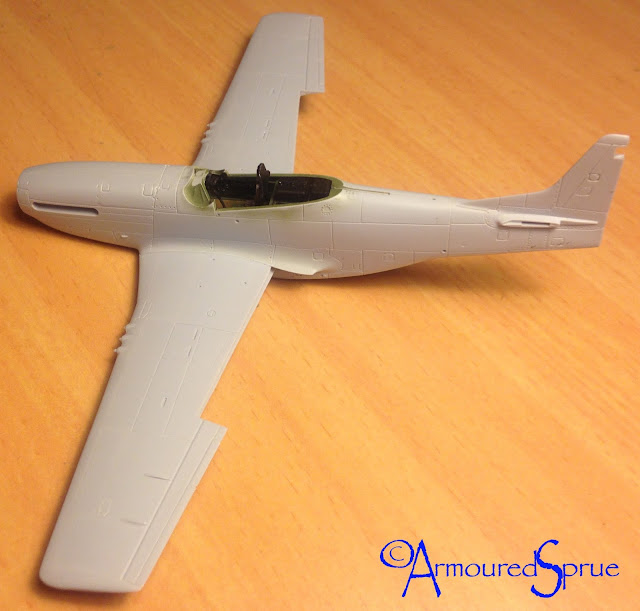

So I started filling the panel lines according to the schematic above.

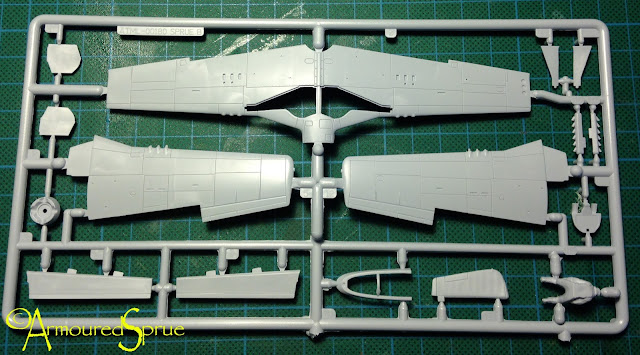

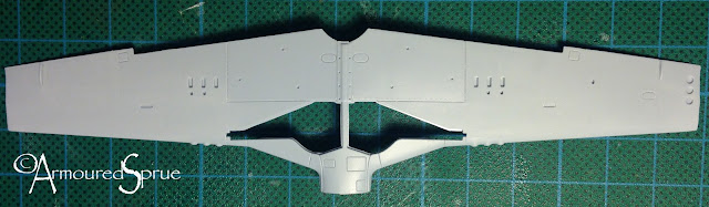

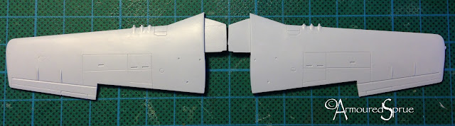

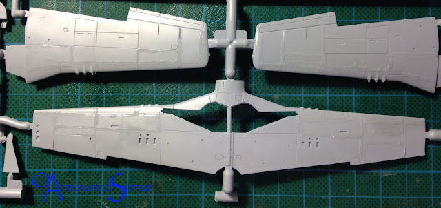

The original kit part with all the panel lines
Panel lines filled using melted sprue
In the photo above you can see the panel lines filled with my own putty recipe, which is just melted plastic sprues. I use Tamyia Extra Thin Glue to melt sprue parts, just cut small pieces of sprue and cover it with Tamiya Extra Thin Glue and let it aside for a couple of days, add more sprue parts or glue until achieving the desired consistency. I apply it to the model using a toothpick and let it dry/cure for at least overnight before sanding with 400/600 and 1200 grit wet sandpaper.
Here the final result after sanding it all flush.

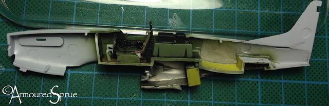

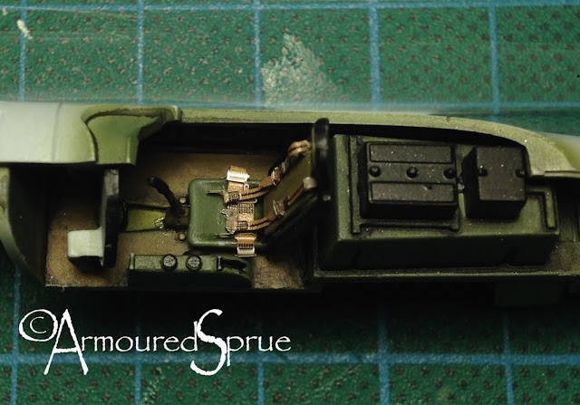

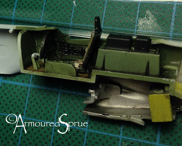

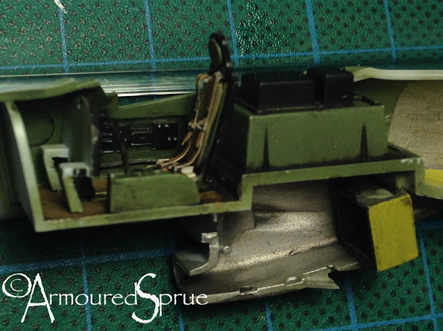

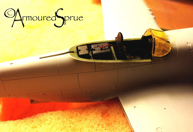

I’ve built the interior. Airfix did a good job and it is well detailed. The panel is a decal but for this scale I think is more than enough.
The fit is just perfect. Everything just click into position.

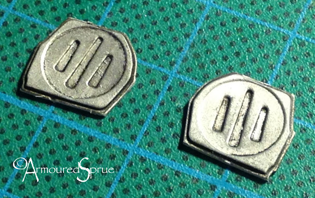

I’ve done the interior of the landing gear covers, I’ve tried to replicate a panel shade difference that is very noticeable in Mustangs, so after painting it gloss silver and weathering it with Tamyia Panel Accent, I mask the panel and applied a flat clear coat. You can see the difference in shade on live, but not in the photo.

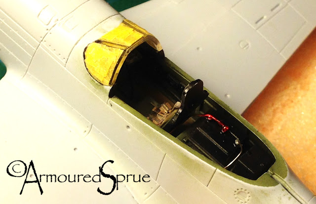

I’ve used an Eduard painted PE set for USAF WWII. It rally adds a lot to the cockpit.
The radio still needs to get wired. The floor is the characteristic timber, in front of the stick control you can see the top of the wings and it is painted Yellow Chrome (Tamiya XF-4) the timber floor is Vallejo old timber.

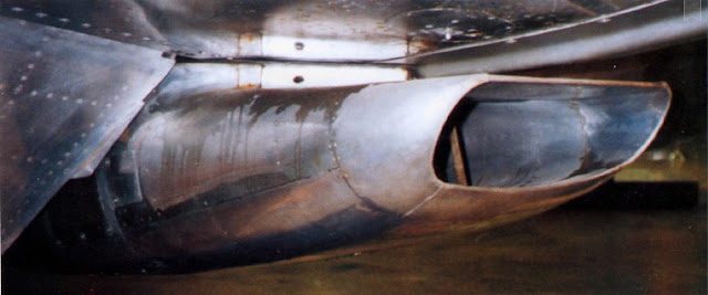

I decided to paint the cooling exhaust area in aluminium since my references pointed this way.
Exhaust air intake. Note the aluminium colour and also the reinforcement bar in the middle.

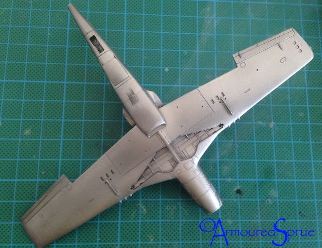

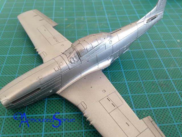

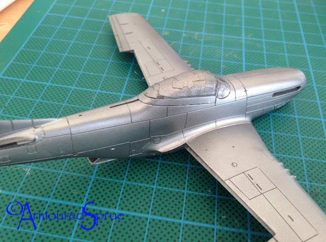

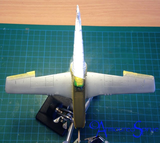

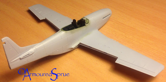

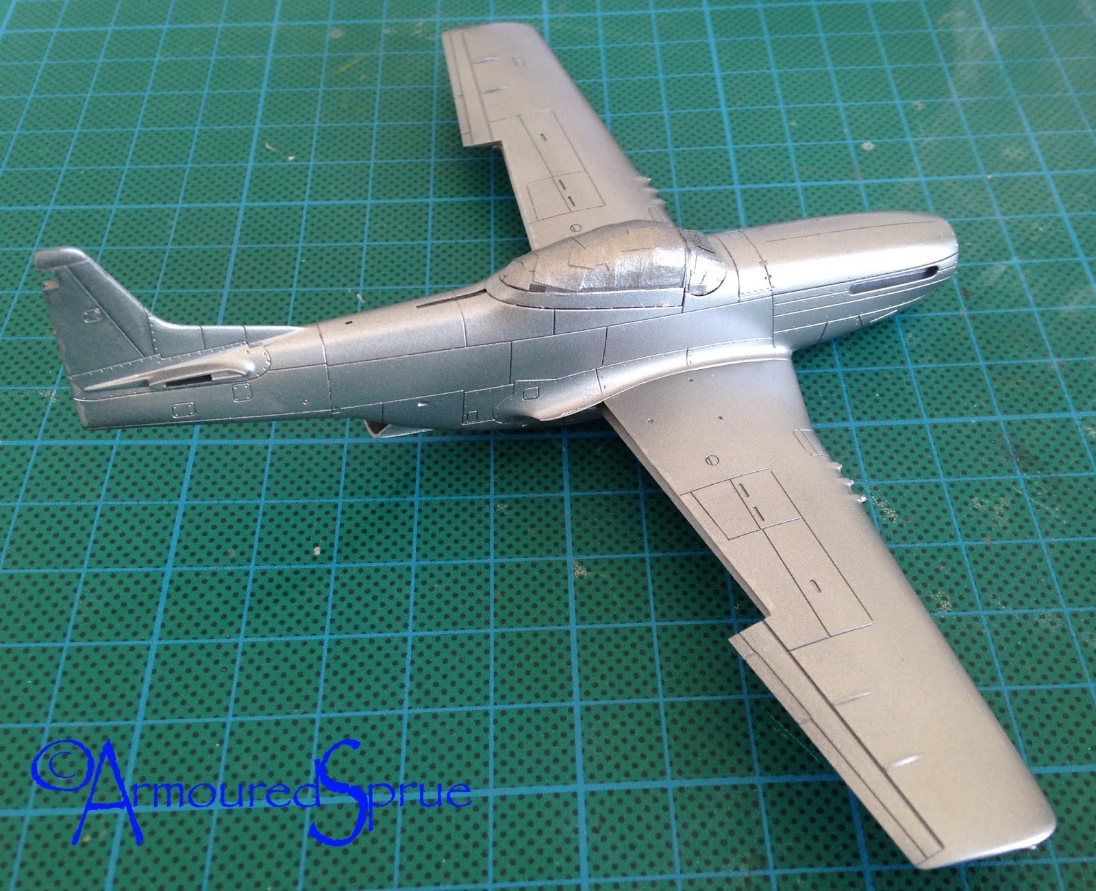

Time to put wings and fuselage together. No dramas here and they fit perfectly requiring almost no putty. I’ve sanded with wet sandpaper grit 600, 800, 1000 and 1200, and than re-done all lost panel lines.

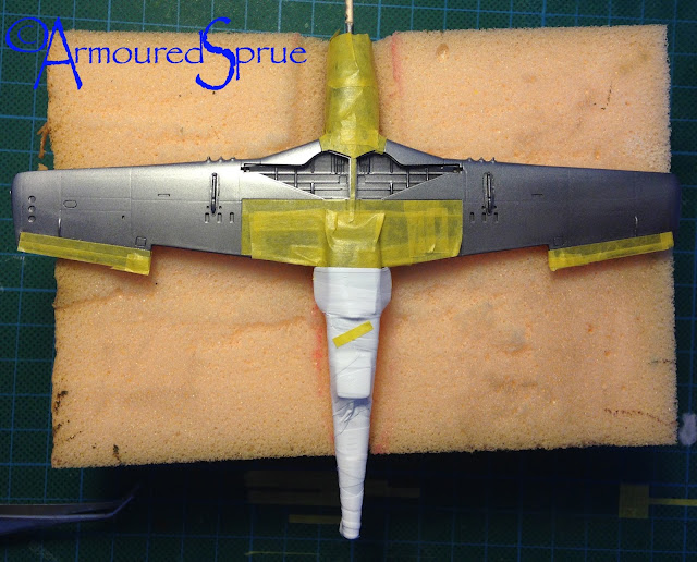

I also mask the canopy and windshield using Tamiya tape.

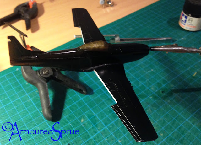

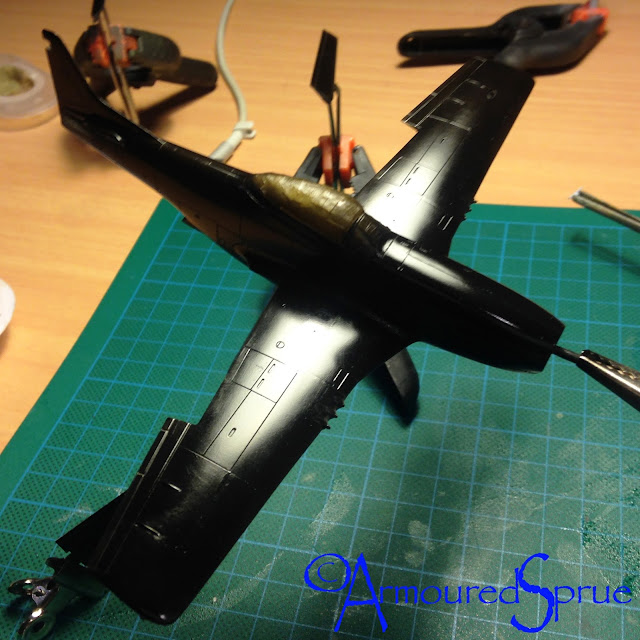

I started by airbrushing a nice, smooth and bright black paint using Tamiya X-1 with a few drops of Future.
Followed by Tamiya Titanium Silver X32.
I’m trying something a little different to achieve a more natural metal finish. So my plan is to use Medium graphite finely ground.
After rubbing the graphite I did apply a coat of Future to protect and prevent any finger print to ruin my model.

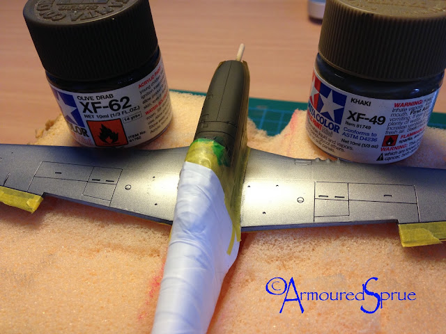

I also airbrushed the anti-glare olive drab, in this case I used 8:XF62+2:XF49 and also mask the areas to paint the wings with the Aluminium Lacquer
The original formula for the aluminium lacquer was a mix of lacquer (or resin) and aluminium powder, so I mixed 1:H8 Gunze Silver + 1:XF53 Tamiya Neutral Grey
When I started to place the decals I’ve noticed that the checkered wing tips decals didn’t have the white so I needed to paint it. The mummy is do I’ve used Plumber Teflon tape to mask the model before airbrushing Tamiya XF-2 White with a few drops of Future.

Paulo that is excellent work on both the model and the presentation. You have photos that I have never seen before. One suggestion I would like to make is for you to look at the period fuselage panel lines and compare the to your model. Is this what you want?
Hi mate
I haven’t done any post shading in this model, the panel lines are more definided because this kits (as most of the Airfix ones) has a huge gap between the panel lines, so for this matter I’m happy with I have achieved.

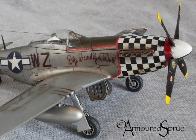

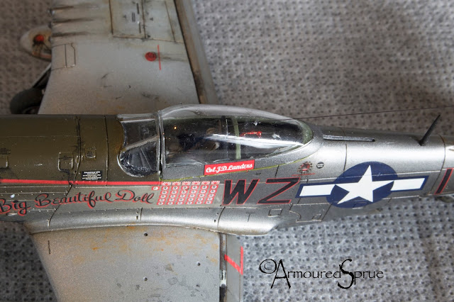

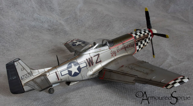

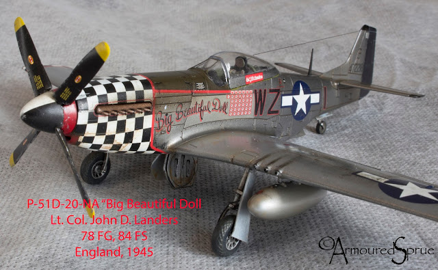

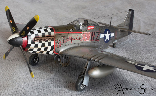

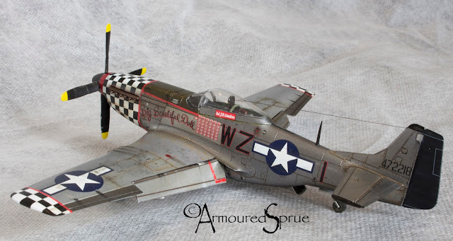

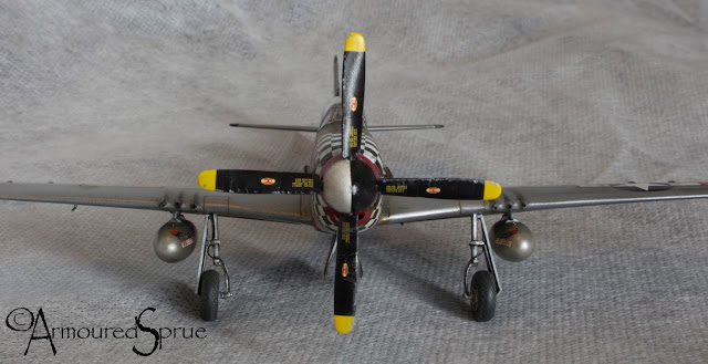

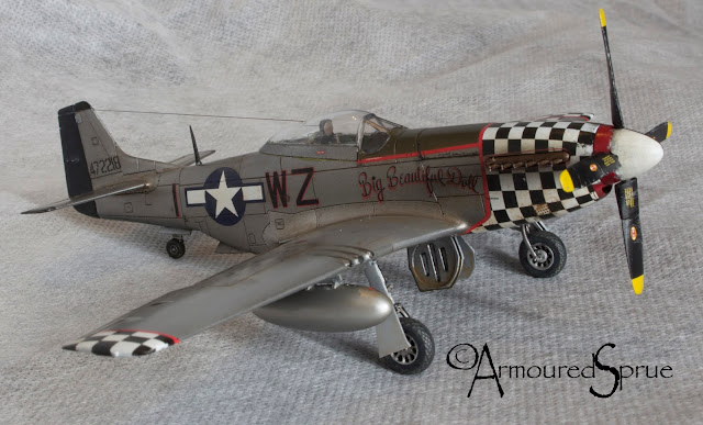

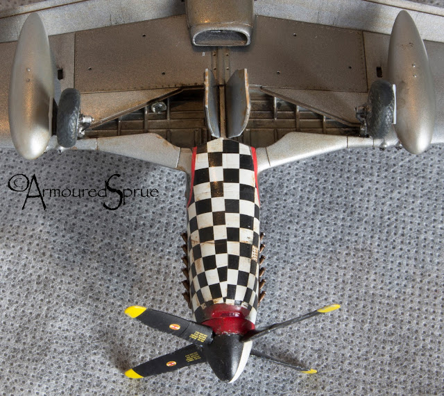

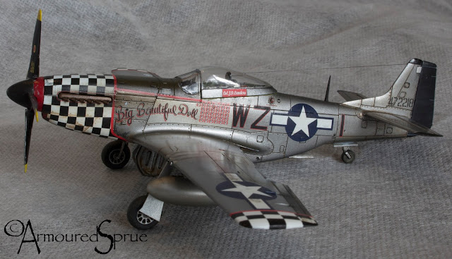

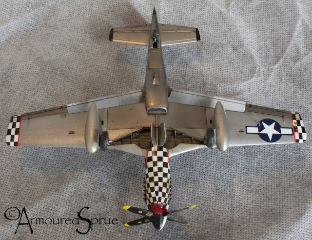

Here are the finished model photos, hope you like and I’m glad to hear your comments and critics.
Kit: Airfix A01004 1/72, Decal by Eagle Cal

Wow, she turned out beautiful!!! I tried puttying the wing panel lines like that a few years ago but didn’t really like the results, I wish mine had turned out as well as yours. [Y]
Hard to believe thats 1/72nd scale. That is stunning. Thanks for sharing your work with us.
Stunning! Very beautifully done.
What q beautiful build
geat job
rick
When I can’t tell that it’s not 1/72, I know I’m looking at a VERY well done build.
VERY well done!! :smiley:
Thanks all for your comments. This kit was a pleasure to build and I’m a big fan of Airfix new tooling releases. This model for example, is head to head with the Tamiya, but is way cheaper and comes with the option to make drop or normal flaps, this only is a game changer. Fit and details are very good. The only thing I would pick on is the large panel lines, if they were a little less wide and deep would be perfect.
Cheers
Paulo
Stunning, yes !! Very nice work and the weathering is fantastic. Great work.
BK
Thanks mate
Stunning work indeed, specially in a smaller scale. The puttied wings on NMF Mustangs are often overlooked by modellers. Well done sir. [B]
Thanks!
