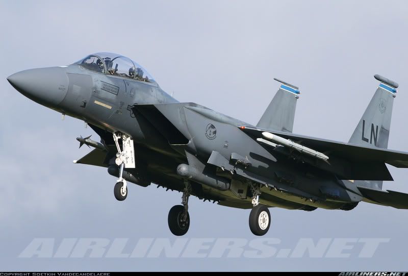

However, I was just trying to learn how I can make those subtle weathering effects that all vehicles and aircraft experience, carrier-based or not. There will be a paint splotch here or there, and maybe some wear around panels that get removed for maintenance a lot. I think Matt has a fine representation.

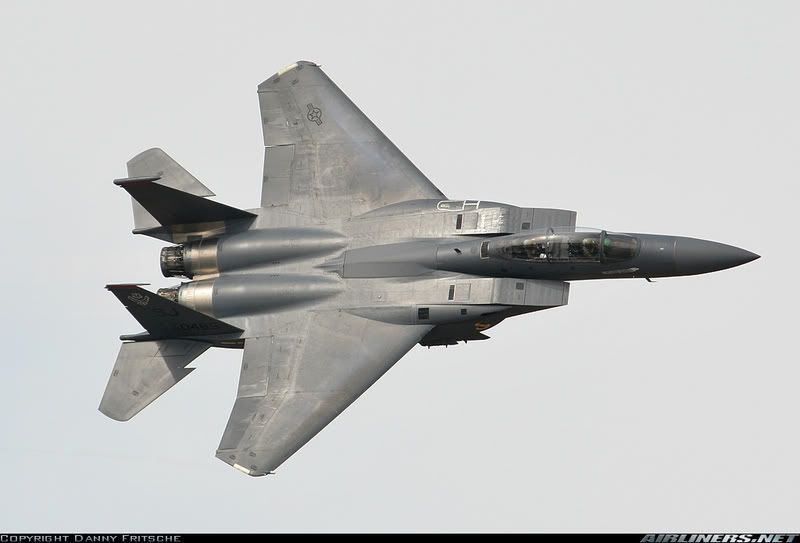

In terms of painting in ‘scale’, due to lighting and its reduced size, painting a whole aircraft with a rattle-can of gunship gray may be what’s called for technically, but it doesn’t necessarilly look realistic. Even with a ‘clean’ bird like the Strike Eagle, I feel in my own opinion like I at least need to add some shading and subtle wear to make it less toy-like.
I found a couple pictures to try and show how even a mono-color aircraft has paint and wear variations:
Copyrights to airliners.net and the appropriate photographer
