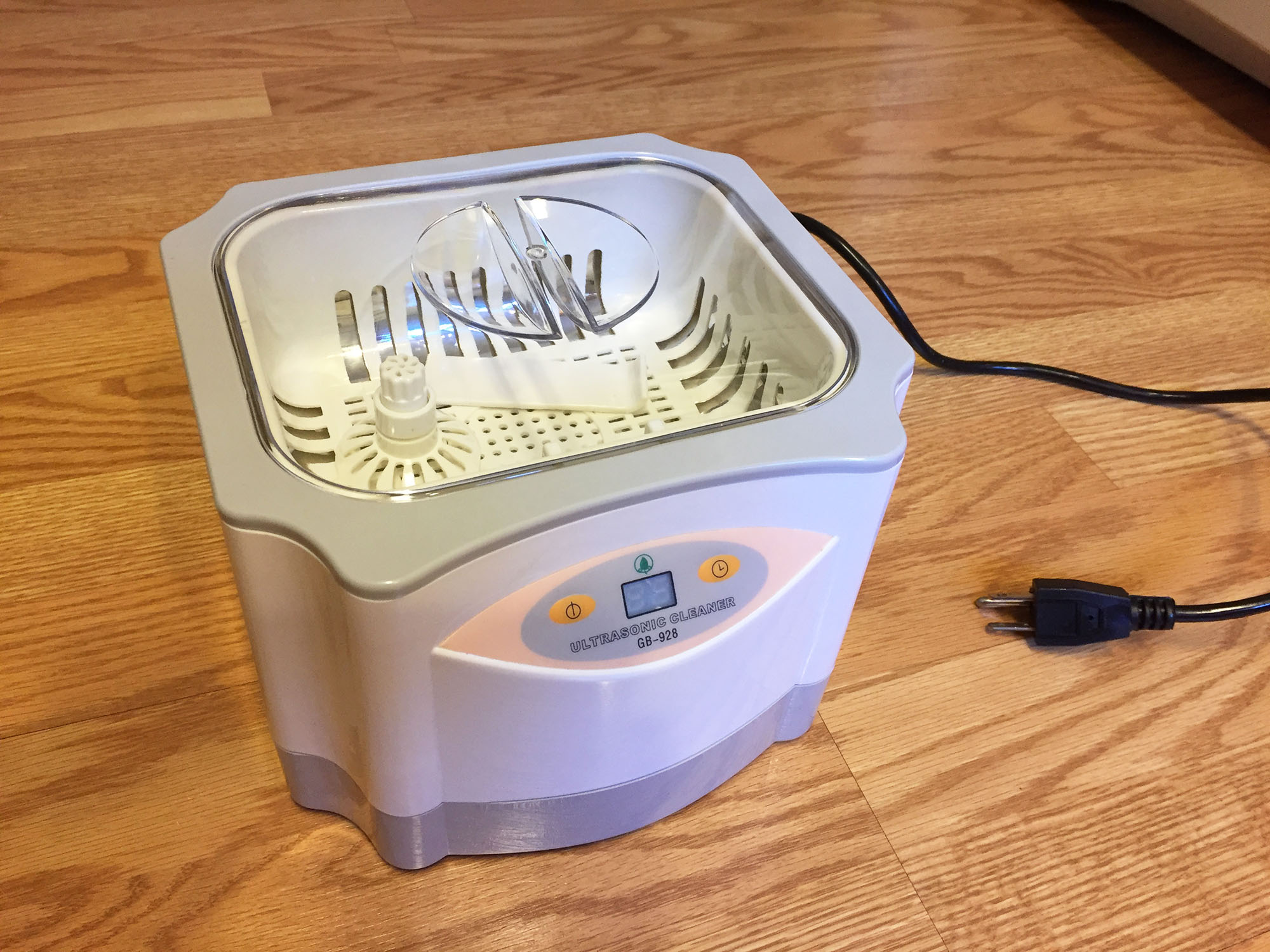

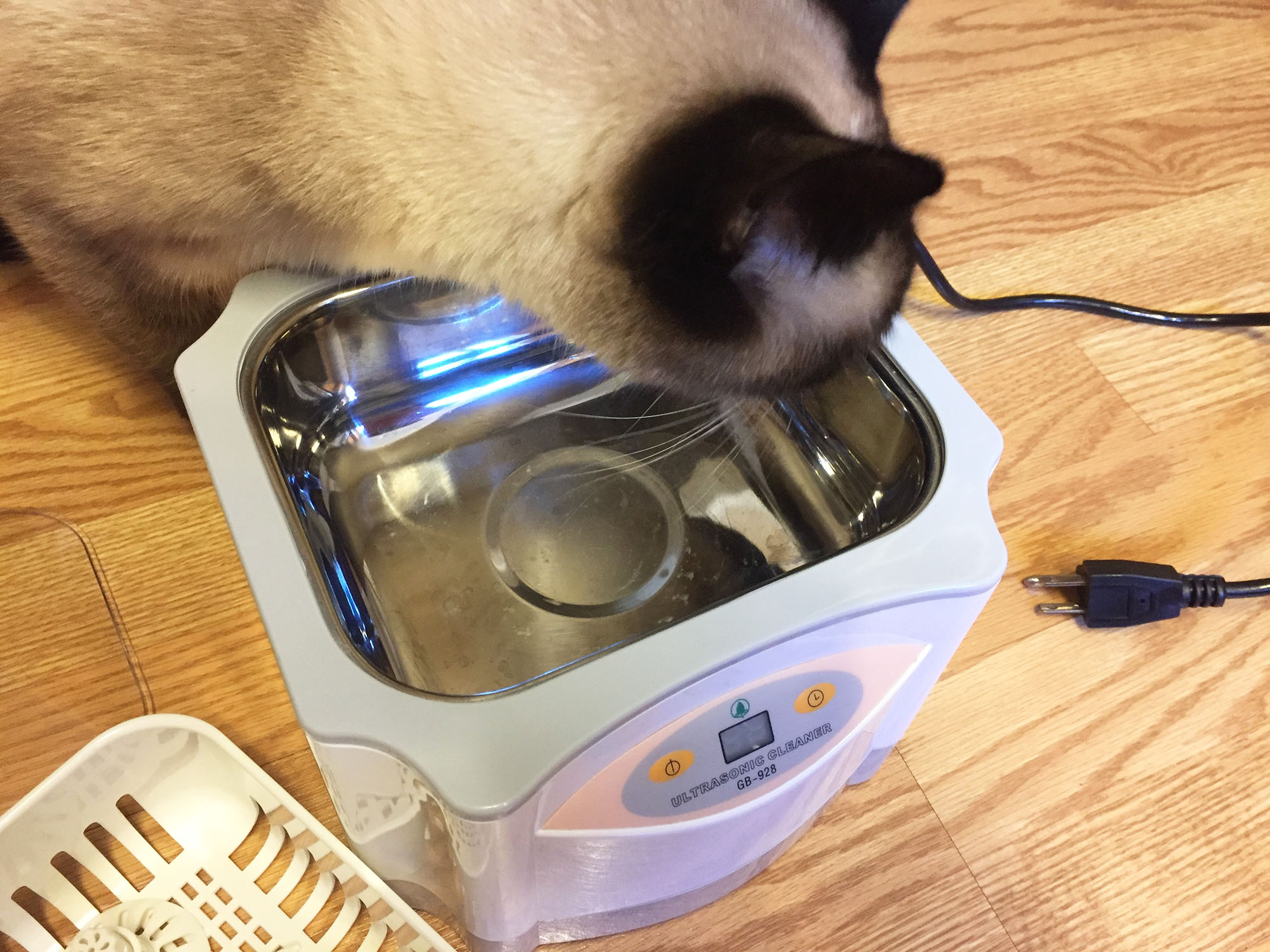

I have been using this no-brand cleaner, that I got new from eBay for around $40, for anything imaginable: parts, jewelry, moldy razor handles, you name it… Never failed me. If you decide to get one, make sure it has a stainless steel reservoir.
Cleaner
Cleaner
(Cat for scale)
